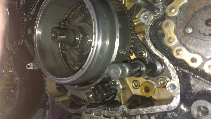

    To reset pickups to stock position you put horizontal cylinder in to TDC and marks on the flywheel should align. The lump on flywheel is about 4 o'clock just before 1st (horizontal) pickup is that correct? If it is no markings on any of my flywheels align with pickups (centre of it).
    Air gap on pickups should be about 0.7mm. Is it measured to the notch of flywheel or flywheel? Is it measured from the notch on pickups or from flat part?
    Finally will the Ohm read from pickups change if air gap is to big or to small? I get 100 Ohms.

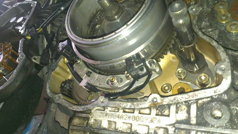

  2. Picture of flywheel at front cylinder tdc as per screw driver approach and belts timing marks. [​IMG]
  3. It might not be visible but on 3rd picture there is a dot just in front of flywheel notch. Or what sequence should it be with engine running if you look with engine rotation there is notch then double dot, single dot, double, and single, single, single and notch again
