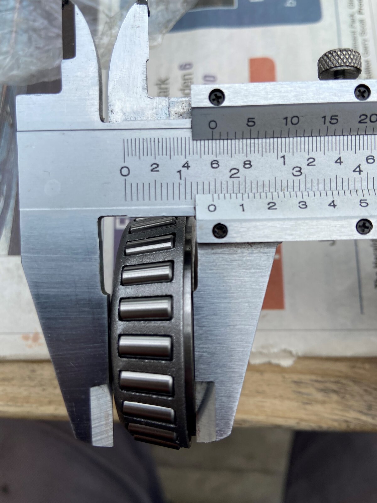

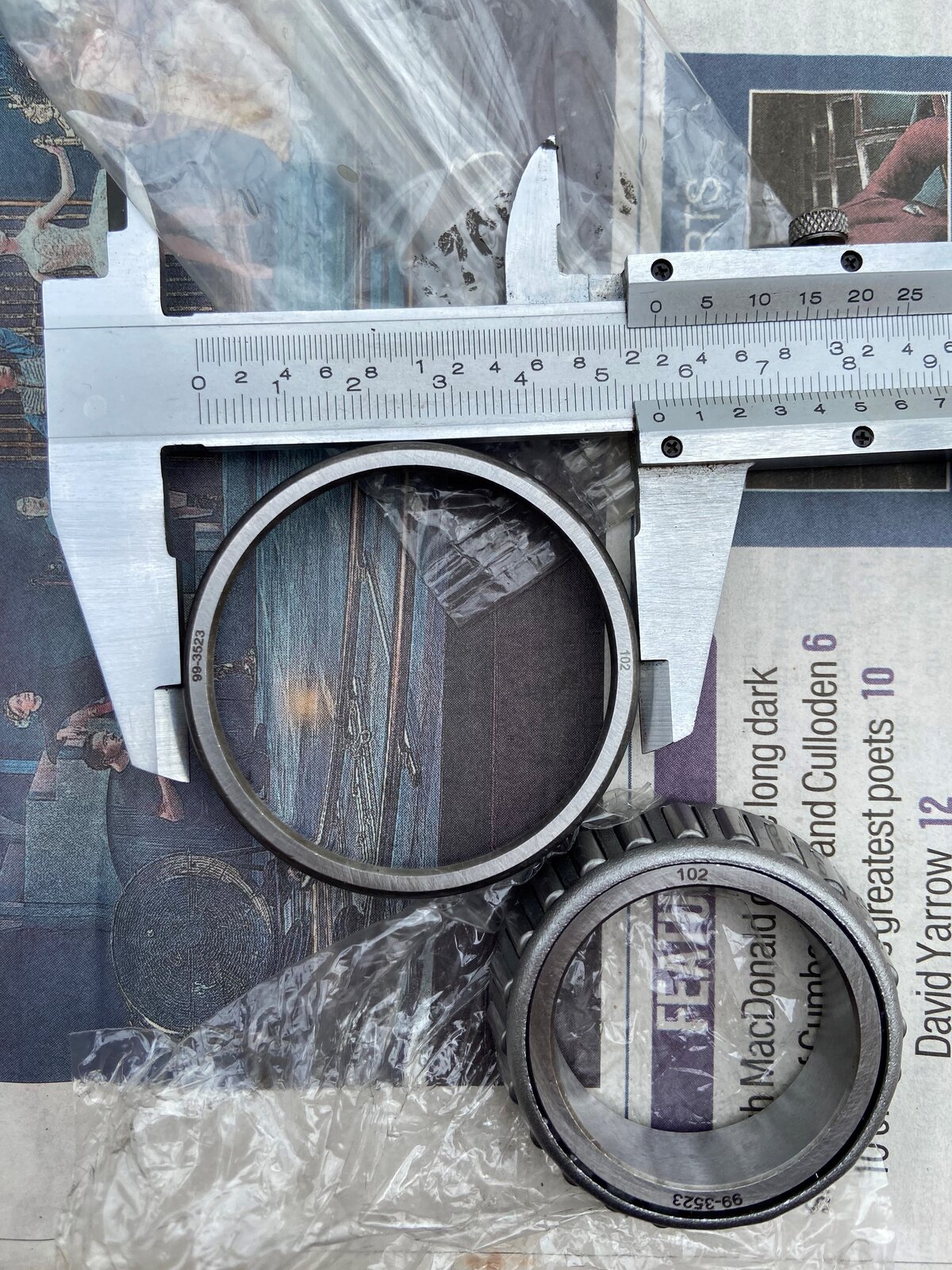

  1. I'm putting this one up for information. I have replaced the head bearings with taper rollers. I have been getting my bearings from Marksman Industrial from as long as I can remember and more recently they are doing these as a kit where in the old days you would have to know the size or number you can now find them by motorcycle categories..
    £36 gets you these wee beauties below including two rubber sealed dirt covers.
    Sizes OD 55mm ID 35mm H14mm (Photo shows 14.5 but that is on the cage) Head 1.jpg Head 2.jpg Head 3.jpg Head 1.jpg Head 2.jpg Head 3.jpg
