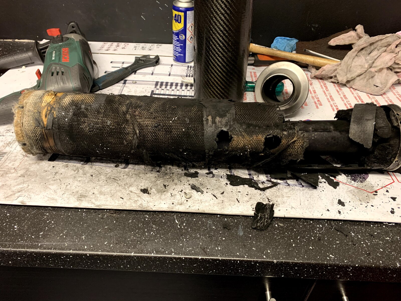

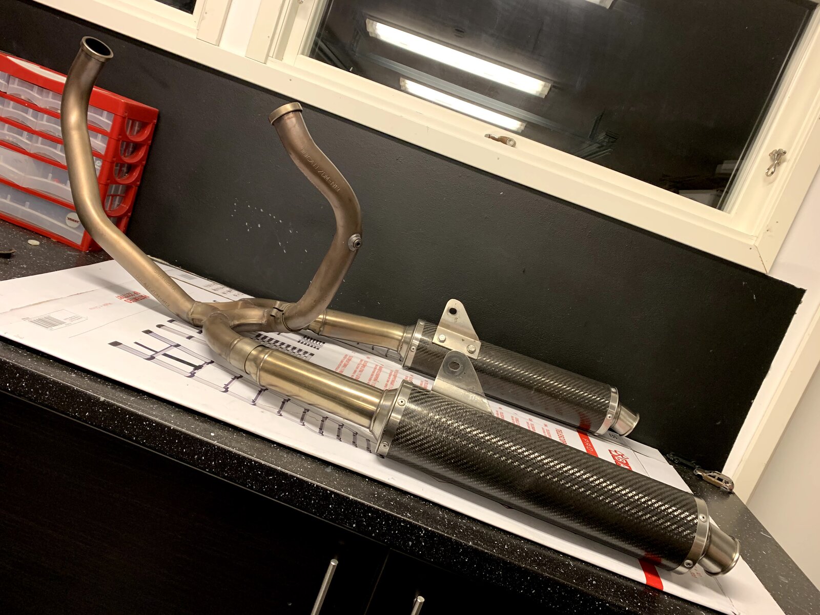

    First on my list was the exhaust rebuild as the bike idle was so loud just after a few minutes your ears would be ringing. It was never going to pass the Swedish MOT with it spitting so many decibels out. After stripping the cannisters I could see why...
    Below: It looked in good condition before the rebuild with a little tarnish on the headers (which actually looks cool) but very good for the age.
    Below: So this was was it was so loud. The old wadding so so hard and broken near the front of the cannisters. Pretty much a straight through.

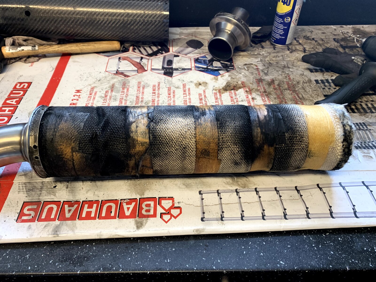

    Below: The opposite cannister was not as badly burned but still with rot and little to no sound absorption left, after 20years of use I guess.

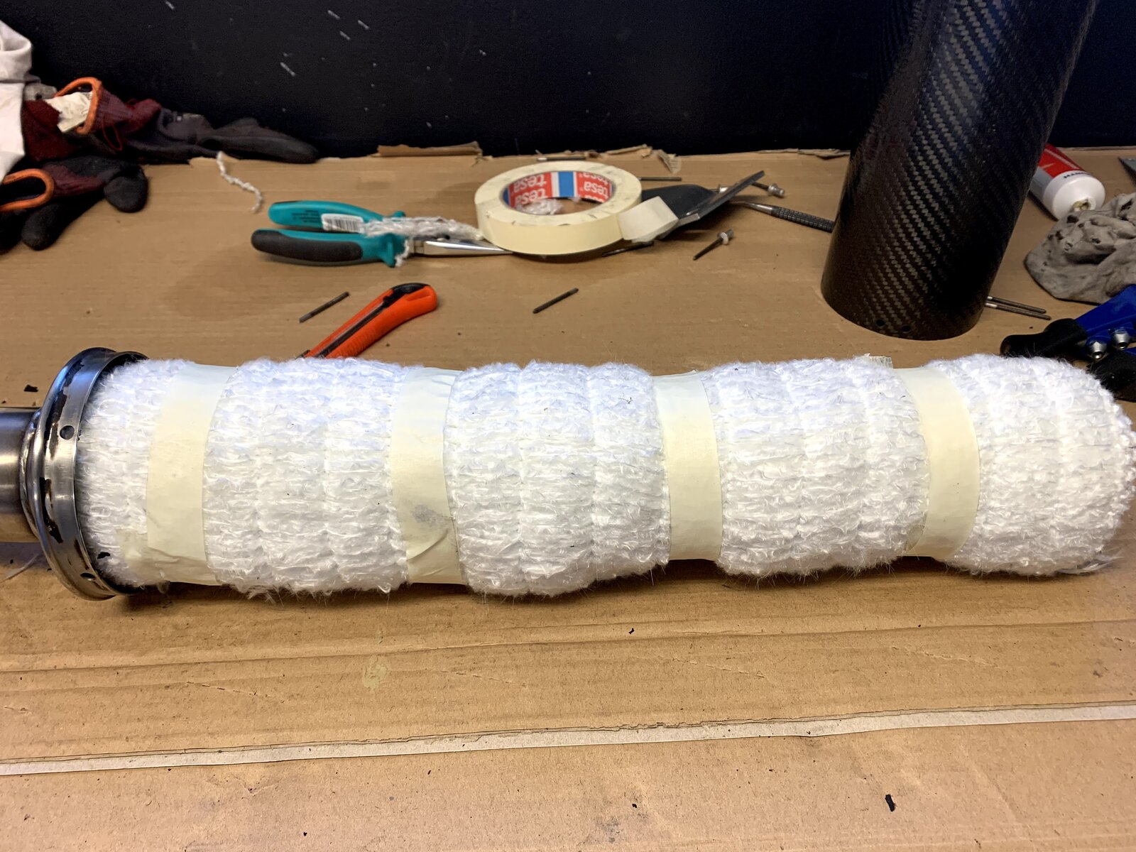

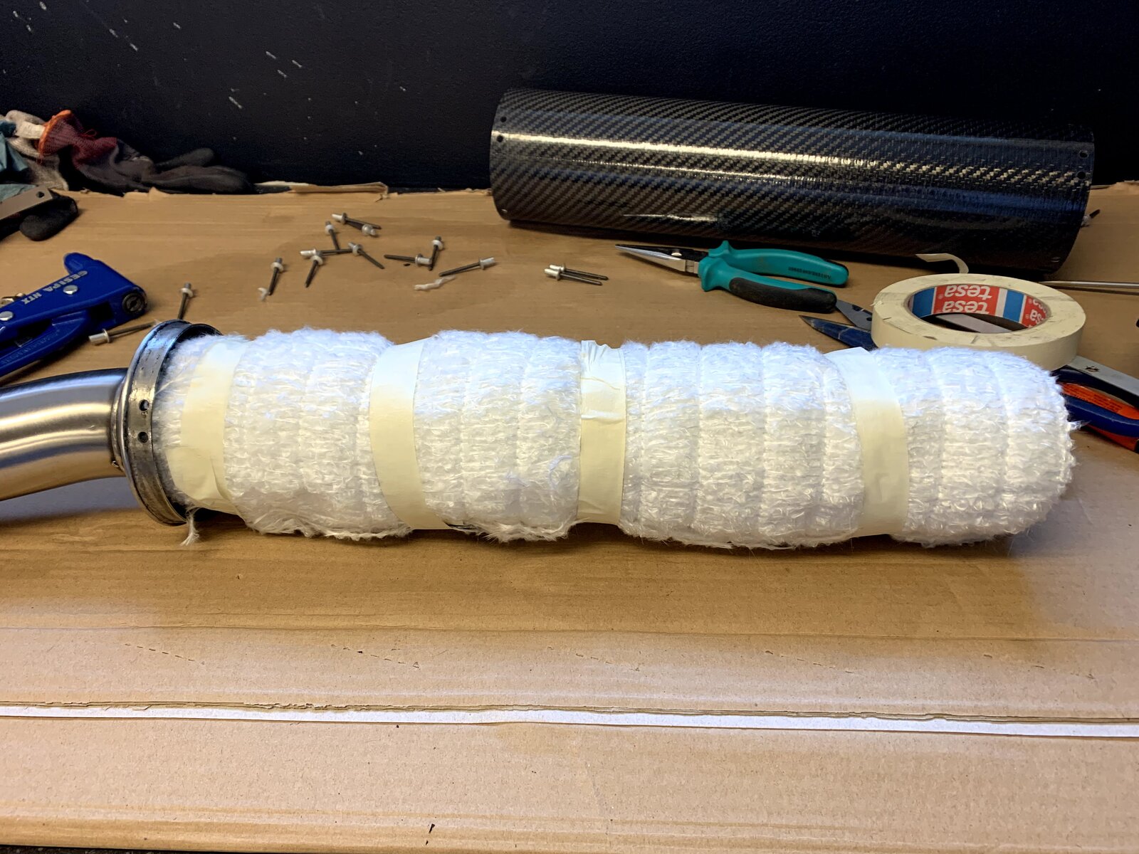

    Below: New wadding wrapped and ready for installation.

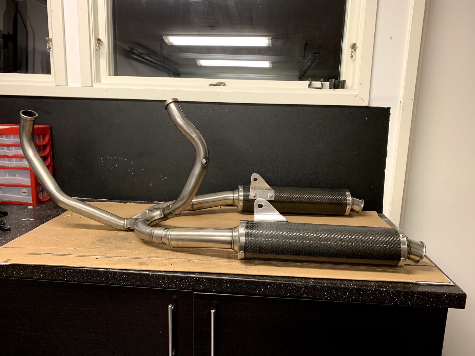

    Below: Headers all cleaned up, cannisters assembled, sealed, pop riveted and ready for installation...next year :)

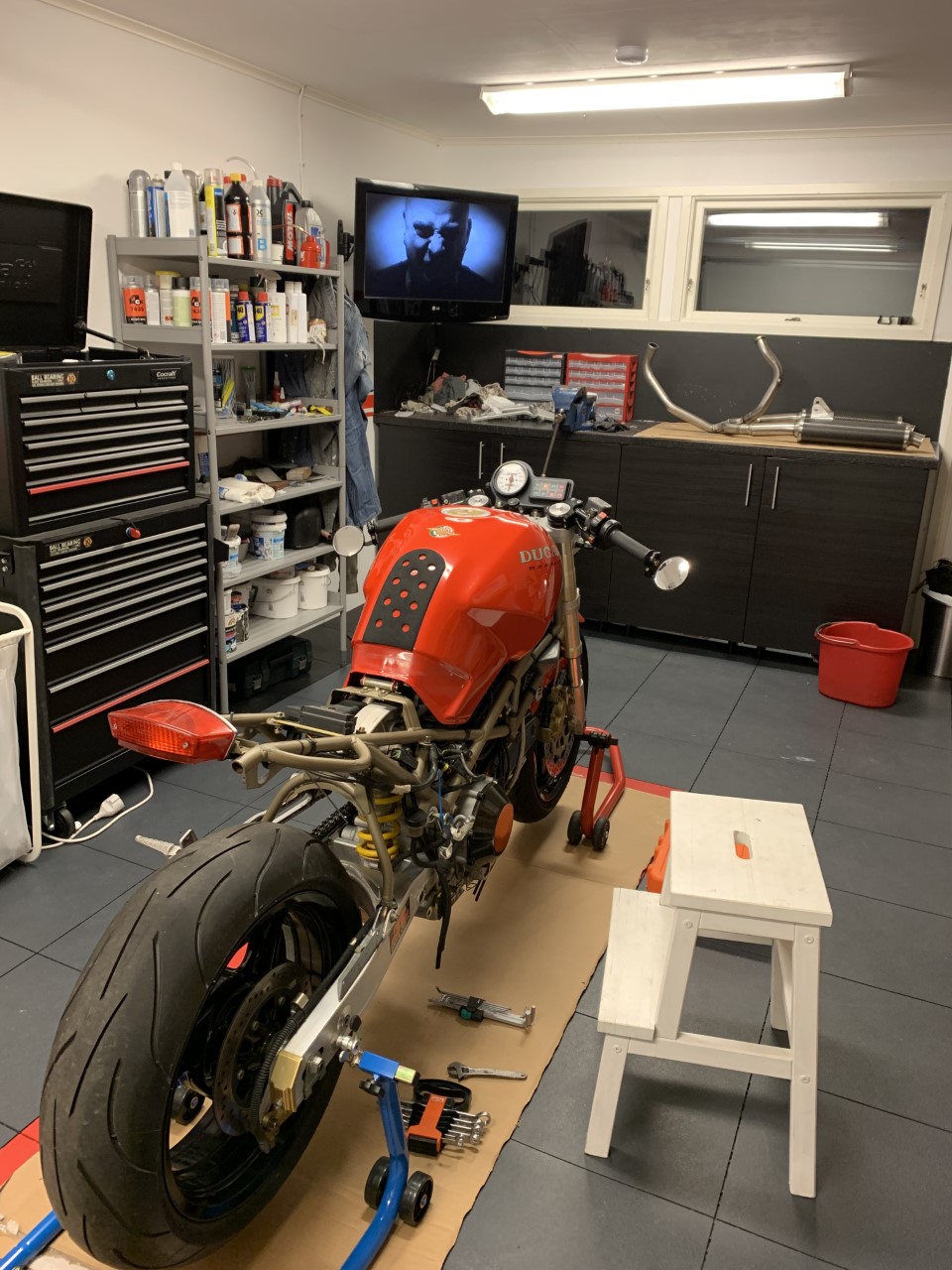

  2. Nice workshop :upyeah:
    • Agree Agree x 4
  3. Thanks @final_edition it makes those cold winter evenings more enjoyable
  4. And in Sweden the evenings are usually cold -especially when the sea is frozen solid...
  5. Unfortunately the winters are more like Autumn these days.
    Doesn't hurt to have a warm comfy workshop to work in and watch WSBK, BSB and MotoGP while wrenching though.

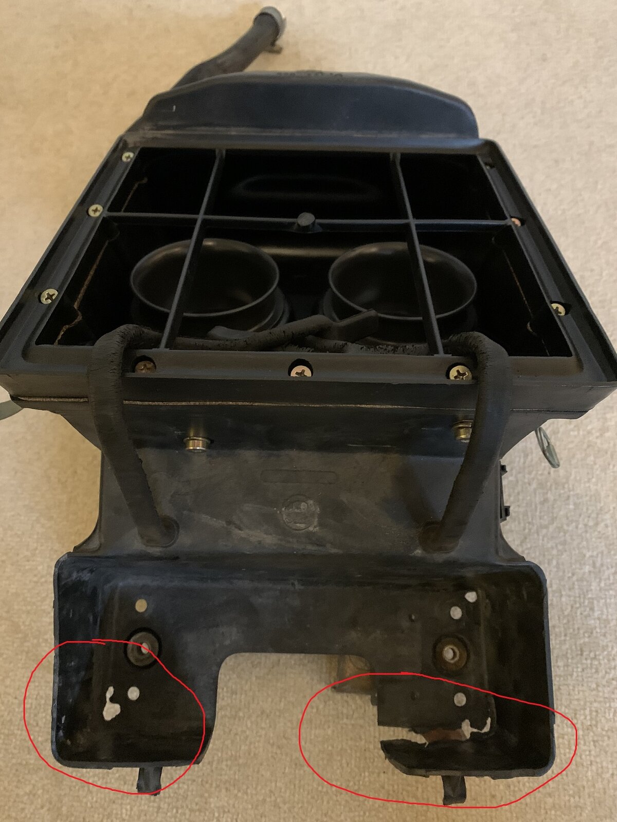

  8. Hey Guys,
    So I am starting to take stock of what I require for the project. At the moment I am looking for a battery tray/lower airbox panel. Mine was obviously damaged at some stage by a leaking battery.
    Please drop me a message and let me know what you have laying around?
    Thanks :)
