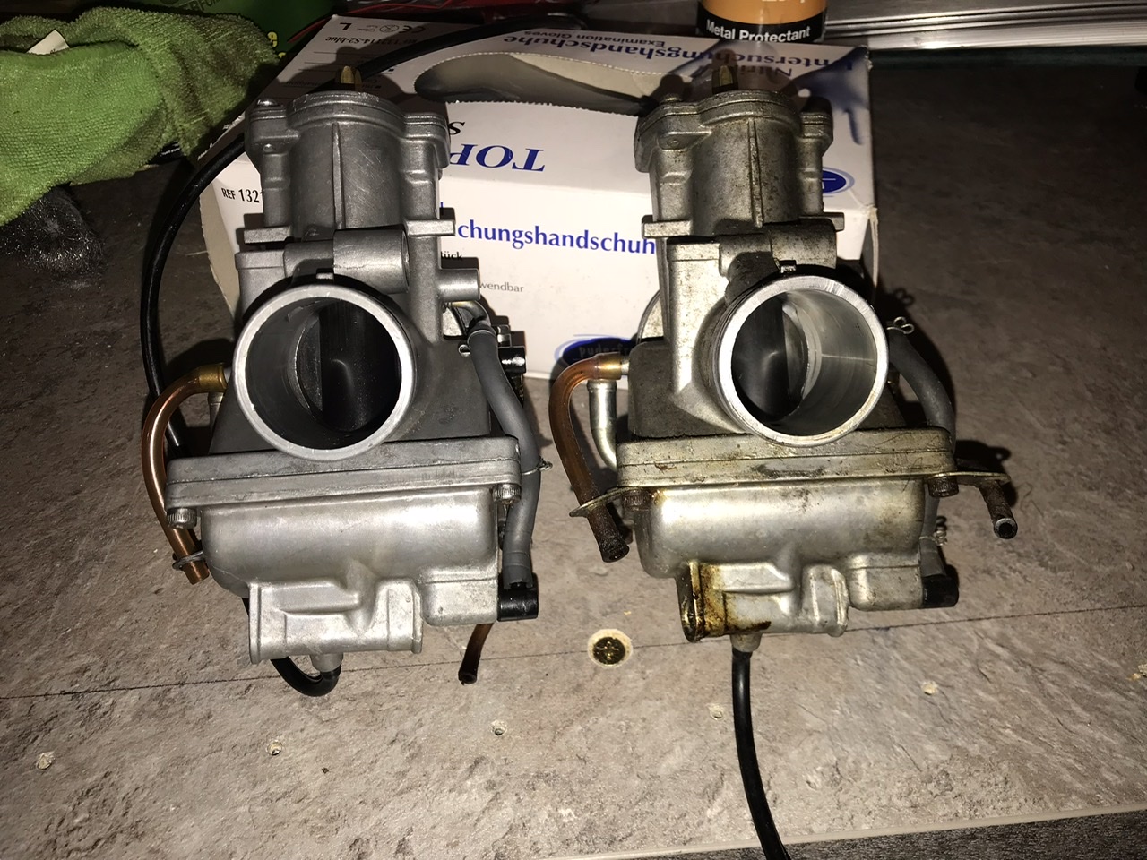

  9. Perhaps not the best photo, but the left carb has been cleaned up with Alubright and the right is at they both came off my ‘89 RGV. All of the brown stuff isn’t oil but fuel varnish (and sadly for me every jet, crevice and aperture inside was much, much worse!).
