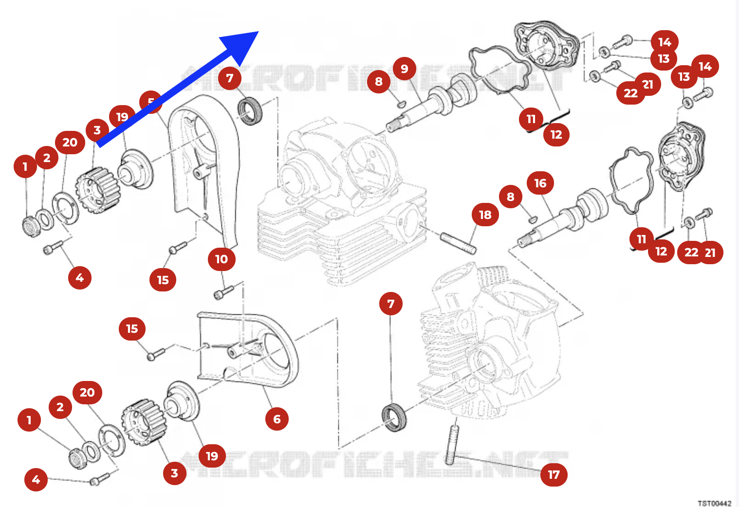

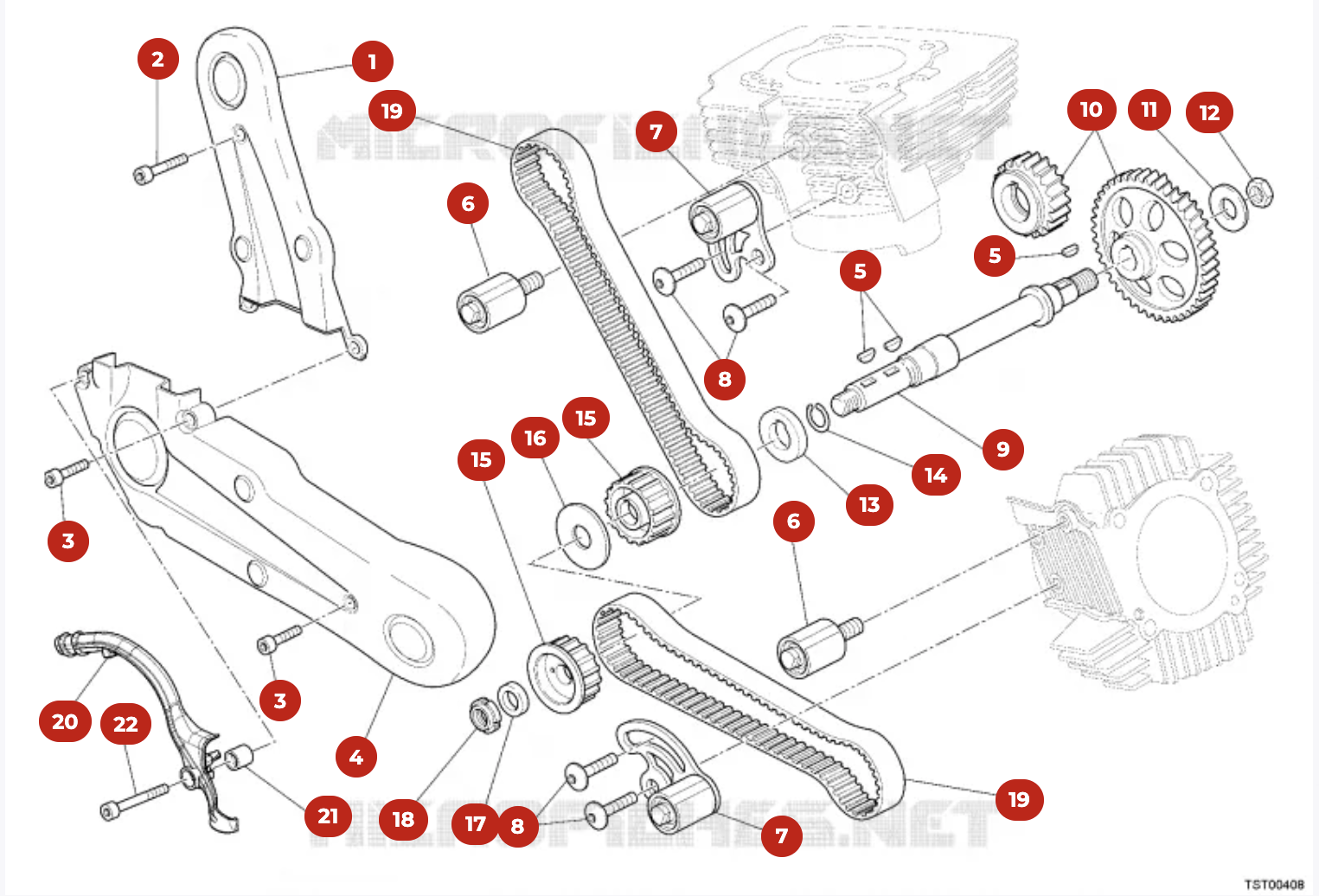

  1. IMG_4913.jpg Screenshot 2026-02-06 at 21.12.17.png Screenshot 2026-02-06 at 21.15.29.png I’m in the middle of doing the belts on my 2011 Monster 696 and I’ve hit an annoying issue with the plastic timing belt covers.
    The horizontal cover is held on by two hex bolts (Part No. 3 in the diagram) that screw into those brass threaded inserts melted into the plastic housing.

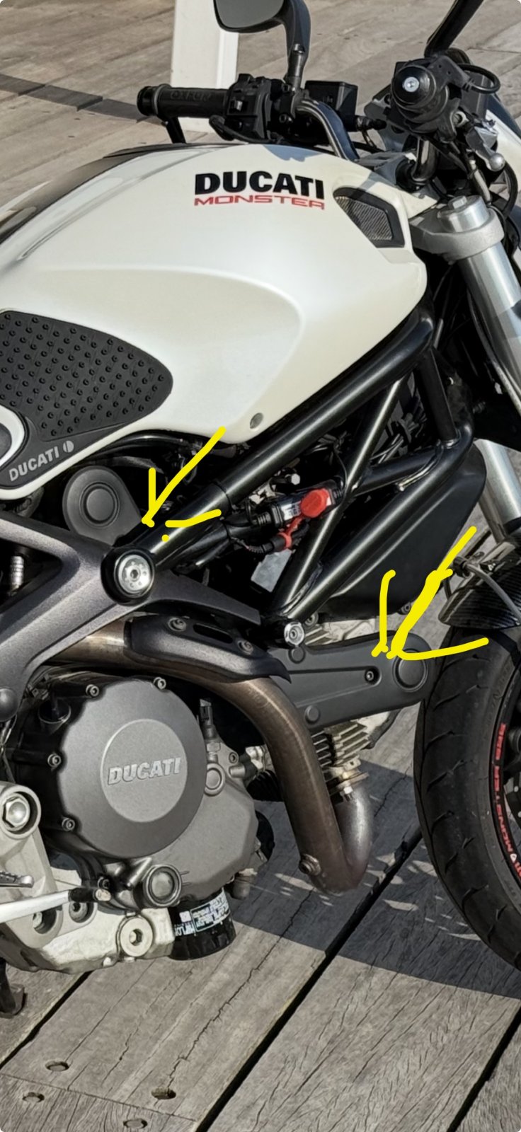

    The troublesome bolt:
    • sits directly behind the upper trellis frame tube (just behind where the upper left yellow arrow points)
    • only allows a short Allen key in there
    • no room for a driver/ratchet
    • can’t put it in a drill to spin it fast enough to heat the insert
    • and even if I did melt it out, there’s no space to get a soldering iron or insert tool in to fit a replacement
    So I’m basically stuck with a spinning insert and zero access.
