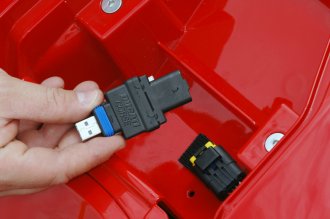

  1. I bought a bike mag the other day that features the 1098 on the cover.
    In the write up it says the 1098 came with a USB data logging stick as an £150 option, the S model has it as standard. Where would I find it if my bike has one?

  3. Its under the rear seat, towards the front. It looks like a big chunk of plastic, held into place by a rubber band. The toolkits sits on top of it
  4. Thanks guys, i dont have one :frown:. I checked under the seat last night and only have the yellow plug. How much are they and are they simple to use? I am a little confused as i remember a post saying you needed to purchase a lead from ebay to connect the bike to a pc. Is that instead of the usb plug? I dont have the toolkit either or the rear seat and footpegs which the dealer promised me.

  5. The port will be there, you just need the stick to plug it into. They go for about £70-100 on ebay and are a doddle to use

  7. The DDA came in it's own box. It doesn't need a lead though. One end plugs into the bike and the other is a stock USB. You can use an extension lead if it makes hooking up to PC easier. Like you said, standard on the S and R and an option on the base model.
