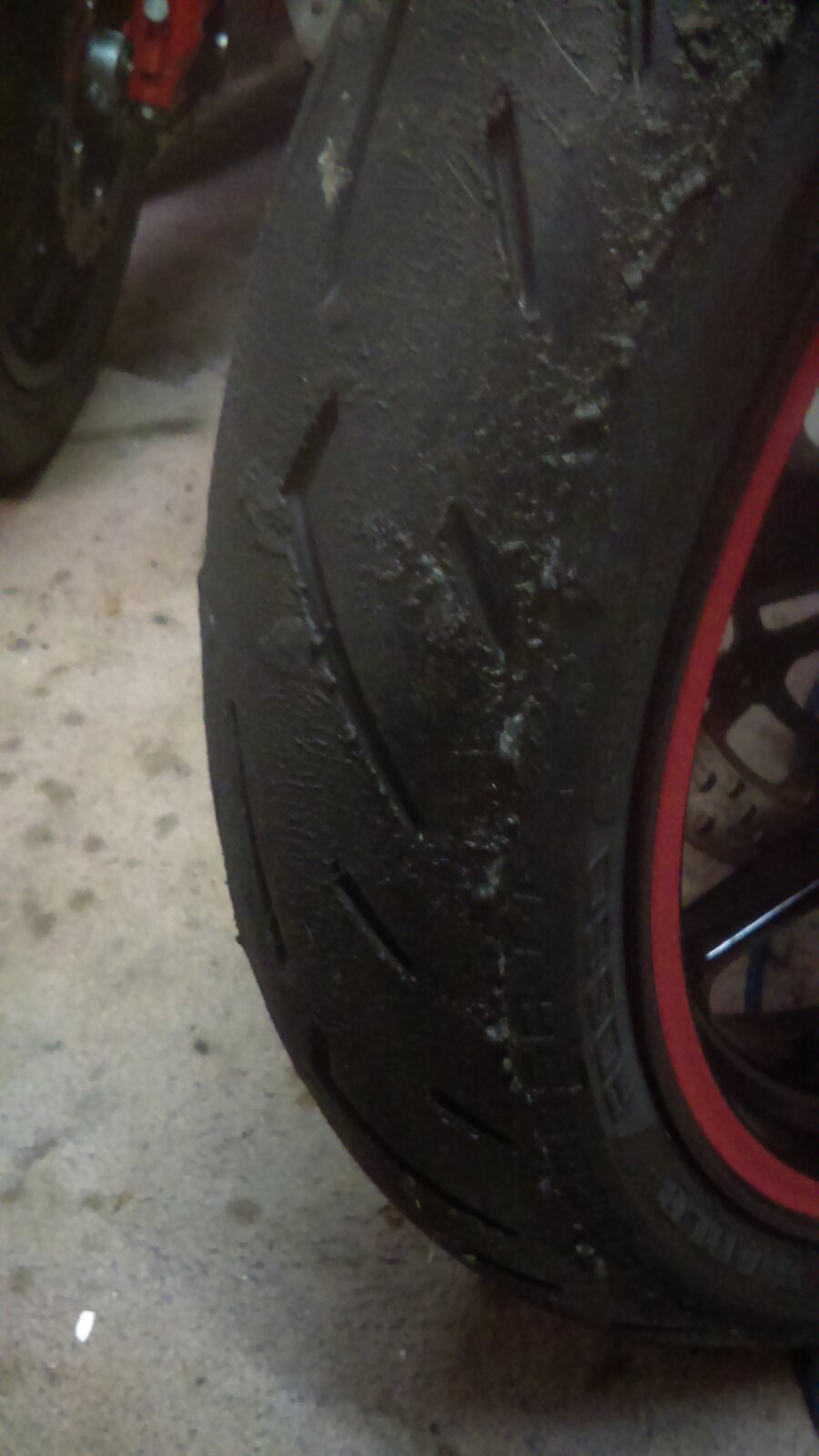

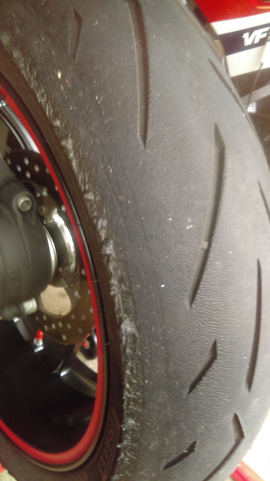

  10. I'm no slouch. Club champion and 3rd in national championship. See pic of tyres after Spa attached. But I can try cornering faster. Don't want to throw it down the road again :blush:. Would like to make bike faster if I can. Do not have race ECU. Can the standard ECU be remapped?
