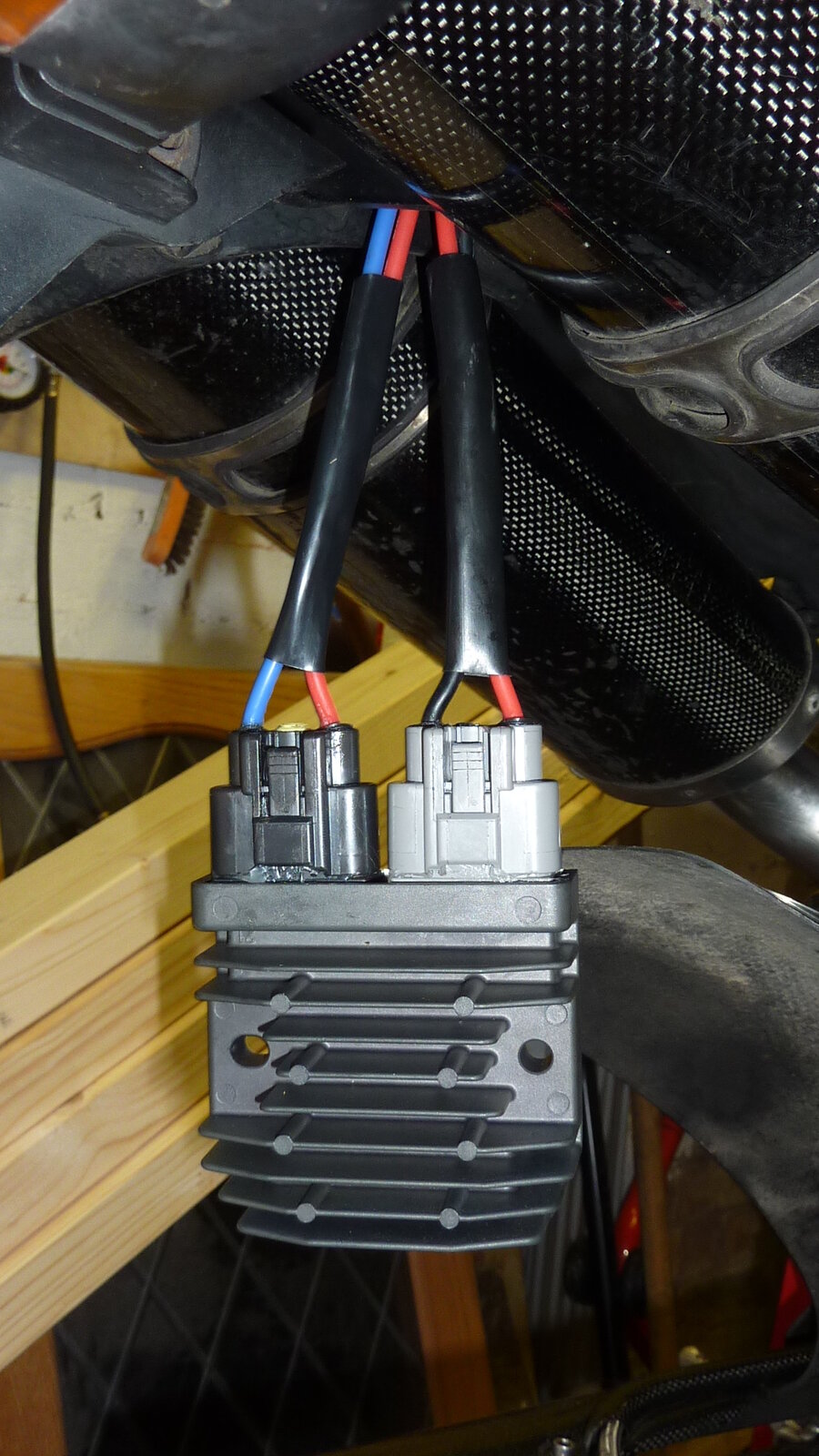

  7. I have had the 3 phase shindengen mosfet r/r on my single phase 748 for about 7 years, trouble free.
    Steve

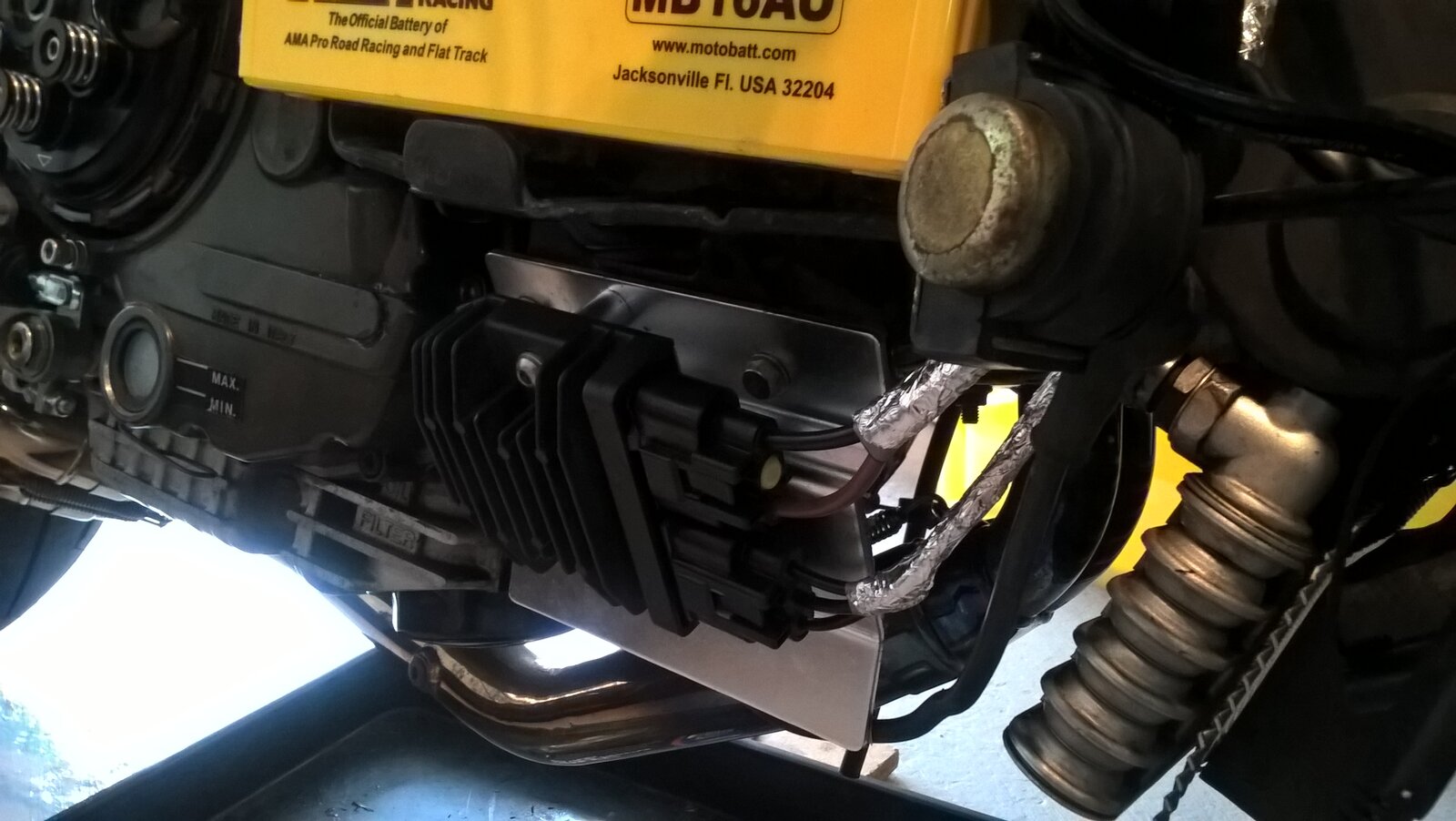

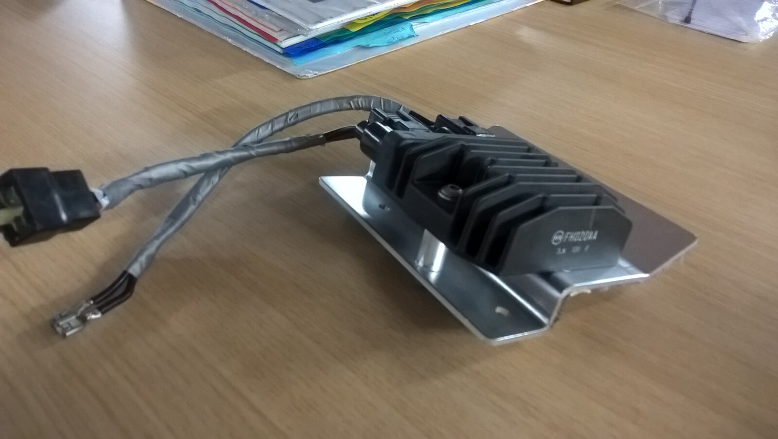

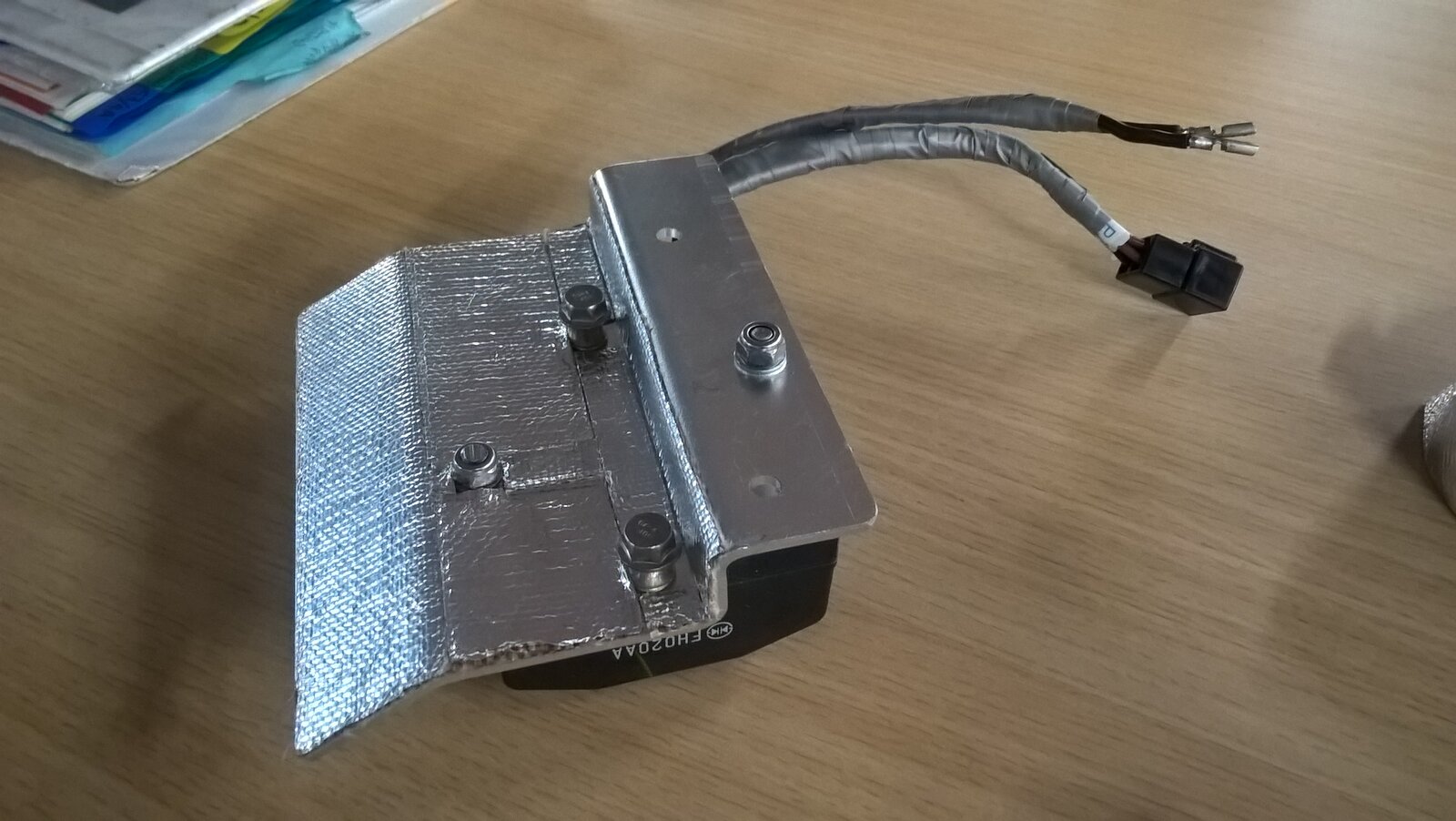

  11. well that's the r/r installed. Very stable 14.5v at 3000 revs. Mounted on the oem plate with additional Fibreglass tape on the back and heatshielded wiring. Unbelievable how cool the mosfet r/r runs. Haven't had any need to put the battery on charge yet, worthwhile upgrade.
  12. I have the same thing with great results on my Monster.
  13. Nice work! One thing I noticed when I did mine was the cables were pushing against the lower air vents on the fairing. If the older panels have the lower air vents in the same place, it might be worthwhile shifting the reg back, closer to the clutch housing.
  14. I still have the option to move it back another inch, as you say, can push against the fairing vent, but just manages to fit, I set it a little further back
