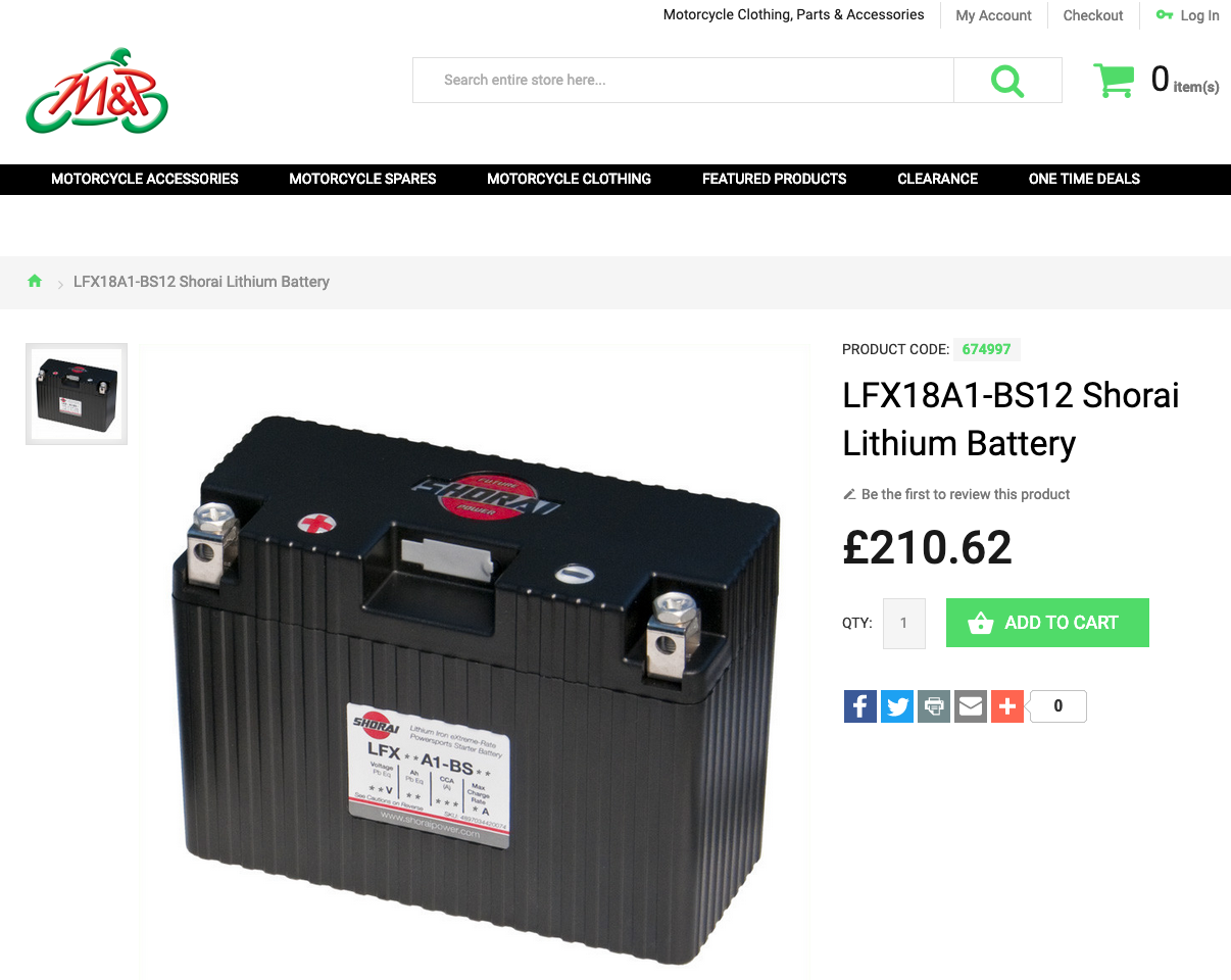

  4. Shorai LFX18A1-BS12
    I've never had a pick of bother and I'm not a natural worrier, but some people have had issues. So I'm thinking, why not. It was put on when I had a lot of starting issues after I bought the bike.

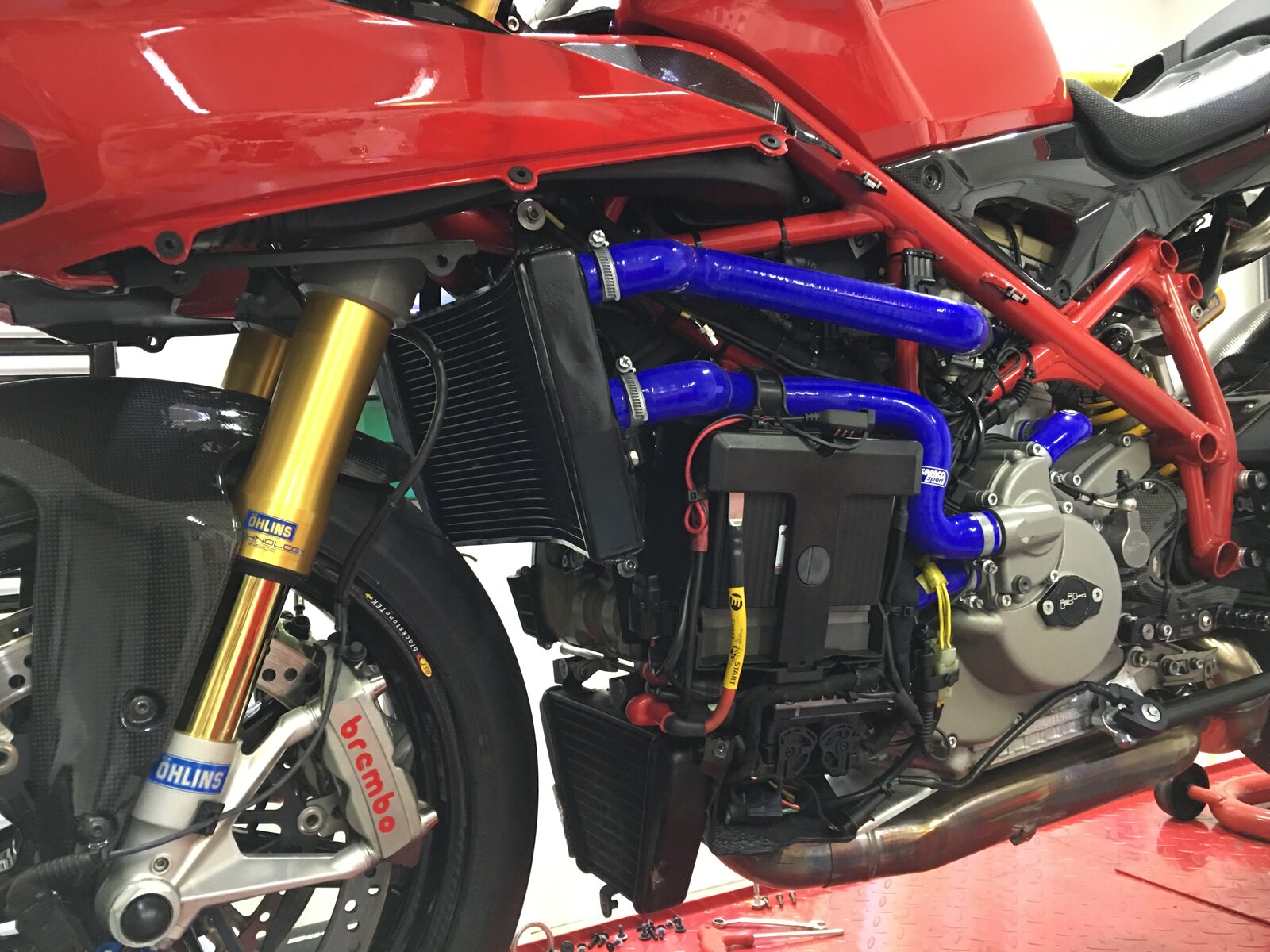

  17. I used the triumph adapter kit and a rec/reg from a pani.
