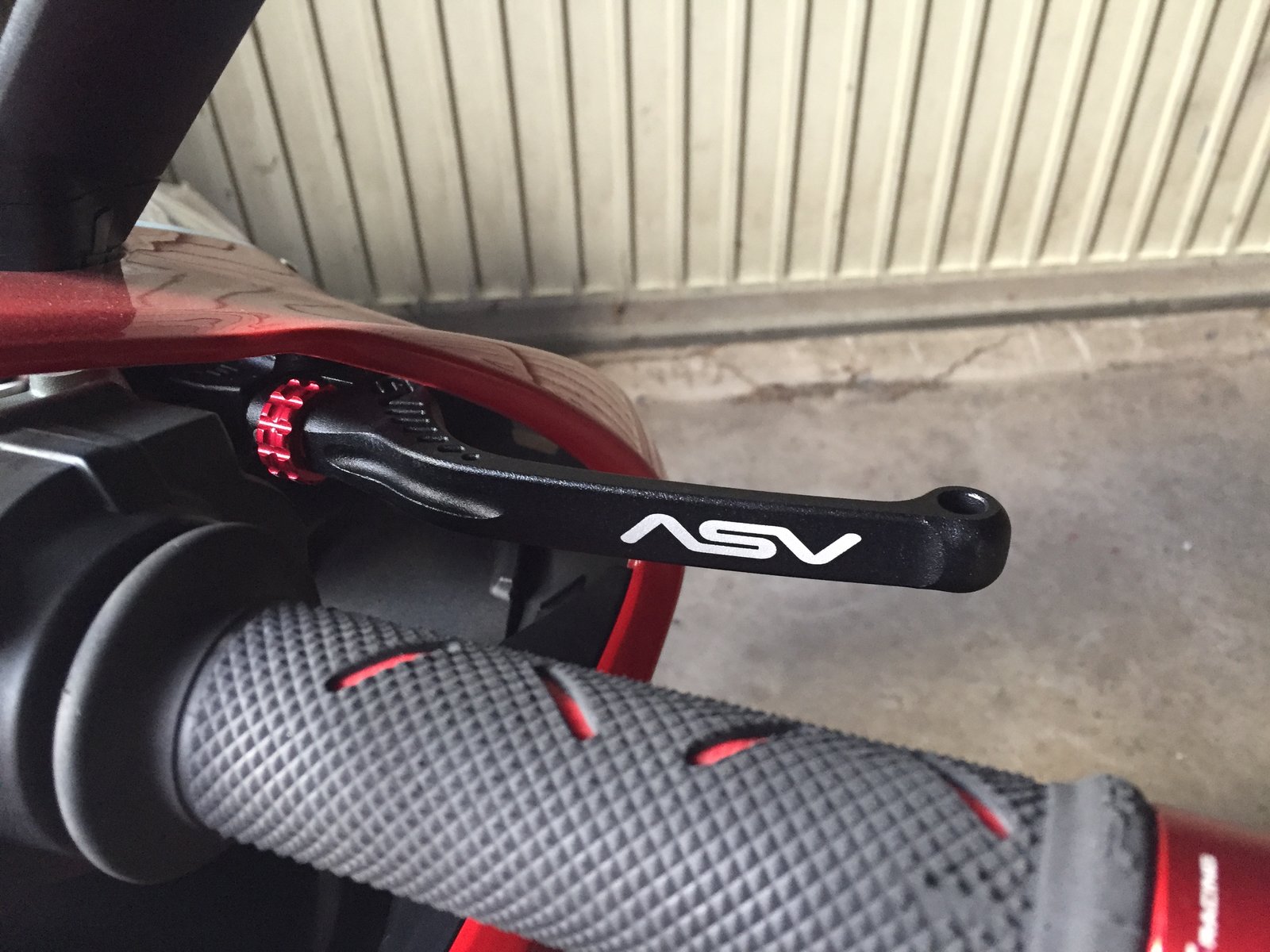

    Just had a slightly annoying mot failure for the front brake lever touching the nose cone fairing on full left lock. Even with the adjustment on the most flexed setting. Guy quoted me half an hour of labour (£50) to adjust the headstock. I opted to take it home and stick the OEM lever back on and have it retested (for free) in a weeks time.

  2. Adjust the headstock??! what was he proposing to do with it? Should have just Adjusted the lever position perhaps if that gets it out of the way, five minute job and then put it back the way it was after.
  3. Alternatively, adjust the lock stop so it’s earlier.

  18. It’s right they fail them. If they touch, when turning slowly it could pull the brak on and create a crash. So it’s dangerous.
    You could just undo the clip on and move it so the pin sits between the clamps and try that. Its a 1min job that could save a ball ache of changing levers.bor just drop it lower and move till it doesn’t foul tank or fairing.
  19. It's a pretty basic and essential necessity to arrange handlebars and controls so that they can't trap your fingers or thumbs on full left or right lock. If they do, it's always been an MoT failure plus it would not pass scrutineering at any race. If you got a tank-slapper you really wouldn't want it to break bones in your hands in addition to your other problems.
