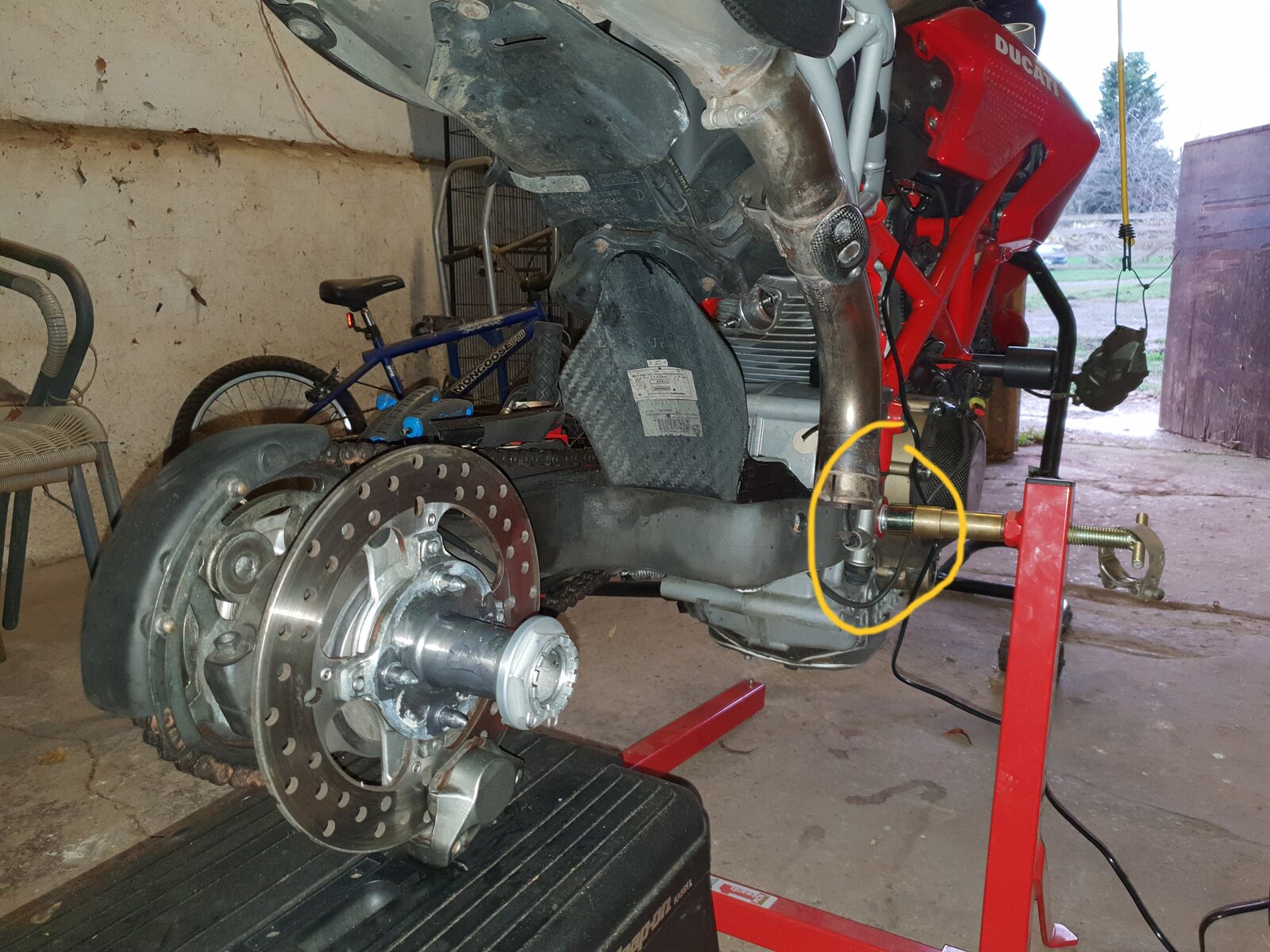

  9. I bought the regular abba stand and I have to remove the foot rests so the adapters fit on my Hypermotard 1100. Could be the same with your stand.
    I only bought the abba stand for removing the front and rear suspension. So probably not ideal if you want it for quick maintenance jobs etc.
  10. Not the best pic but you can just about see where the adapters fit onto once the foot rests are removed. 20190515_074919.jpg

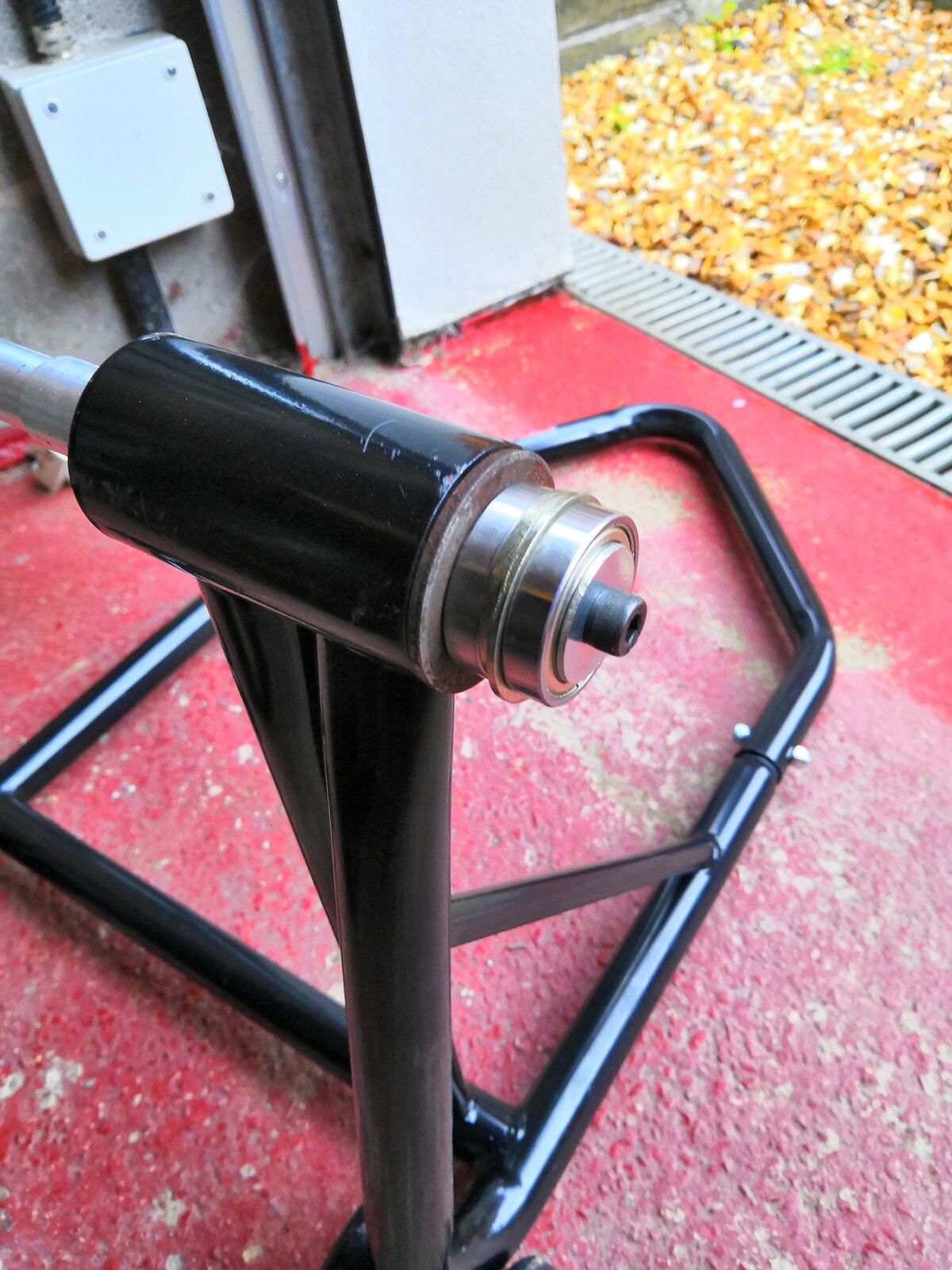

  12. So ordered a Tech7 paddock stand from busters IMG_20190608_162115.jpg and guess what... the pin is too long for stand but it seemed nice and sturdy I decided to mod it instead of returning
  13. Does the modified pin still rotate freely?
    I only ask because years ago with a speed triple, the triumph stand didn’t rotate, and with turning rear wheel to lube the chain, i nearly wound the bike off it. Was very close to a disaster!
  14. Yes turns freely ,The pin is sat in the races in the stand I have just taken up the excess space of the pin sticking out of the back ,thanks for heads up though

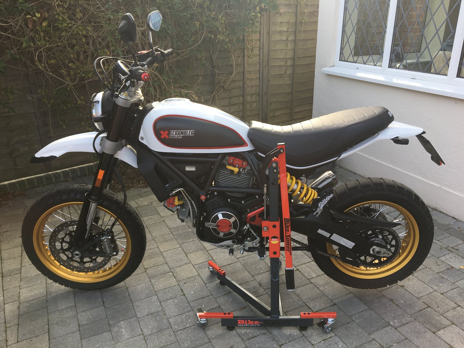

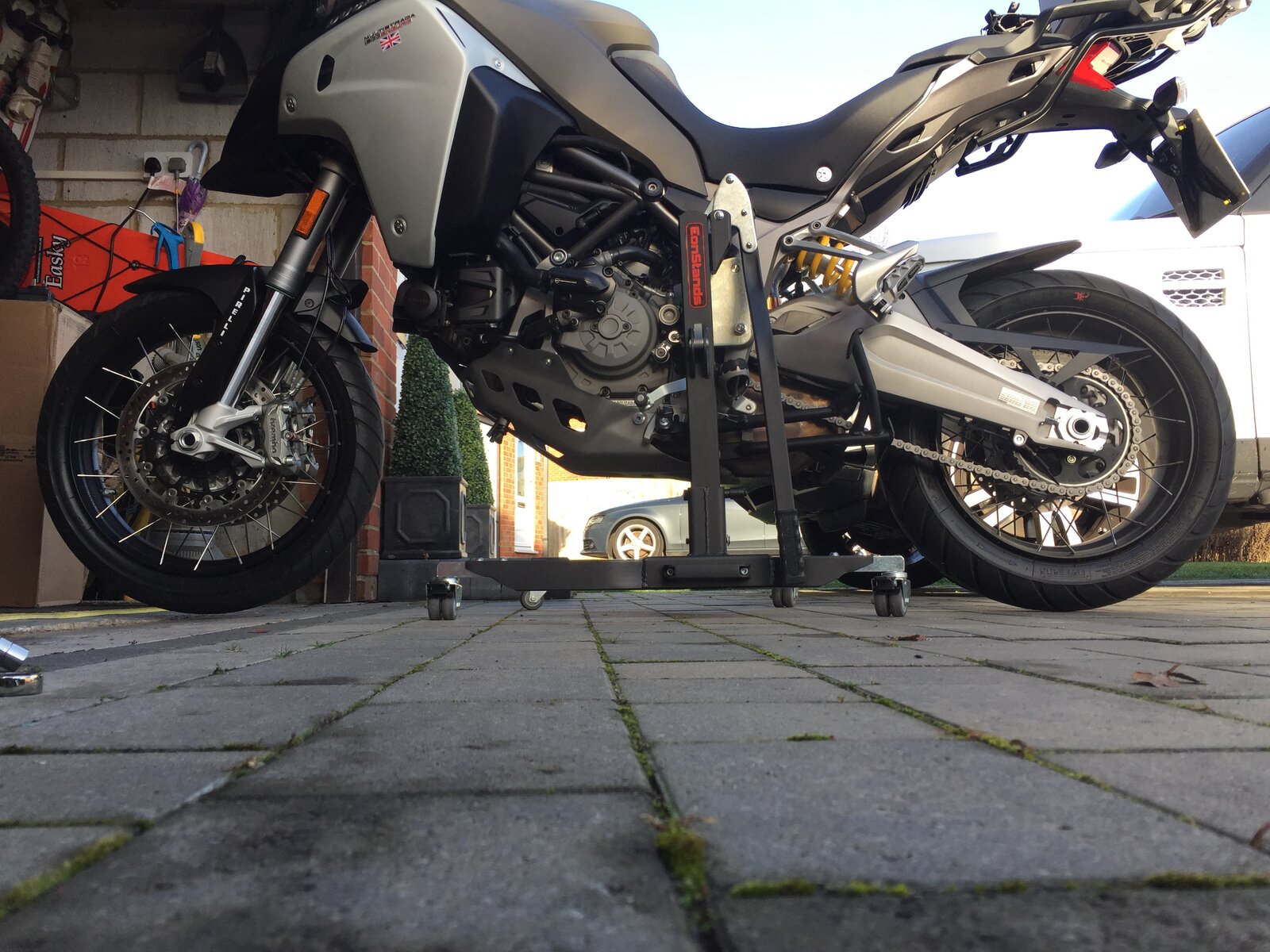

  15. I use the Lift Stand from Bike Tower. Bought it for my Desert Sled now use it for my Hyper 950sp. Superb piece of kit.
  16. BTW, the Abba stands have adapters available separately for all kinds of bike. Would be annoying if you have to remove footpegs each time tho'.
  17. Likewise - Bike-Tower have adaptor plates to fit most bikes.
