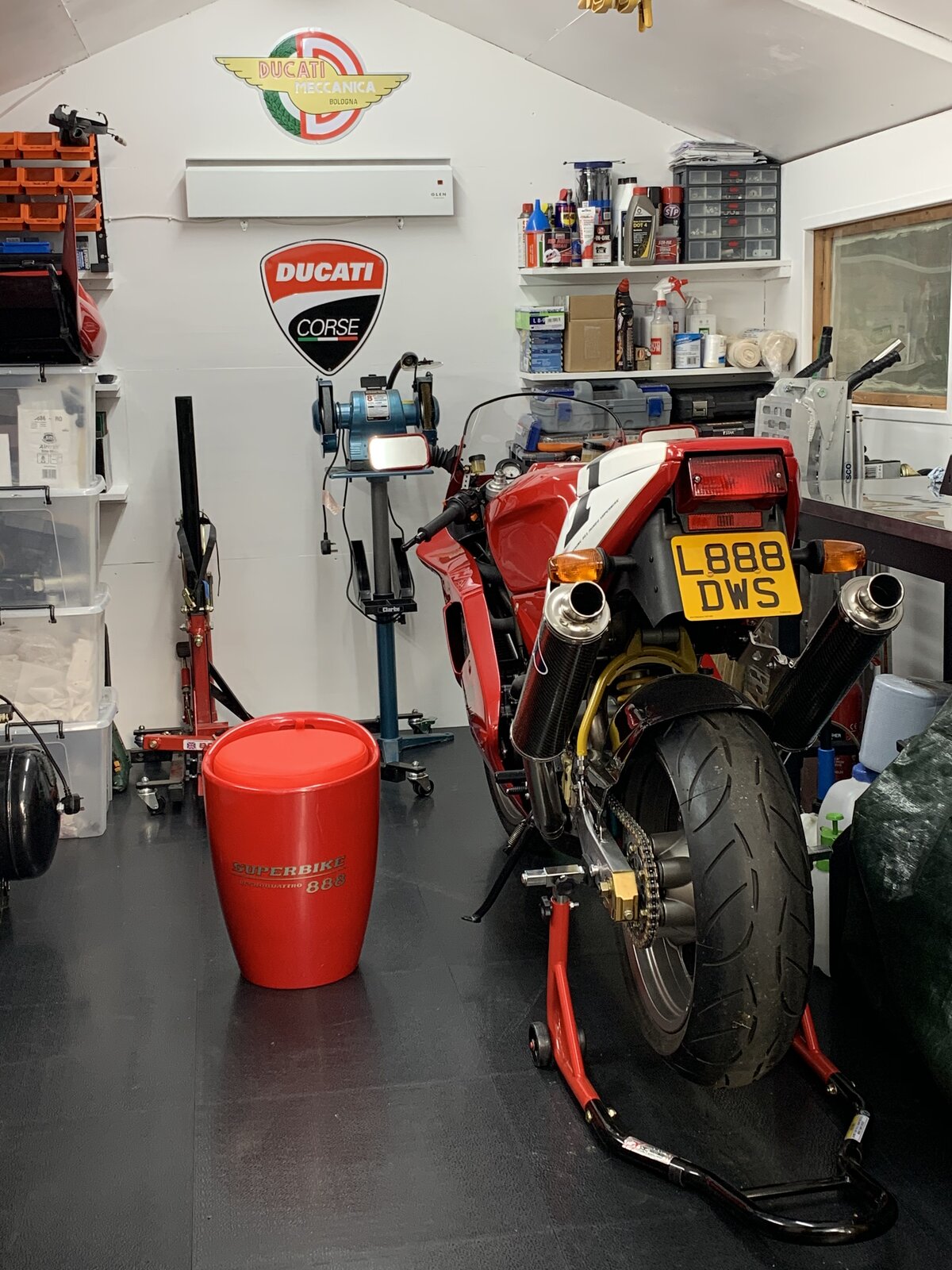

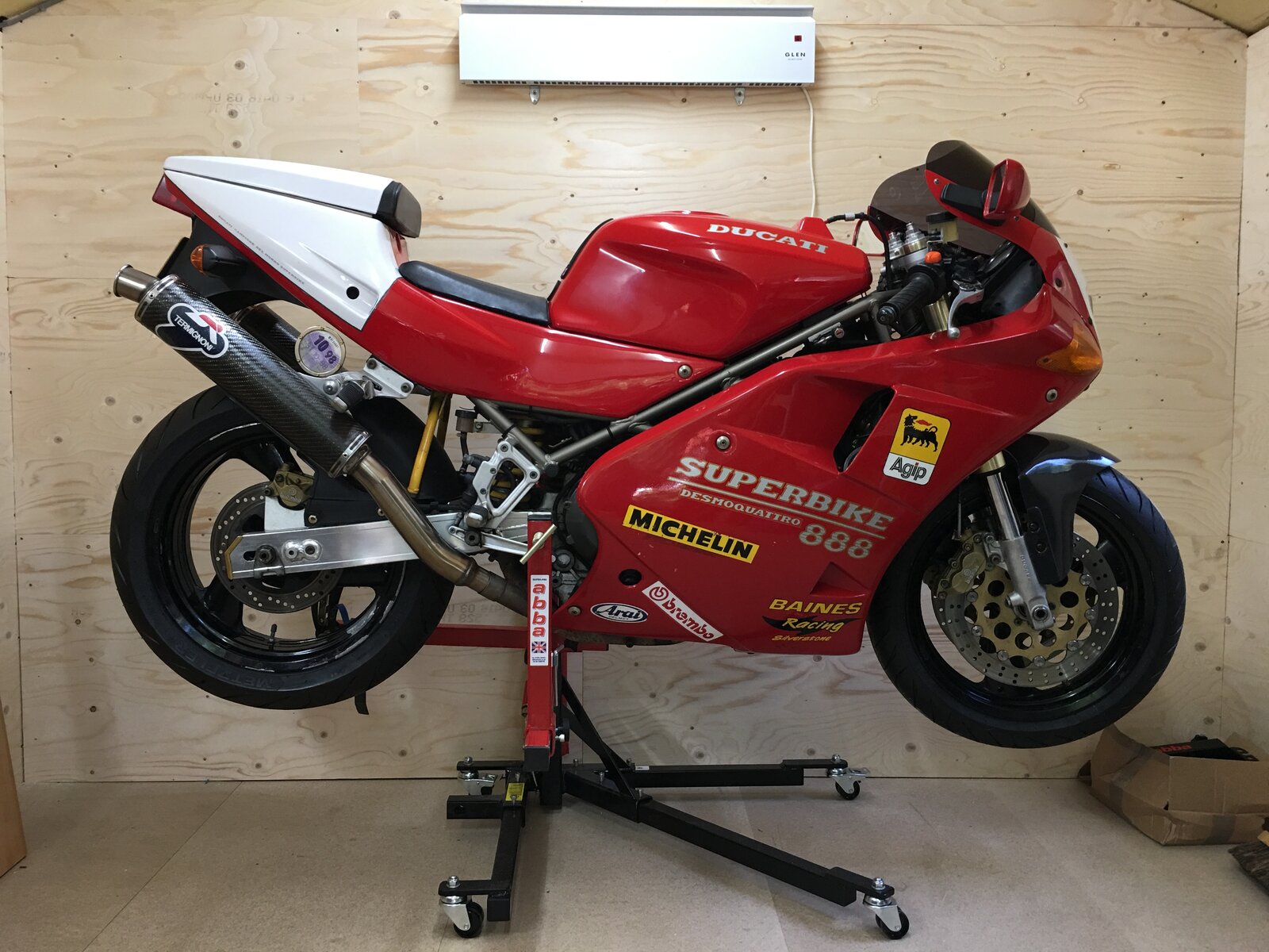

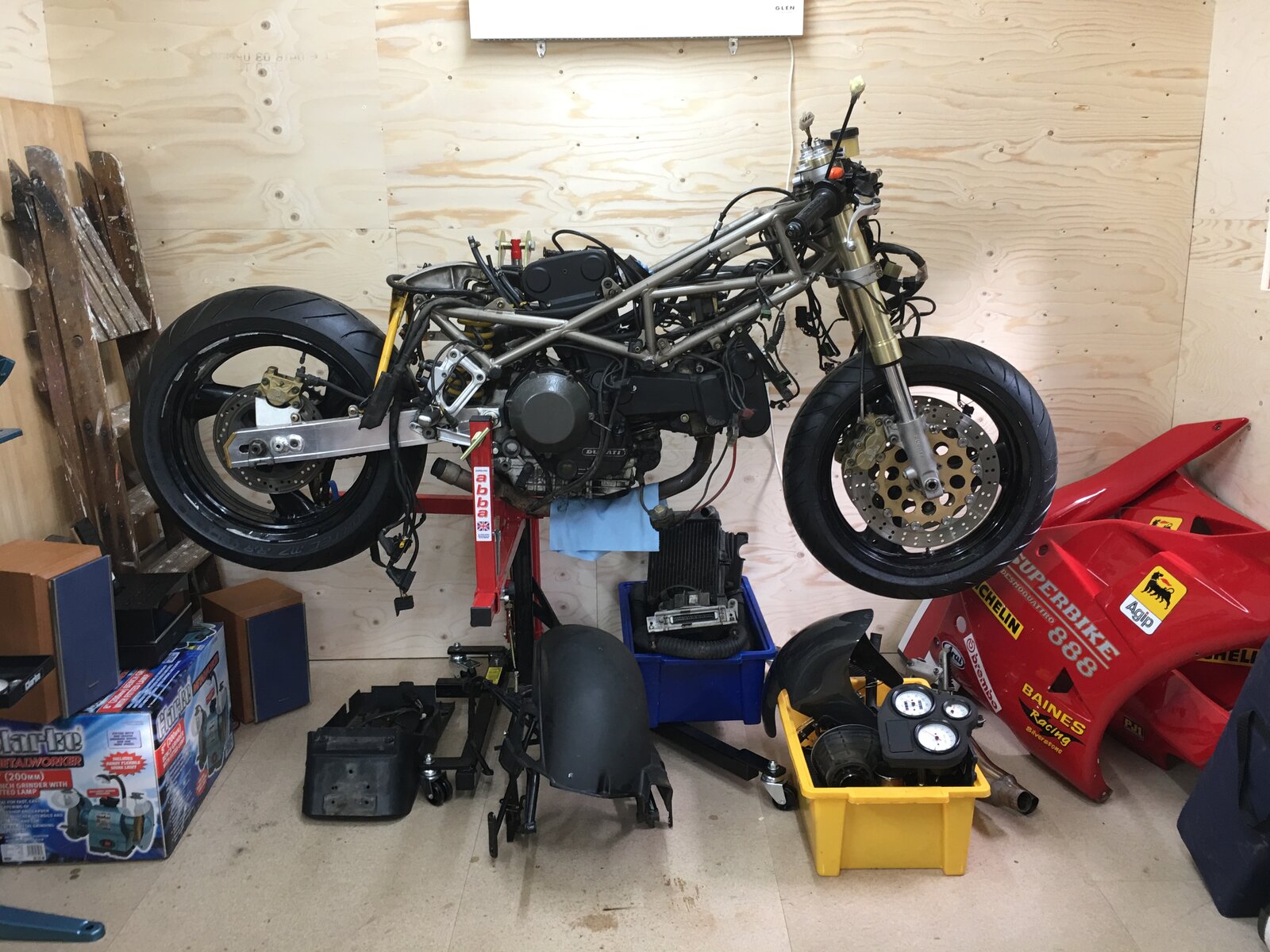

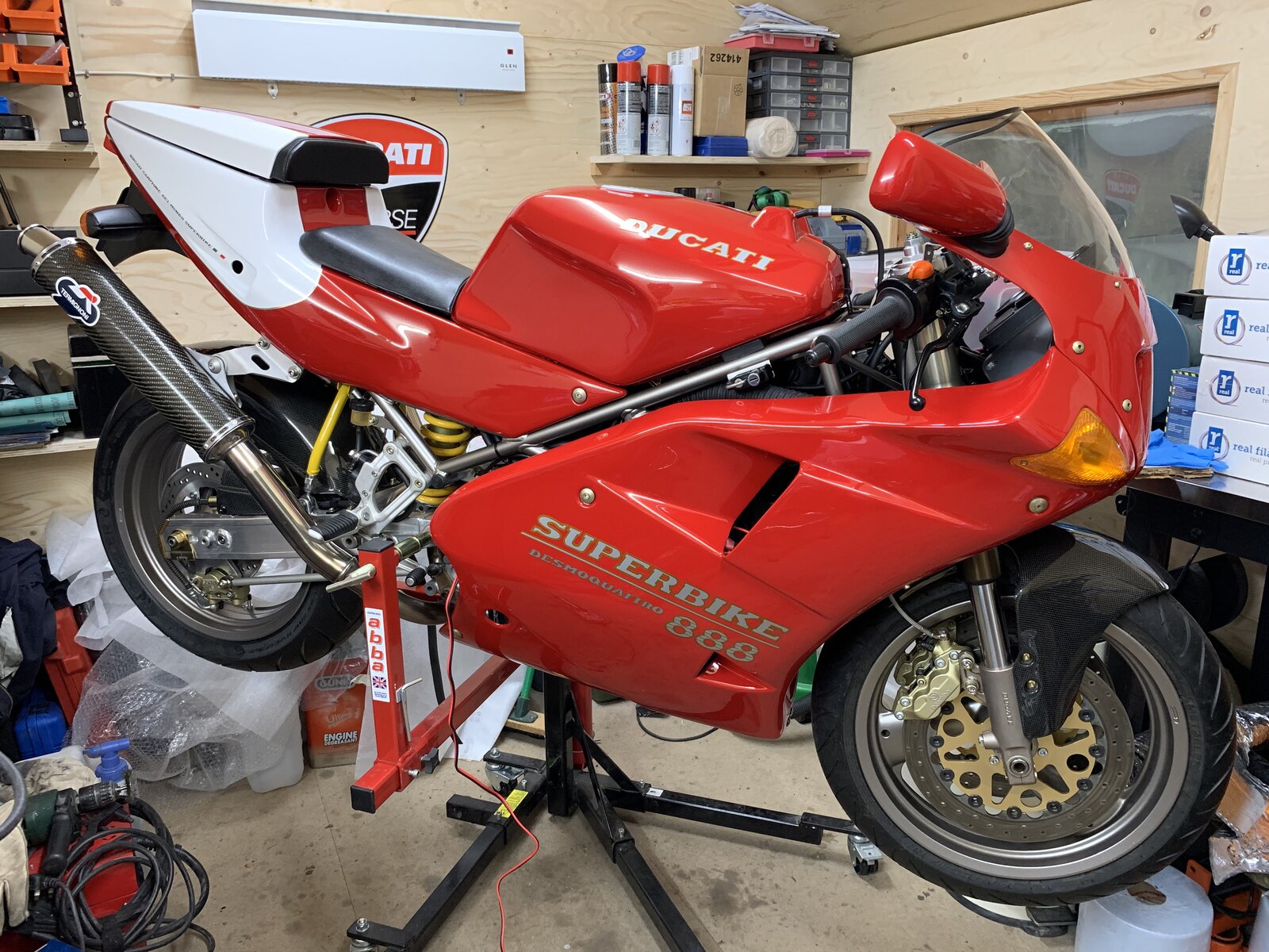

  10. I have the Skylift for the 888, but only for when I am working on her. During the rest of the time, I have the 888 up on front and rear stands to take the pressure of the tyres, as it is easier to get the bike ready to ride using them. I wouldn't part with the Skylift, fo the times I want to get close up and personal with the lower parts of the bike.

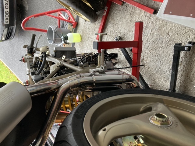

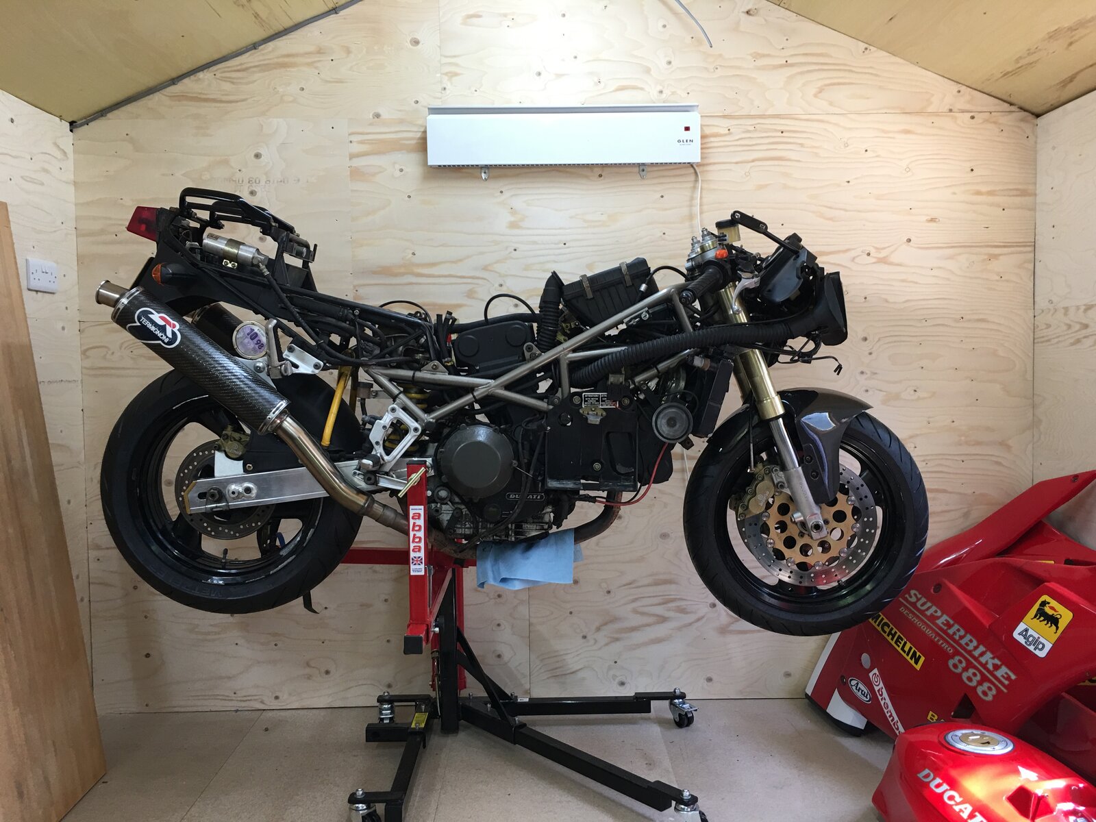

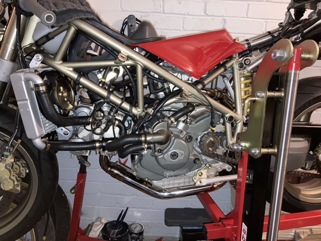

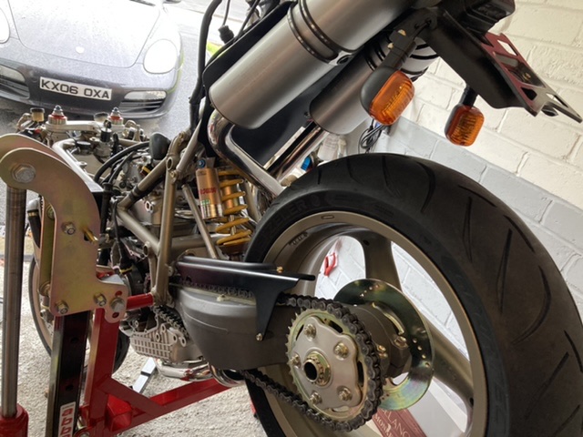

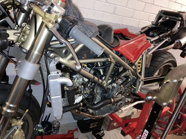

  13. I have a skylift and find it excellent for most operations. It can be restrictive on the sides of the bike around back brake, foot pegs etc Due to the ram and lift gear, but if you used a conventional paddock stand for that type of work it’s fine. It is mega sturdy and there is no flex when the bikes on or moved around on a semi good floor. A sheet of ply on the deck may work if you were in a barn etc. I also have an abbastand with front lift arm which are great for the money as there’s not even any weight on the suspension when in use but they are a static only use. I dropped a 916 with no wheels on last month though my own stupidity of trying to ease it out the way in the garage. No real damage bar paint scratched on the frame and a near heart attack lol. 41A3BC1F-ACA1-49A1-AB6A-719C1E138AF1.jpeg 256E8CA7-61F7-4980-9E37-BC0A5EA6B0A6.jpeg 3E980F89-05A8-4D6D-8651-2C5A088723FF.jpeg 3927627B-5931-4B1C-9777-18C6BCDEA012.jpeg The abbastand is quite a simple affair and flexes easily if you start moving it about and can fall out the frame lugs. My verdict is if you spare the money, get the skylift and they hold their money so well if you were to sell it you would not have lost a fortune.
