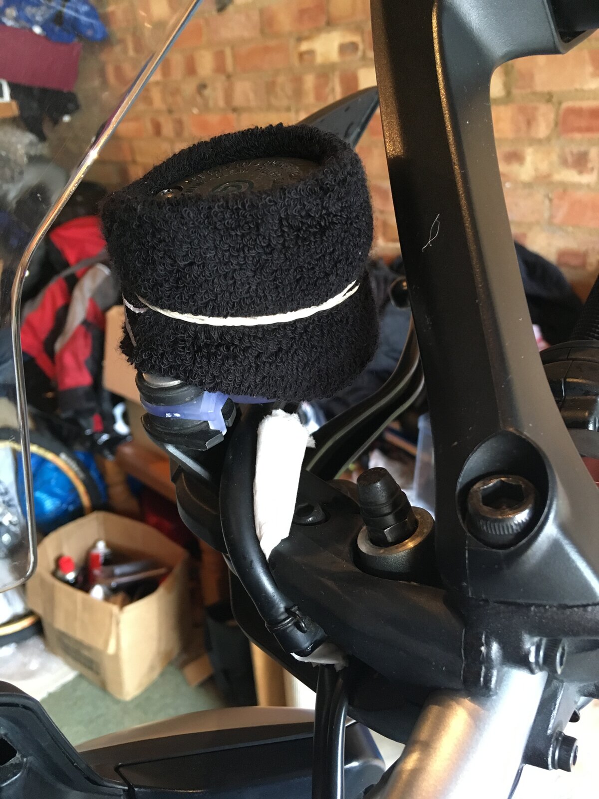

  9. I get the same on my 17 Enduro. I went with Bradders suggestion of putting a sweatband over it - you can see it has collected some outflow? Bit like brushing dirt under the carpet, but at least it stays off the paintwork?
  10. Yes I have done the same, but I am worried that if fluid gets out then air gets in? And is it safe, might the brakes fail at any moment?

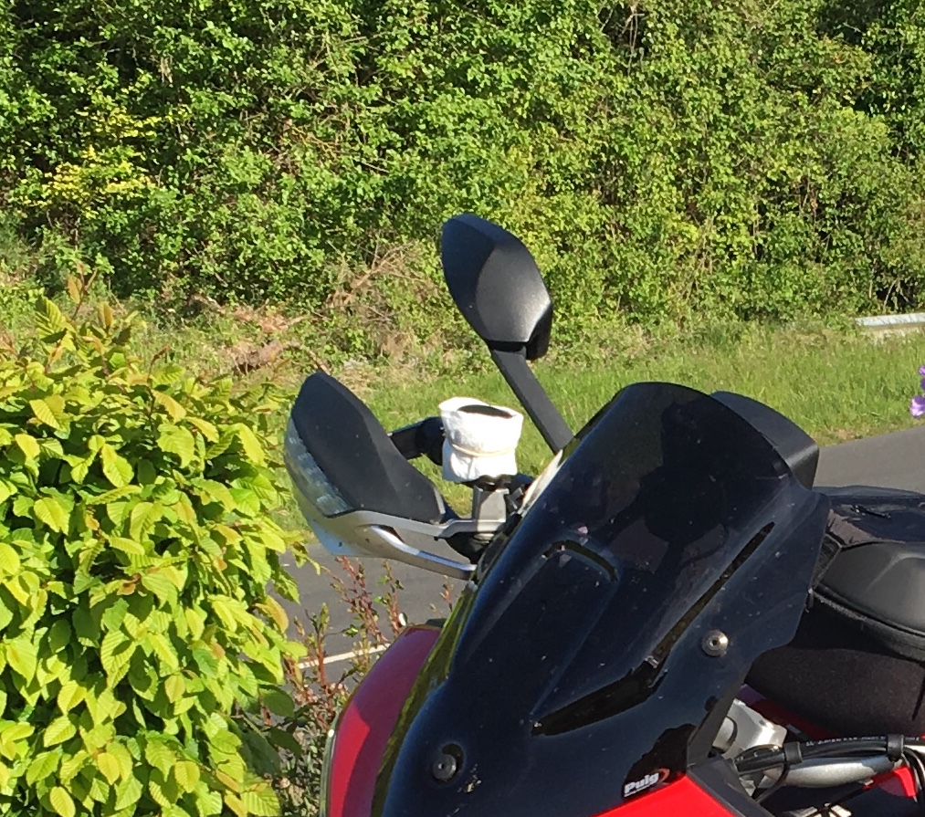

  15. Hairband round the pot, no kitchen roll. BDA01E8C-4795-498E-81B4-1A4A8CC7D53F.jpeg
  16. With kitchen roll. Sounds daft but really helps trace where the leak is. Also good if you can’t get a sweatband in time.
    Check your hoses and hose connection.
    So long as the fluid is kept topped up enough there is no danger. BUT if you let it drop below the level then it could b e very very dangerous. Having said that the weep should be so slow that a capable fella like you should be able to monitor it and keep it topped up.
    Take a can of fluid with you. Don’t over tighten.
    If it’s not the pot ( new one) it must be the lack of seal from the cap. Or hose or hose connection. Most likely the seal. You’ve probably crushed it by over tightening or it’s gone brittle with age. If there’s time or you’re passing a Ducati dealer I’d buy one of those.

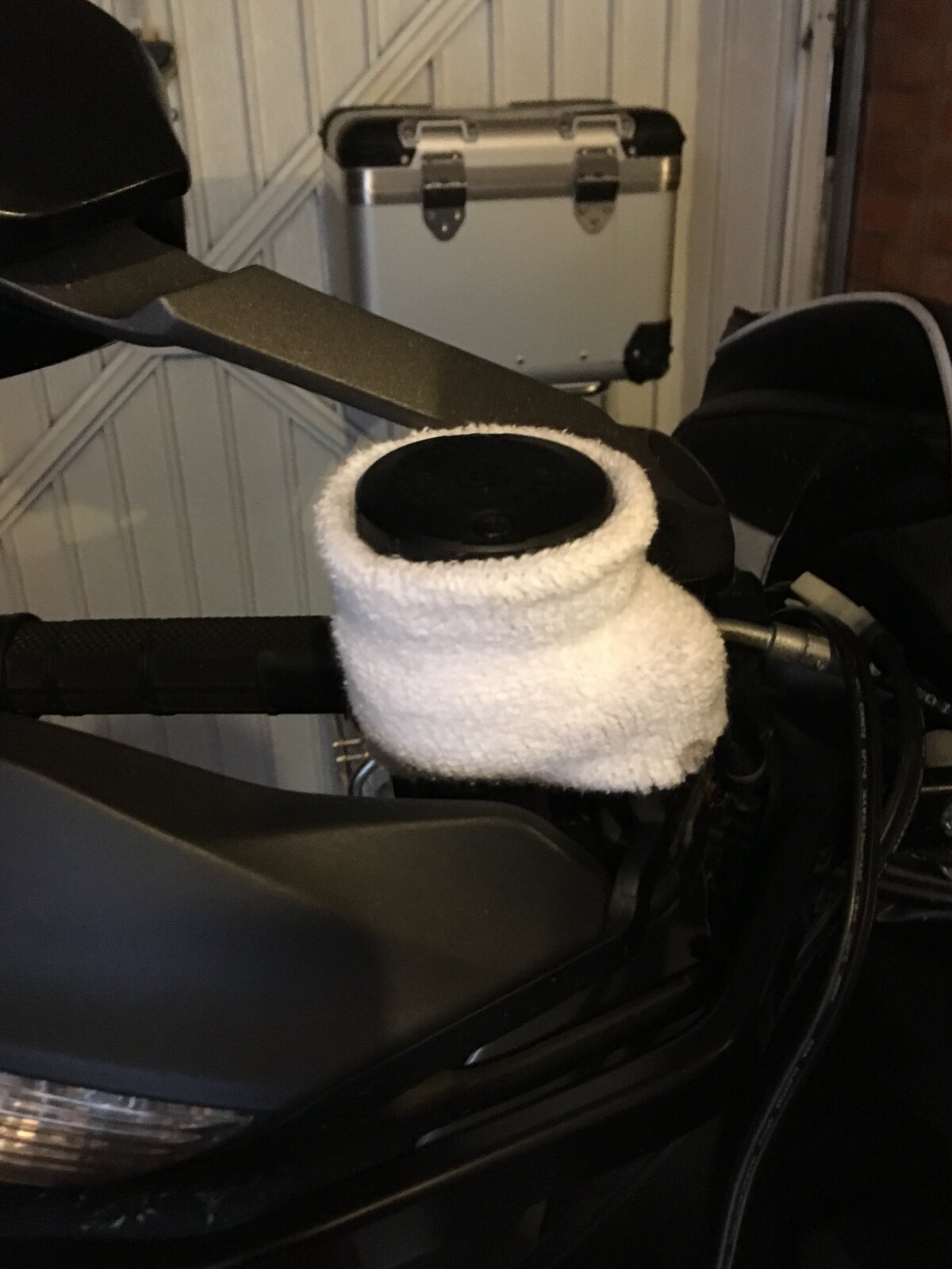

  18. And a photo of my handy work just for good measure. I will report back on how the PFTE tape does.
  19. Excellent. Why not put a bit of kitchen roll inside the sweat band so you can easily see if it’s leaking.
    I wonder if the black sweat band will stop it.
