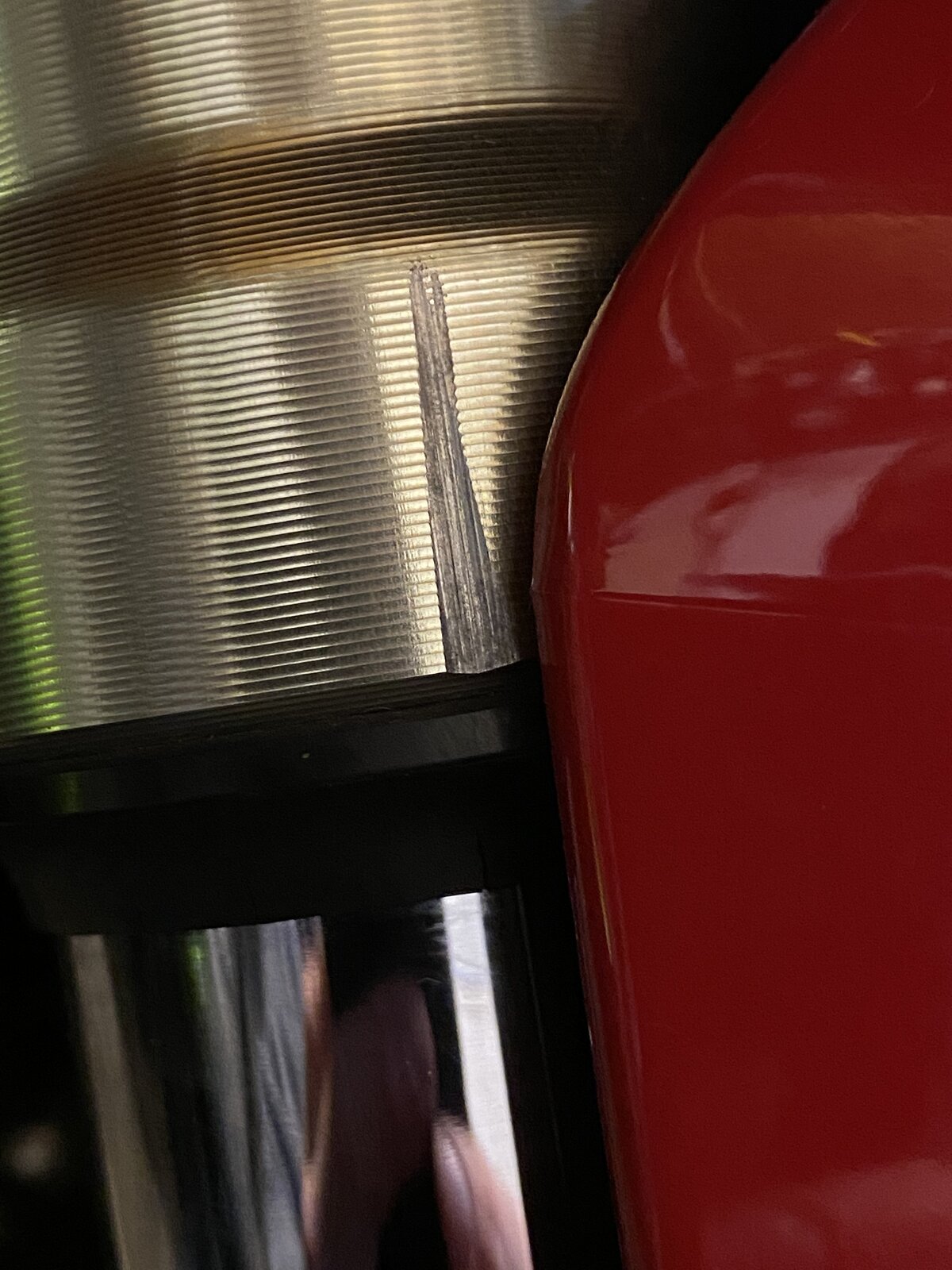

  1. Hi, just noticed this on my Ducati 848 evo. Same on both sides. I’ve not had the bike long but not sure if this has happened since I’ve had it or it was there all along and i missed it when I looked it over. Anyone else had this on there 848? 06DACCBA-6CDC-4C1A-B19F-D0D27956704B.jpeg
  2. not personally, but seen it many times, most irritating, all you can do is trim/correct for clearance and swivel fork to less visible area.
  3. Check the 4 screws holding the fender to the forks are the originals. They should have a collar that positions the fender accurately. Some get swapped out for aftermarket with out a collar and that allows about 5 mm movement…. Also, if the factor ones are fitted, loosen all 4, hold the fender forward and tighten down. That should give a bit more clearance.
