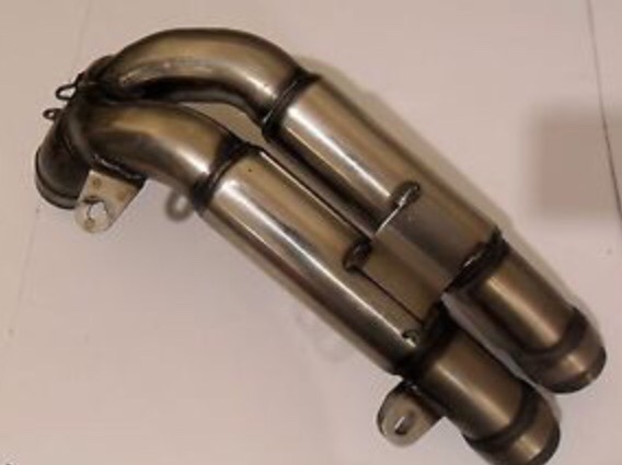

  8. Well I would buy them without any ecu, and remap it on the Dyno. Even with a ecu that comes with the exhaust it's still not running optimal and it needs a remap. So wasted money to buy one. I can still have a look for you. For the 998 45mm is a good one. Off course you can do the route of 45-50mm but performance wise it's a lot of £ for the hp you're getting. I took the 45-50mm system because I could get rid of the ugly tubes.
    Standard 45mm:
    Vs
    The 50mm:
  9. So without sounding like a plonk here.. Has anyone just taken the end off their standard cans.. Ripped out some of the guts (to get more tone) and re-dynod/set ECU up with any results... Or am I an outcast even mentioning that?

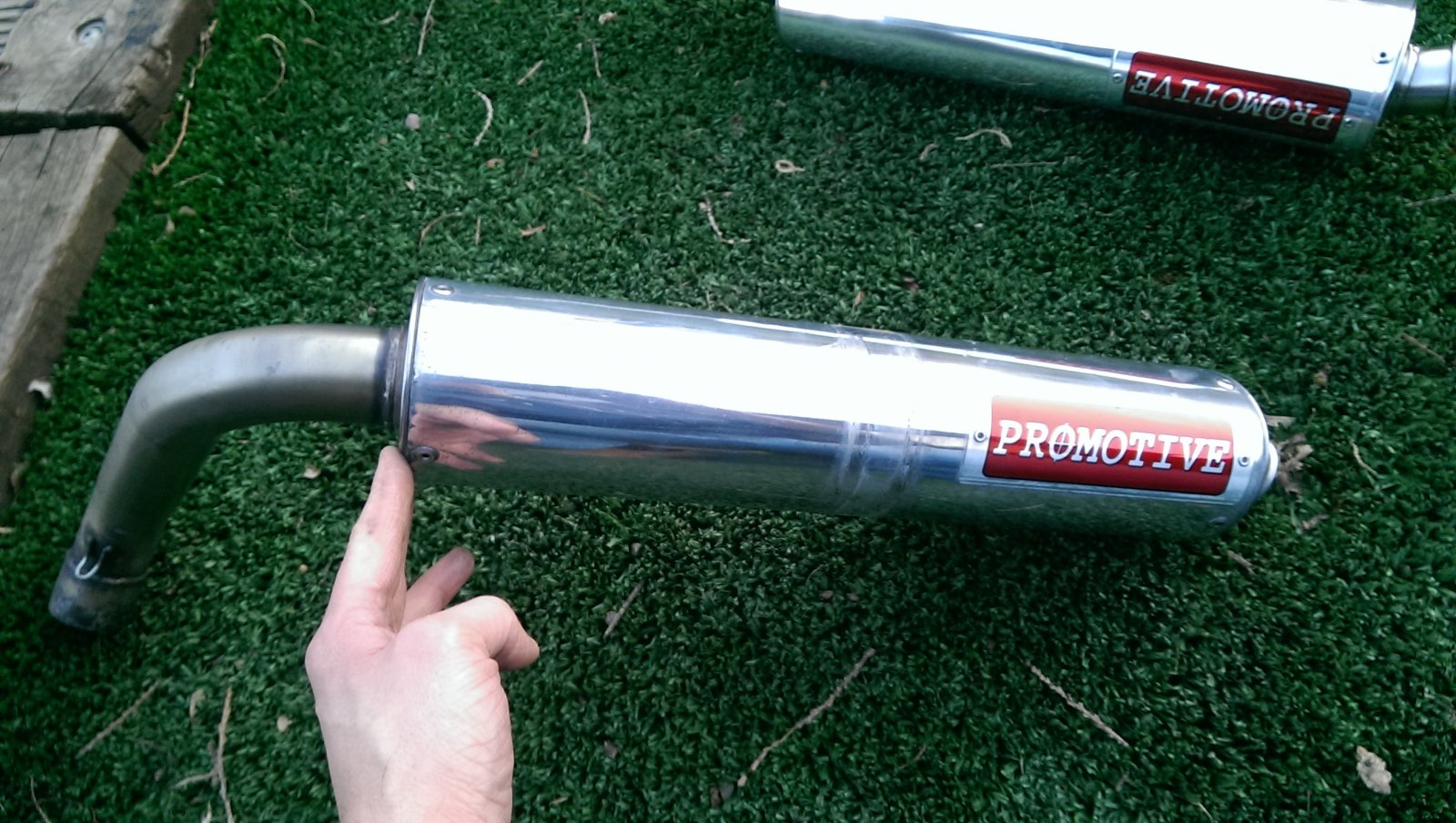

  11. I picked up a set of Promotive 45mm cans which I was in the process of cleaning up before someone pointed out I already had a 45mm-50mm set up :Banghead:. You can have them for what they own me, £110 + p&P. No dents, but still need some time with a mop/elbow grease, but that's what winters are for :). I can send some more close up pics or you can come and have a look if you like, i'm in the HP4 postcode.

  12. Those pesky 45mm link pipes have baffles in them.My bike has 45mm Arrow cans(not for road use ssshhh)but still aint fruity enough.:(

  14. Keith, too true! From investigations, on the standard 998 .....changing out the collector pipe would be a difficult waiting exercise with higher expense ... and with little gain (except for perhaps slightly more noise and better looks).
    It seems on the "S versions" the benefits are greater!
    I think Im going to settle for 45mm titanium slipons for my standard 998. Seen some titanium termis I can get second hand for 290. They look in good nick.
    @Cream_Revenge. Many thanks for your offer mate, however, after many hours of study.. I think im set on Termis or Akrapovic's for the bike.
