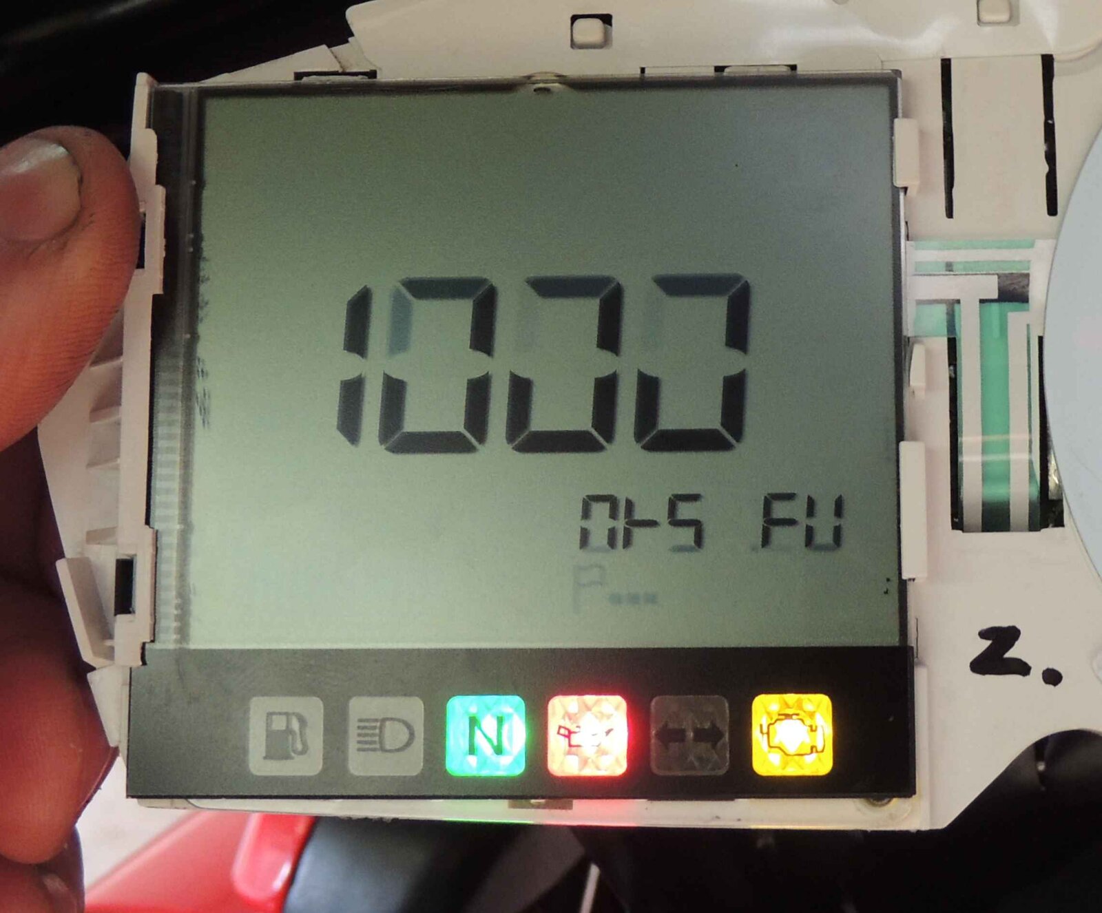

    Finally had a chance to take it for a spin and filled up the tank. Tried to set the trip km but the display went a bit wonky. Some of the LCD connections could not be too good. I did get a spare display with the bike. Been playing with electronics all my life so time to see if I can find the problem and opened it up.

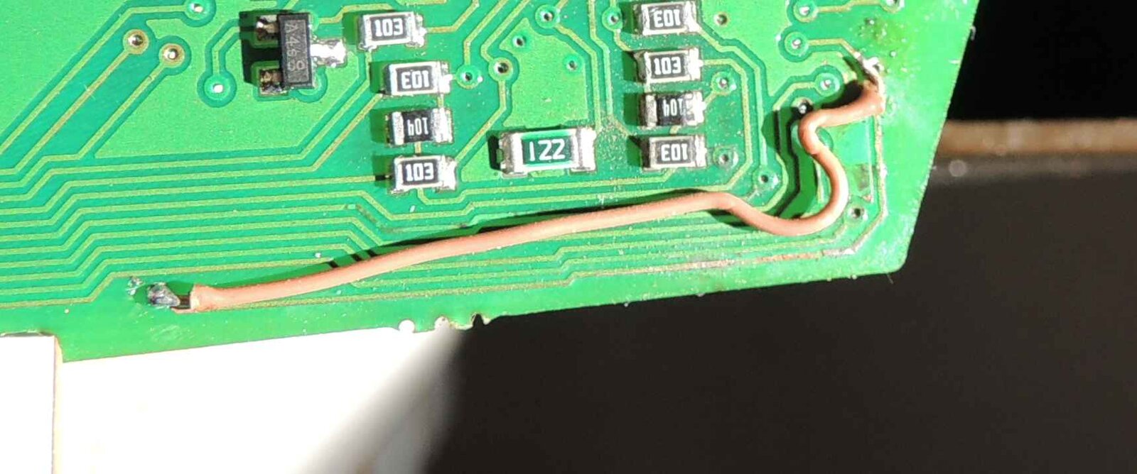

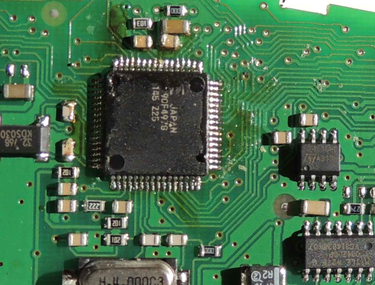

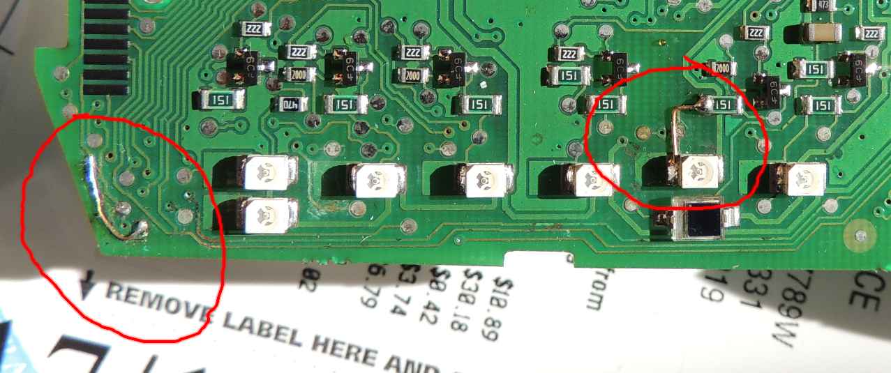

    This has had a bit of work done to it. The main CPU has been changed, easily
    see as it has been hand soldered, 3 tracks have burned away and replaced by
    wires and one of the switches replaced. This switch has not been soldered
    quite correctly and possibly why the switch was not operating as smoothly as
    it should in the first place. Looks like a few other solder joints have been 'touched' up as
    well.

  4. Fixed. I'm not sure of the history of this bike, it is exJapan. After a bit of fiddeling and resoldering joints, I tested one added wire for strength and it poped right off. Resoldered it and now it all works.
    3 tracks look like they were vaporised, the main CPU was replaced and several other joints have been hand soldered. Anyway here are the photos and hopefully it may help someone else.
