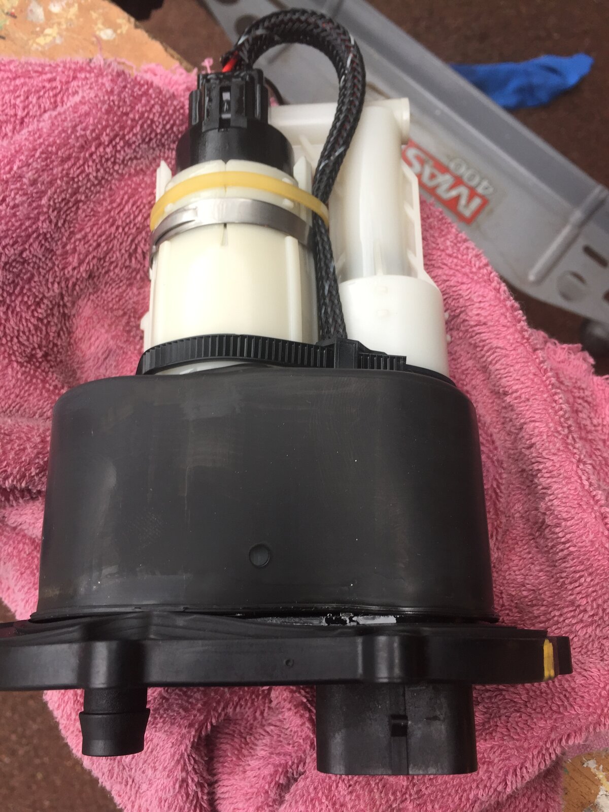

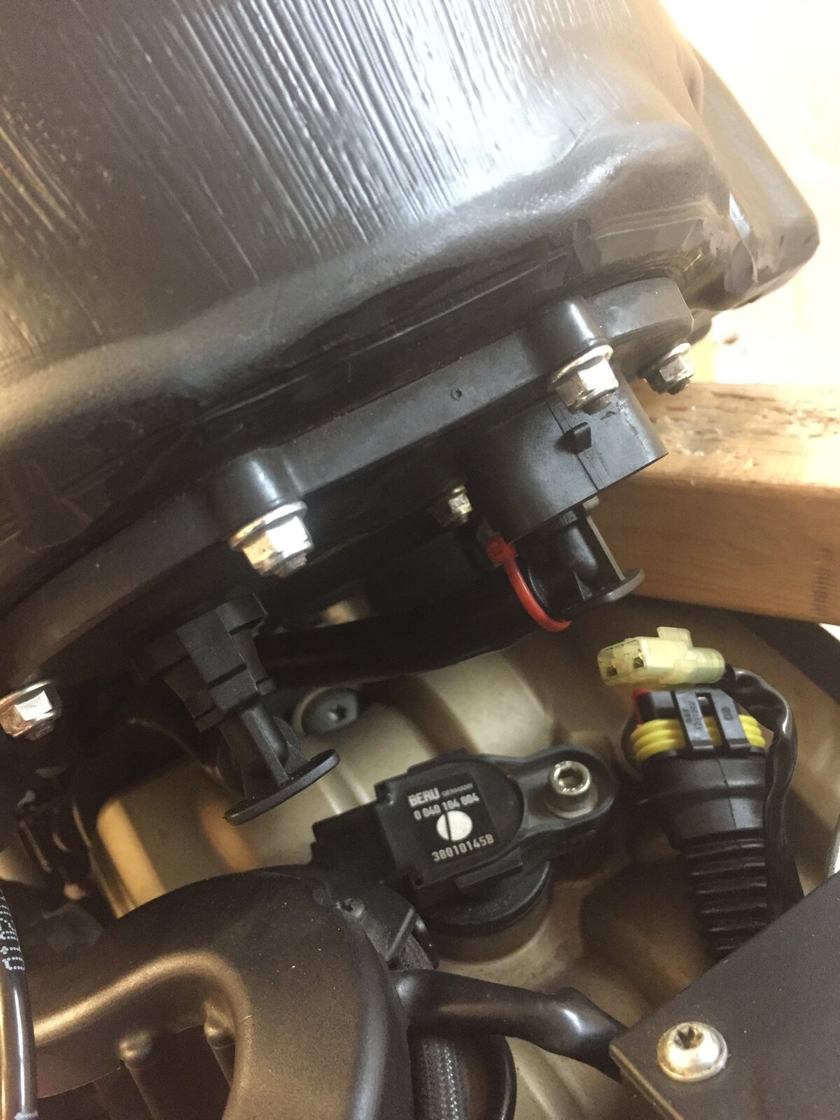

  1. Right as I have done this last night I thought I will post some info. First of you have to take the panels off to gain access to the tank, it's already covered on this forum so I will skip that. Once you get to tank removal release the two quick fittings buy squashing them in, don't worry about a small amount of fuel coming out as they actually are self sealing so the entire contents of your tank won't spill IMG_2732.JPG out, also remove the fuels sender clip and the fuel pump power plug. Make a note of which quick release pipe goes where with a tie wrap.
    Next remove the fuel pump has 8mm bolts.
    Then remove the rubber skirt from the outer pump note how it fits as it has a small outlet hole, then slide the Tie wrap off the pump it's tight but easily done, the reason being why don't you just cut and replace it is because I have no fuel resistant wraps and if you used a normal one it would end up as goo in your tank!!! Next undue the two small phillips screws that hold the filter assembly in. IMG_2734.JPG

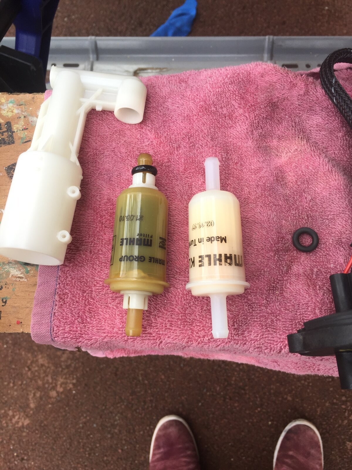

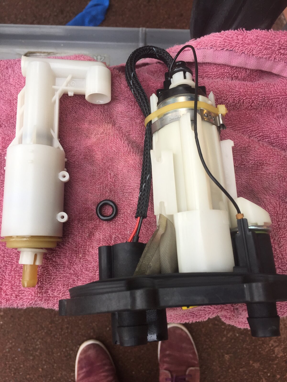

    Slide the plastic housing up, it is a little tight on the o Rings so a little force is required to reveal the filter.
    Voila! you might need to use a bit of silicone grease on the filter o rings on re-assembly as the petrol makes them very dry, pop your new filter in making sure you have the flow arrows the right way and that's it. Leave at least 4 hours for this job and while you are there doing it pop in new spark plugs as you can only access IMG_2736.JPG this when the tank is off. PS don't forget to re-use the plastic collars on the old filter, the new one does not come with them.

  5. The Mahle equivalent replacement doesn't come with them but the OEM replacement does. It also comes with replacement o-rings but only for the filter, not the one at the pump where the housing slides over it.
  6. Yeah but Ducati ones are nearer £35 and I only paid a fiver
  7. I know I use the Mahle ones myself :)
