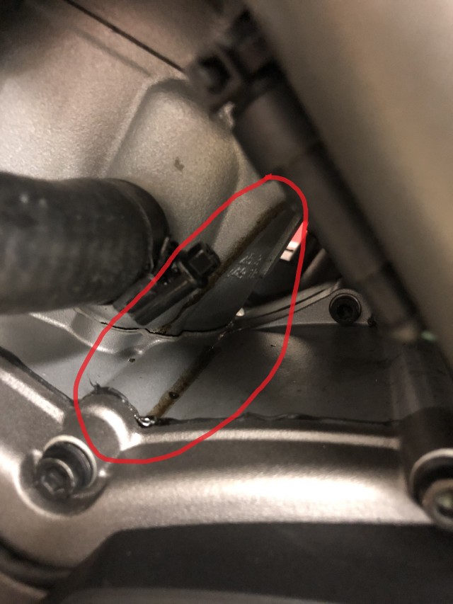

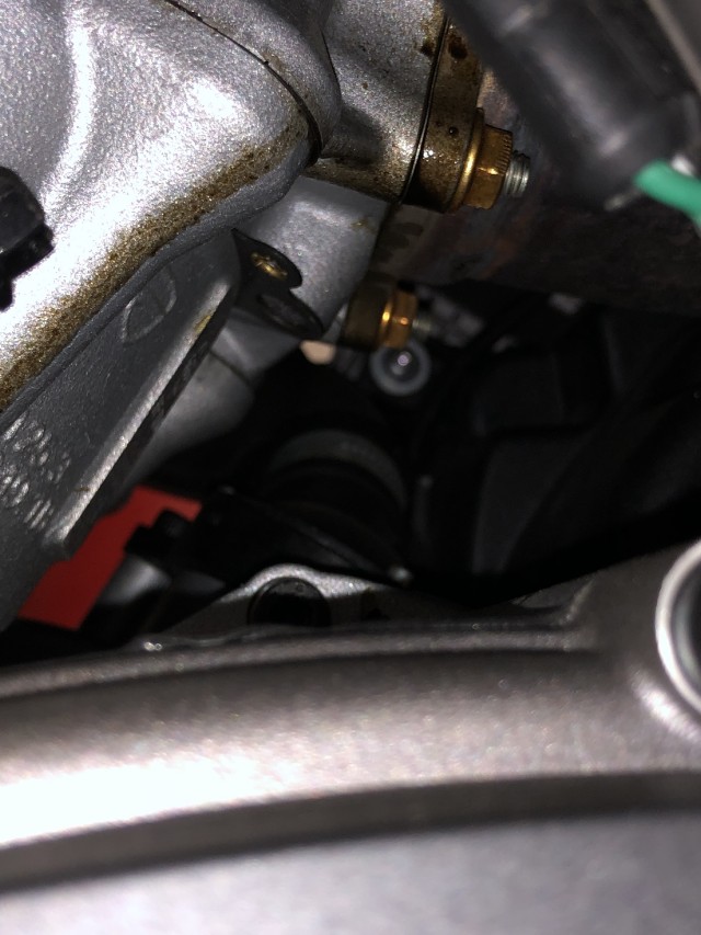

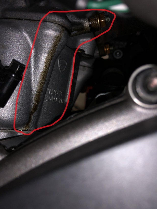

    This are the pictures taken at the moment when I discovered this (after ca 3.200 km on the clock).
    I don't know when it appeared, either just at that time or it was there for a longer time, or from the beginning.
    First, we all suspected (were almost sure) that it was faulty valve cover gasket.
    But after they wiped the oil trace and checked the bike, it turned out that valve cover was completely dry and they couldn't discover where it was coming from.
    After that, I was riding more and I was forcing it to leak (higher revs, higher speed), but only what I dot whas this below.

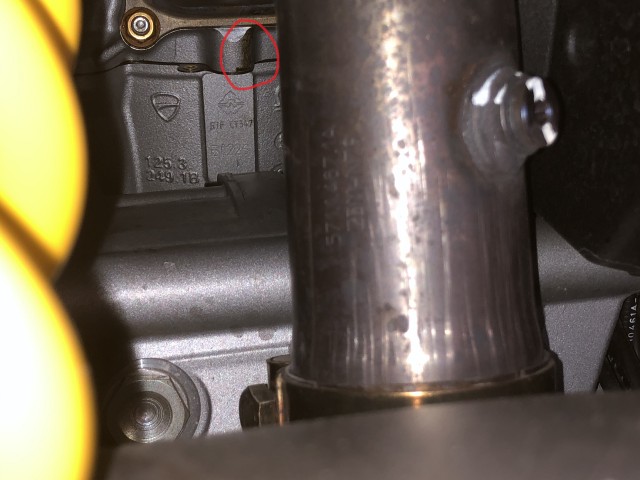

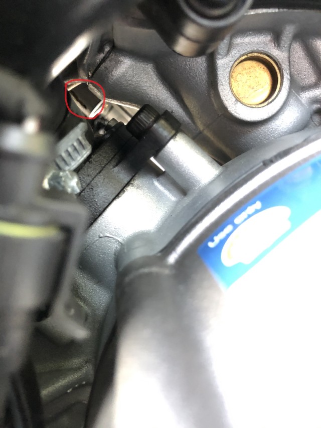

    When I wiped that again, I got myself a dentist mirror and checked completely closely the exhaust gasket(exhaust - manifold).
    Now it looks like this:
    It is definitely coming from there - from the bottom part of exhaust gasked on vertical cylinder- at the service, they are telling me that it is the leftover of some grease from the factory, melting. They cannot find anything else and they are persuading me that this is not a leak.
    When I closely look the gasked, it seems a bit greasy and these are some burned spots on the exhaust around it - might be some grease - maybe they put grease in the factory when they assemble exhaust and manifold together?? - and they put too much this time
    But still, can it be exhaust gasket leaking? I don't know how it looks when exhaust gasket is leaking - for me it would be strange to see oily, liquid texture - it shoud be just burned and dry if exhaust is leaking.
    This what I am getting is oily and liquid - and it is not getting around the bolts and everywhere around gasked like on the first picutres, now it is just a tiny oily trace at the middle of the exhaust gasket- and not even close to qty like it was when I first discovered it,

  2. I guess you’ll just have to ride the bike some more and see what happens. Keep a very close eye on your oil level, although sometimes these bikes can use a little oil...but it wouldn’t present itself like that. Seems strange to have a lump of grease melting from there but maybe not impossible.
    Ride it, see what appears. A leak from the exhaust would show as a dry powdery black or darkish brown dusty type stain, not like an oil leak. Keep checking it’s not oil from somewhere else.

  8. And yes, after I wiped everything, it reappeared as a tiny trace, just below exhaust (coming actually from the exhaust gasket) but that is all above head gasket...

  10. Get some talc and dust it over the areas above the leak and this will show where it is coming from.
    Pics 2&3 show it is dripping from above and is running down the exhaust stud.

  15. There isn't (or shouldn't be) any oil in the exhaust to leak out, only exhaust gases. Any oil in the exhaust would be evident as blue smoke, probably mainly at cold starts. It occurs to me though that the threaded hole for the exhaust stud could be drilled too deep and has broken through the inside wall. This could allow a small weep down the exhaust stud that would appear to emerge from the exhaust gasket.
