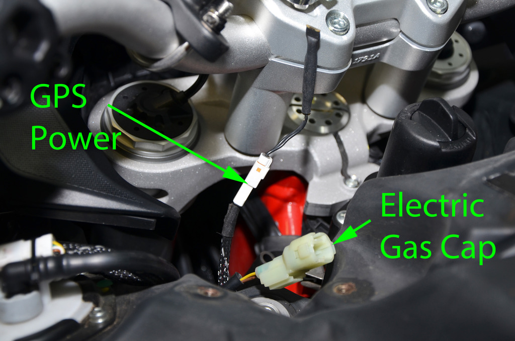

  2. First, there is a pre wired switched live for the sat nav under the plastic panel to the left of the tank. Easy to get to just pull the plastic cover at the top of the tank and that will reveal 2 Allen head bolts to undo so the trim slide off and you will see the connector.
    It has a short lead that you need to open up and connect the sat nav wires to

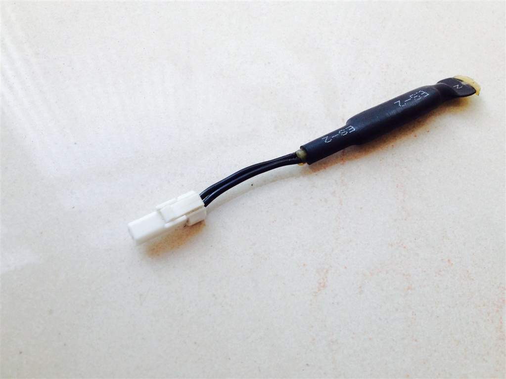

  4. The connector, should you need to know, is a JST JWPF 2 pin, if you want to crimp your own. It's also used on the indicators I beleive.
