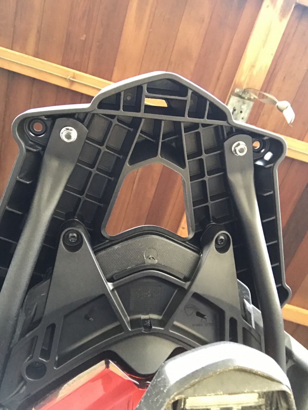

  4. @Jeff Terry This is the Givi one:
    This is the Ducati one:
    Parts for the Ducati version are about £220
    I have the Givi I can sell you :

  6. I’m definitely interested. Do I need the rails as well? I’ll probably have 8 to 10kg in it when I go to Spain.
  7. Givi generic topbox mount does not have rails - you can see it clamps to the existing Ducati grab handles/rear rack.
    If it was me - I wouldn't carry that much using the Givi system. Even the Ducati system with rails says max load is 5kg. (although I've carried more).
    Basically I've stopped using the top-box unless I'm carrying the missus on the back who likes the security of having the topbox behind her.
  8. Ok. We just need to organise me buying the plates off you then
  9. Mate of mine had the Givi plate, without the support rails, on his DVT Enduro. Didn't take long to crack the grab rail.
