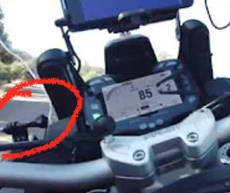

    I have a Drift camera and I use a handle bar clamp, double socket arm and device base, but this is similar for a GoPro. I mount it on the left handlebar and lean the arm parallel with the mirror.

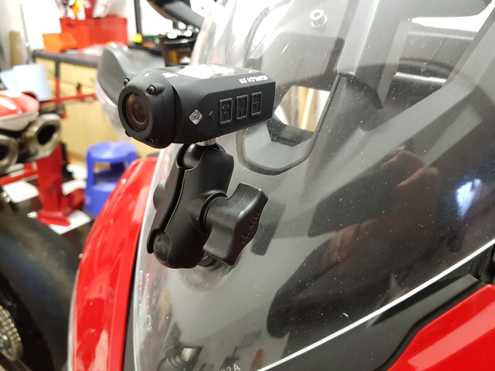

  12. This the OLFI mounted on the Aux light. I used a piece of alloy tube over most of the long RAM bolt with a nut on the end just so it looked better.
    I use it as a SMIDSY Camera mainly so it comes on with the bike and is on loop recording, at 1080p and 60fps a 64Gb card does about 4 hours of recording.

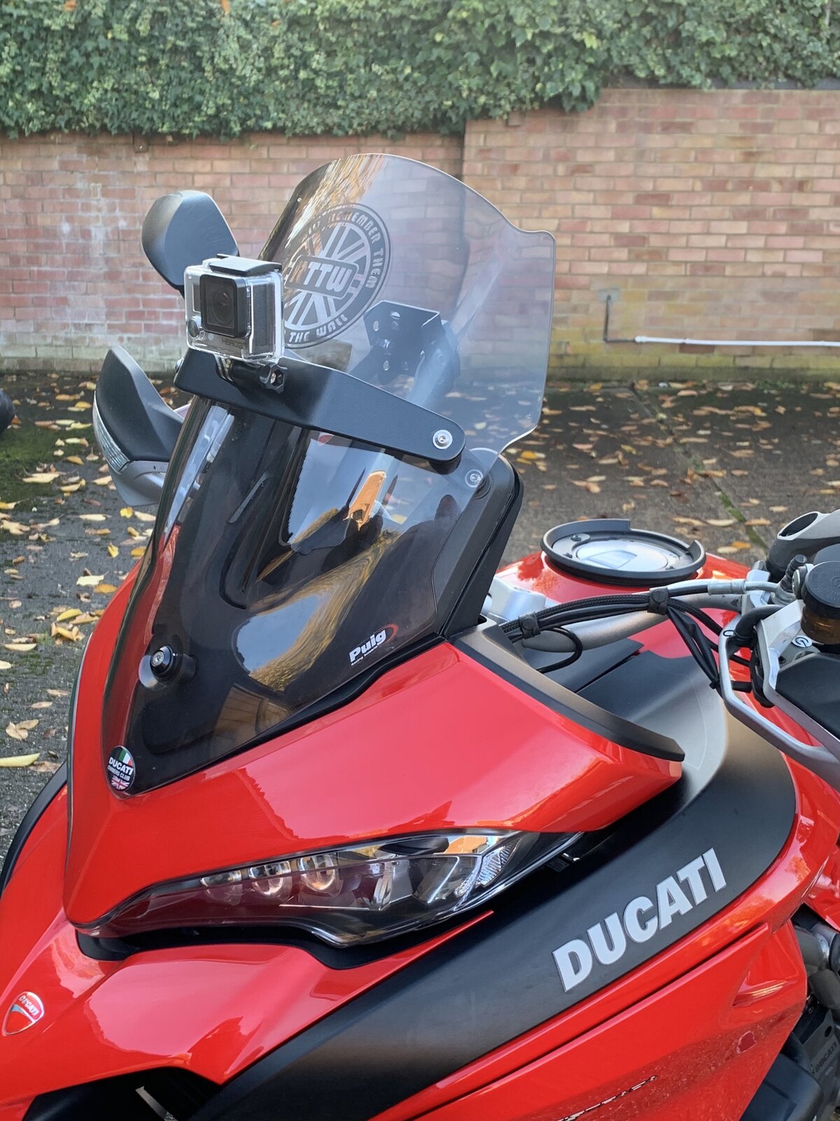

  14. This is mine.....holder from eBay, just bent it so it’s straight, clears screen on full lock as well

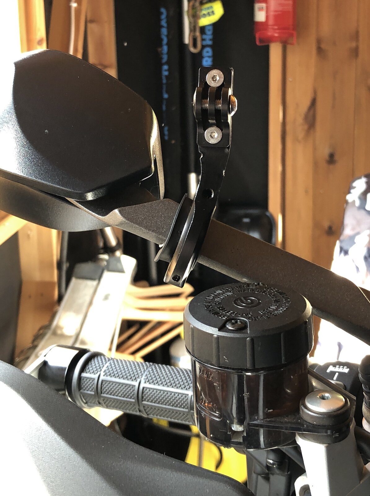

  17. I bought a longer 10mm bolt and fitted it to the mirror attachment, perfect for me.
