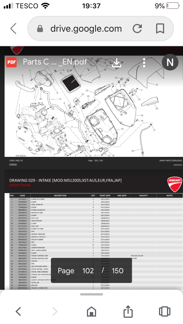

  10. Can you remember where thats is about on the bike
  11. Different on DVT compared to 2011. I’ll see if I can find pic.
  12. Here’s a pic from parts manual. Item 14 in pic. Pre DVT has 2 so look at the parts manual in forum pages to check if there are 2 on DVT.
