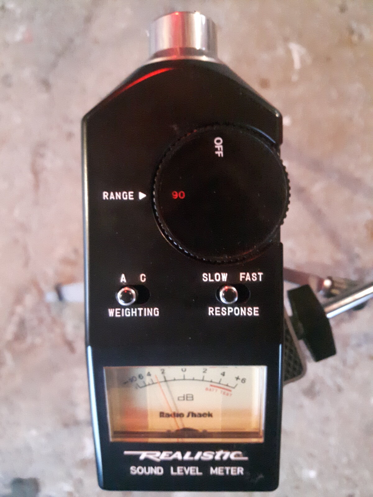

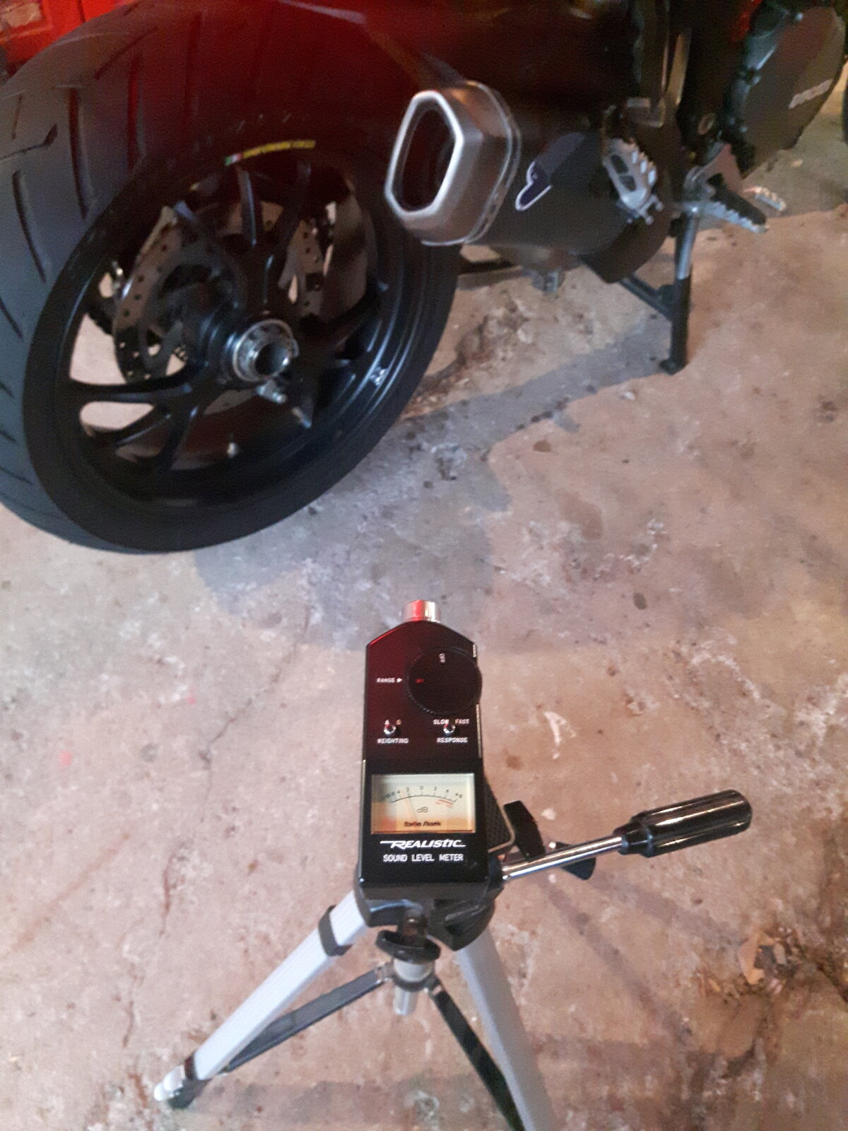

    Using the SAE J2825 methodology: the decibels are measured at an angle of 45°, same height and 20 inches from the exhaust. Idle and 2000 rpm (for a twin) and preferably in an area without resonance. For example, a stock 1260 Pikes Peak obtained the following reading with my Radio Shack Decibel Meter as shown:
    87 db at idle
    About 90db at 2000 rpm.
    No sound meter? No worries, there's many sound meter apps available for both Android and iPhone.
    For your convenience, I previously calibrated the (3) free apps on my android phone to coincide with my analogue sound meter as follows:
    Sound Meter app: +10 db
    Decibel Meter app: +14 db
    Decibel X app +2 db
    State what system you have installed: Cat-less, Slip-on, Full Sys, Make, Model etc.
    Keep in mind that deviation from SAE J2825 will substantially alter your results.
    The devil is in the details.
