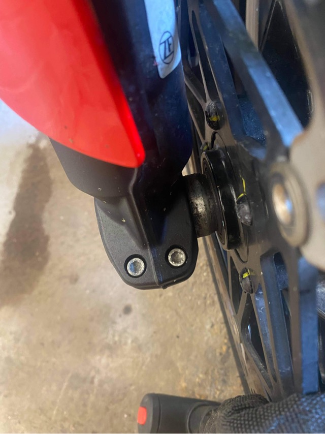

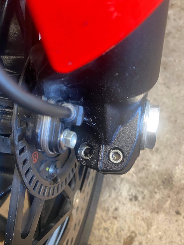

  1. I took the bike for a new set of tyres today but they were unable to remove one of the front axle pinch bolts.
    I only bought the bike in February with 5000 miles I’ve taken it to 7500 so assume it’s the third set to go on, you wouldn’t think a mechanic could wreck the bolts so quickly.
    quite a few of the other fasteners seem to be knackered too it’s a one previous owner that was less than three years old from a main dealer.
  2. Not a good sign, overtightened pinch bolts could crack the bottom of the fork legs. IIRC it’s about 12nm torque setting here. You also mentioned other bolts are damaged, did the same servicing dealership also change the tyres?
  3. Mine are fitted from the bottom. In fact I thought only the top half of the clamp was threaded anyway. I am thinking if yours have gone in from teh top, they are not actually clamping anything? UNLESS a rock ape stripped the correct threads and added some additional ones in the wrong end?
  4. I strongly suggest torque values on the most important fastenings are double checked, if the front fork pinch bolts are over tightening the lower fork legs can crack, the rear wheel nut from memory has a torque setting around 230nm, which is very tight, it doesn’t look as though much care has been applied by whoever has been let loose on the bike, but some of the settings are safety critical, so would advise a proper check of all the components that are touched in tyre changes are looked at. It is not normal to have all the bolts rounded off.
  5. Depends which forks you have as to which way the screws fit. If the screws go in from the top, removing the front wheel speed sensor helps getting to the inner one on the left fork. If you try with a ball end, or such like, it’ll round. It’s a screw.. try another workshop…

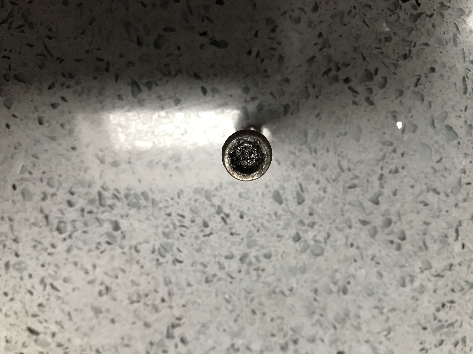

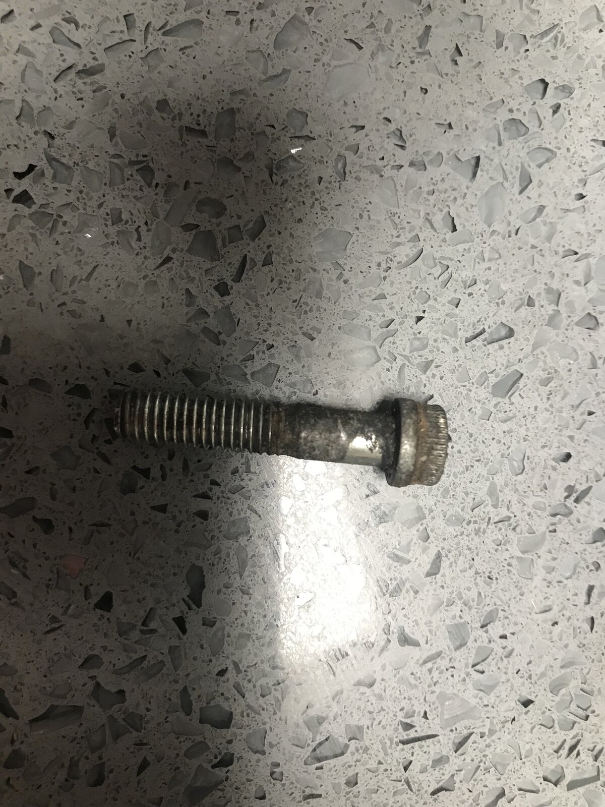

    • WTF WTF x 1
  7. Hi Nelly can you recommend the correct part numbers to replace all the pinch bolts ?
  8. Yours look in terrible condition anyway and they are made from the usual Ducati cheese, so ultimately bound to fail.
