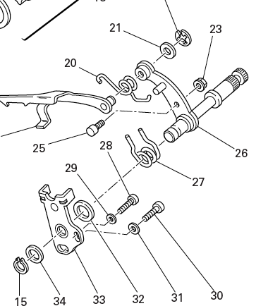

  3. Here's a picture from the parts list. It is item 27.

  6. Number 20 is also prone to breaking. Both have been superseded in recent times. If you're going to the trouble of doing one, it's worth replacing both with the latest parts.
  7. Good tip .thanks Nelly.
