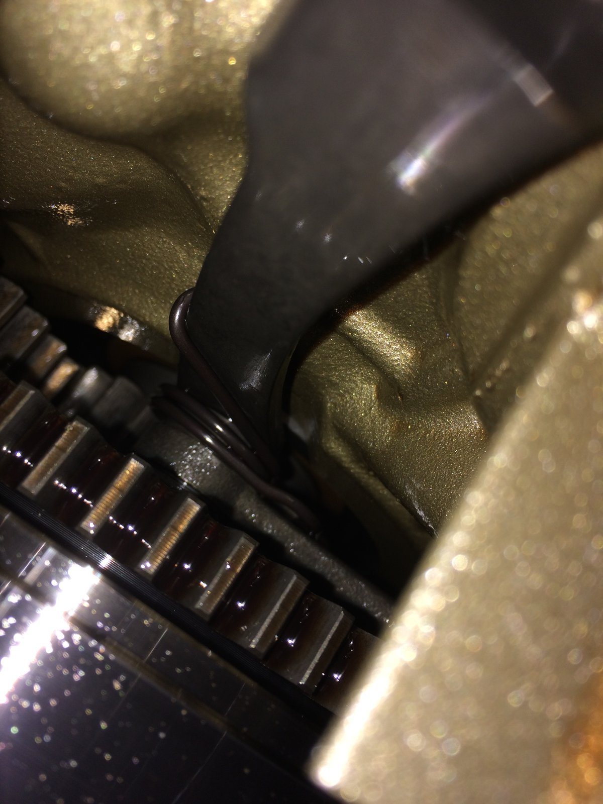

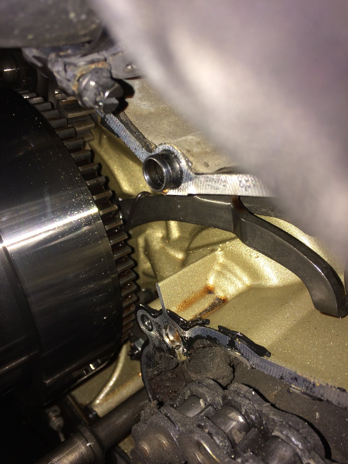

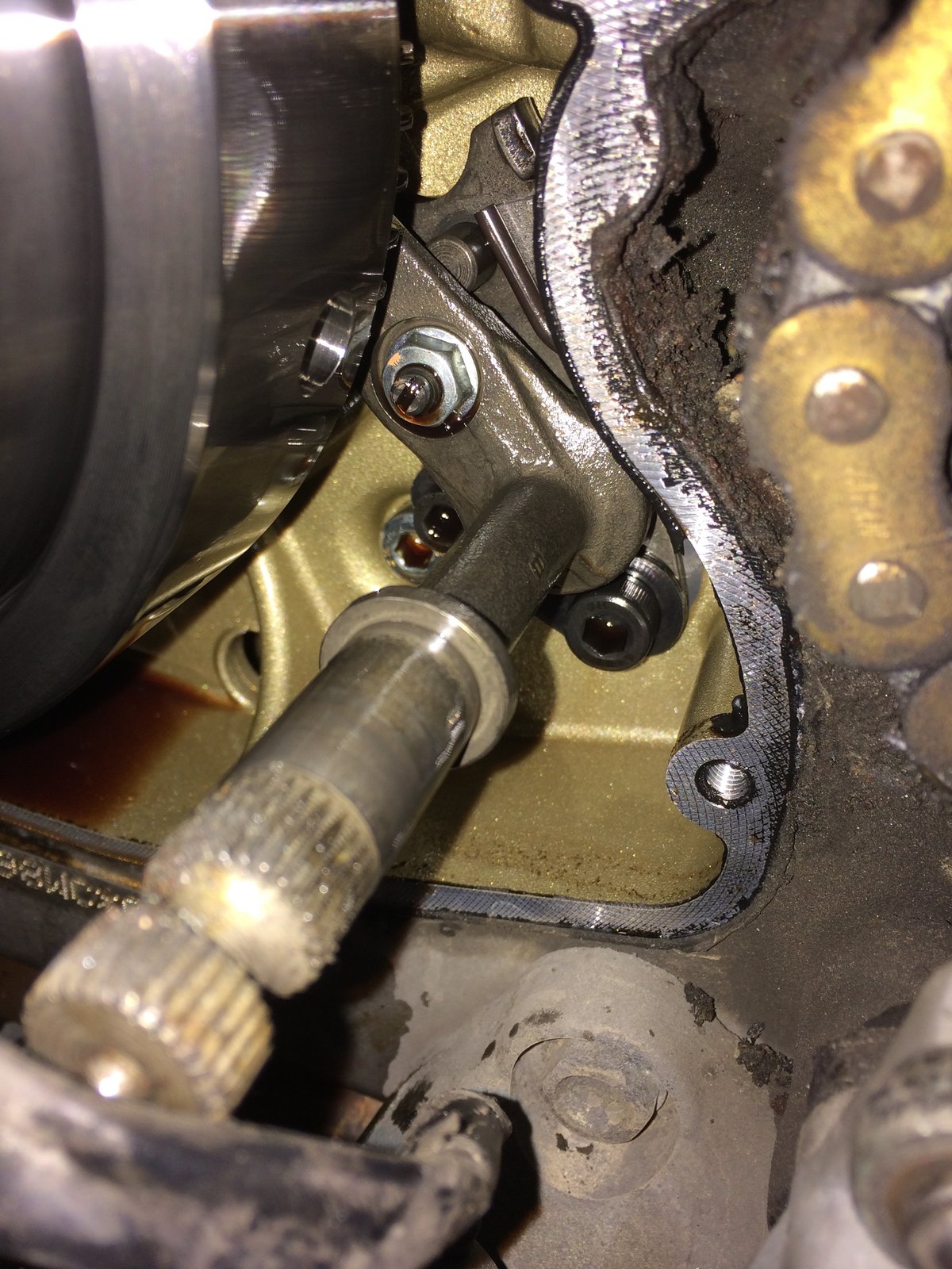

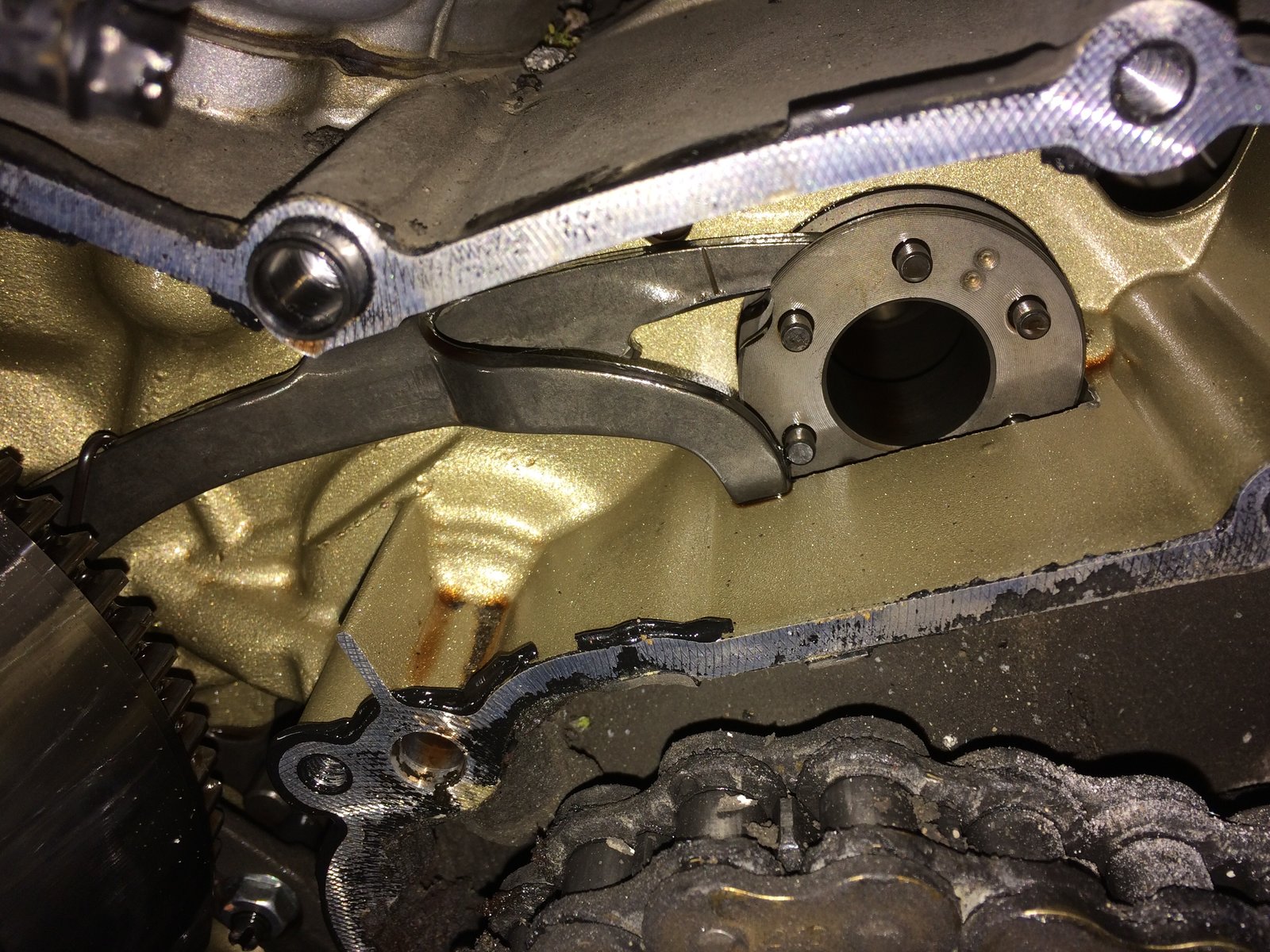

  11. My Alternator puller arrived on Saturday, I got the cover off and can see that the selector fork is stuck fast against one of the pins on the selector drum.
    It doesn't look like the spring is broke but until my flywheel holder arrives I can't investigate any further.
    Snell (Ducati Alton) have been very helpful on the phone, I will give them a ring today and see what they think from what I can see.
    Did I say I'm meant to be going to Europe on 8th June? :worried:

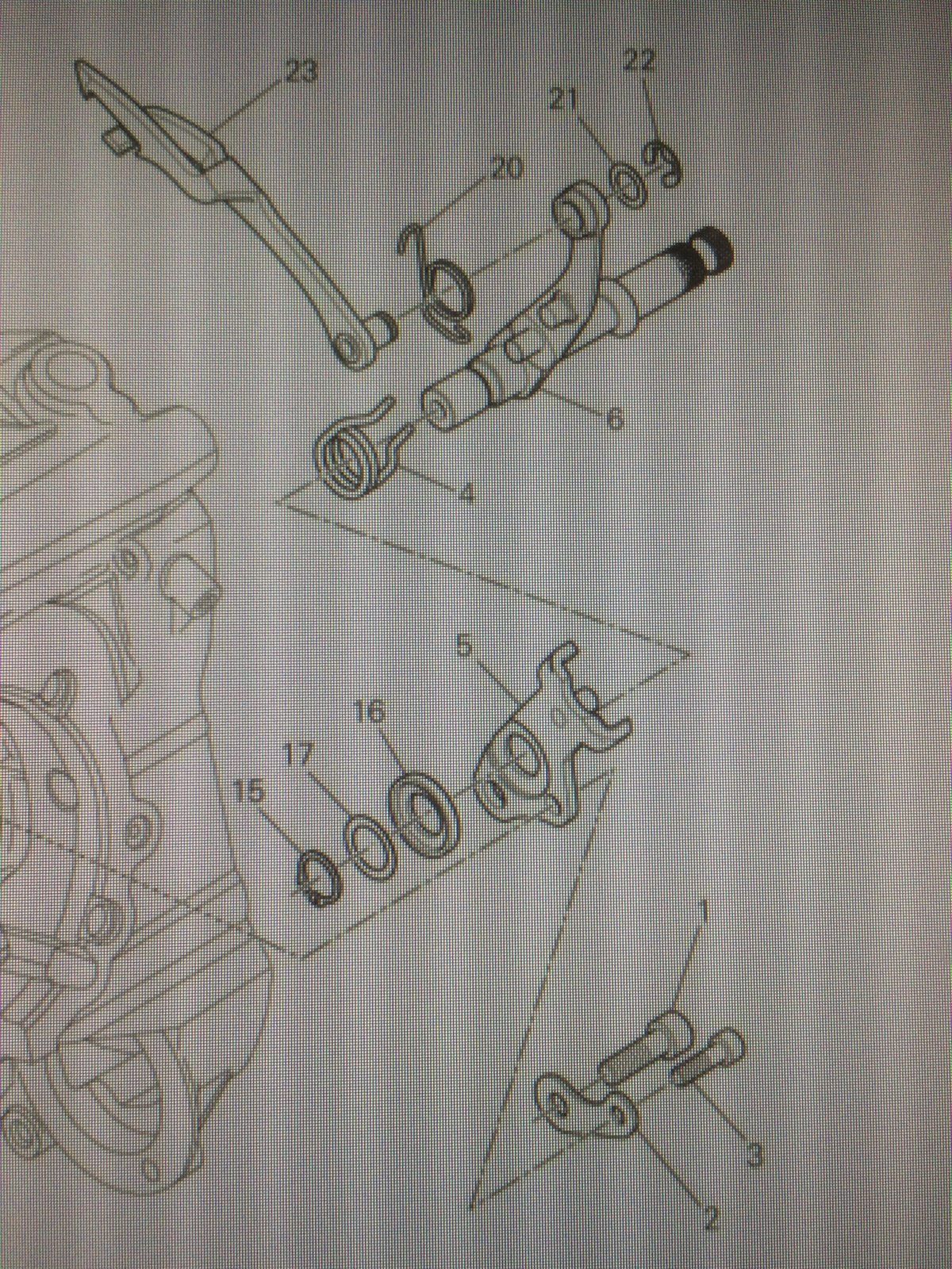

  12. Amazing pictures, can only help people in future with a similar problem. If I have the right mechanism, you are probably right to be looking down the back of the flywheel (as best you can at the moment!). The design is certainly different to earlier models, and it could be that the circlip (item 22 below) has managed to pop off and allow the control fork to move towards the engine.

  14. Hi there its normally the bigger spring that breaks no.4 in your pic. and causes this issue good luck thats hope its not internal

  15. Correct item 4 (spring) has been known to break and cause issues, I think someone in the States does a stronger spring as a mod

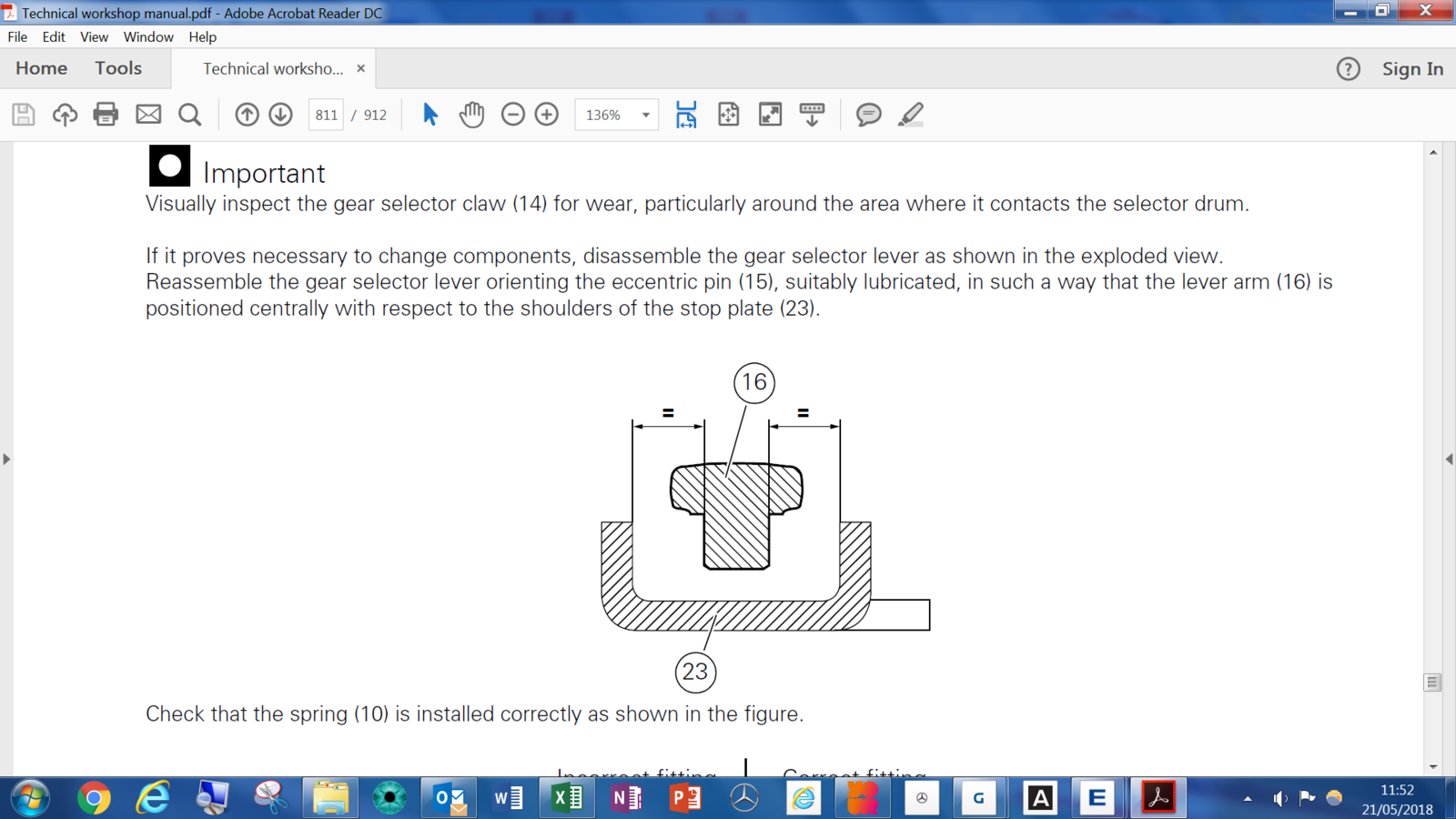

    You also need to get the adjustment correct on item 5 when you rebuild, it needs to have the correct equal clearance on the arm (item 6) so you get correct gear shift operation up and down
    It describes this in the workshop manual, ill try and find the link
  16. Found it
