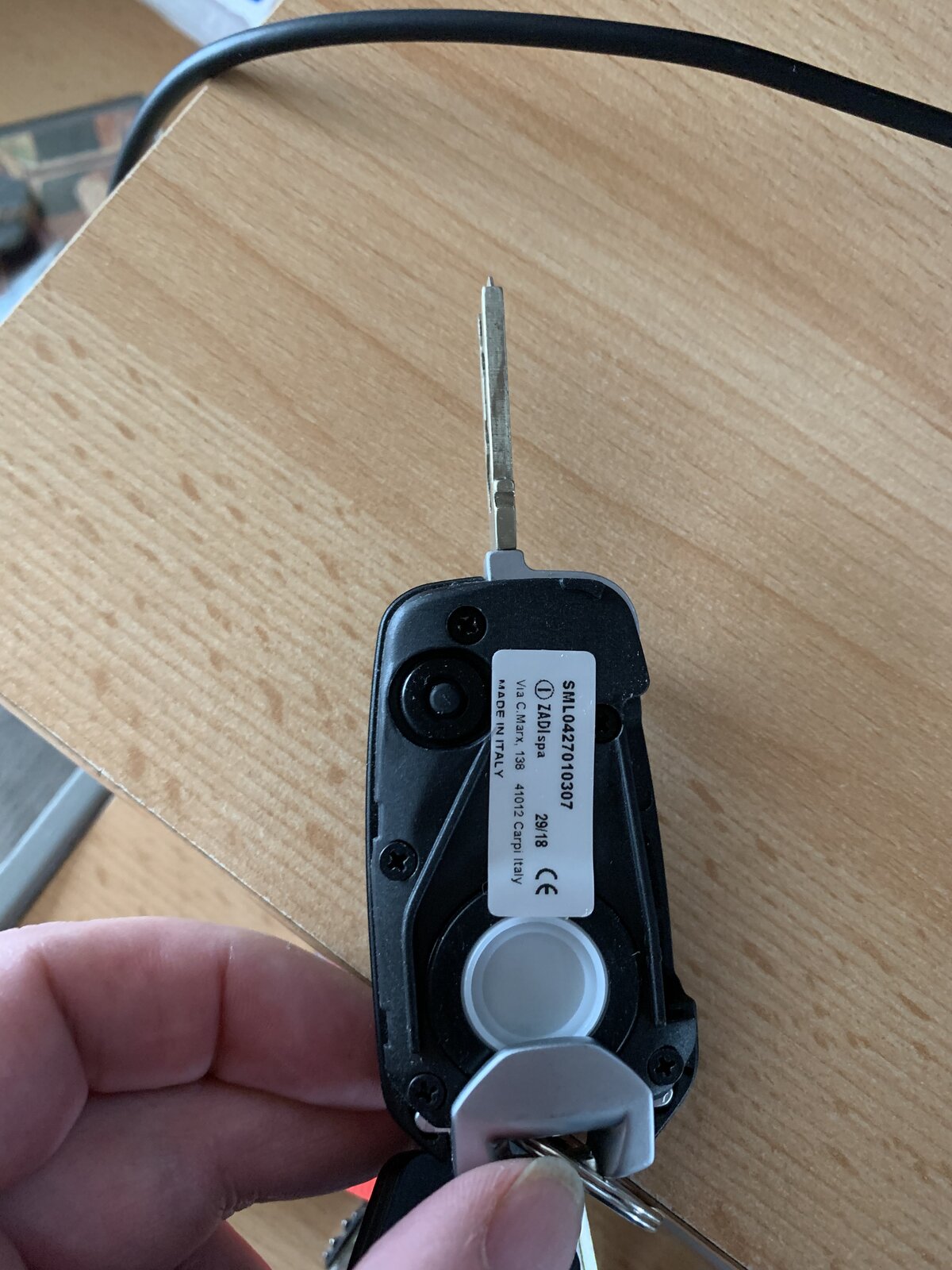

  14. My dealer has done the key recall, but the key looks no different, and when I open it up, there is no reset button visible
    Can someone confirm that there's is different after the update
  15. Key looks like this
  16. Make sure you add your own PIN code / procedure under the ignition cover lark. Very handy if you ride off wearing a jacket which hasn't got you're keys in..
  17. Mine looks nothing like that, thanks for posting pic
    Back to the dealer again!
