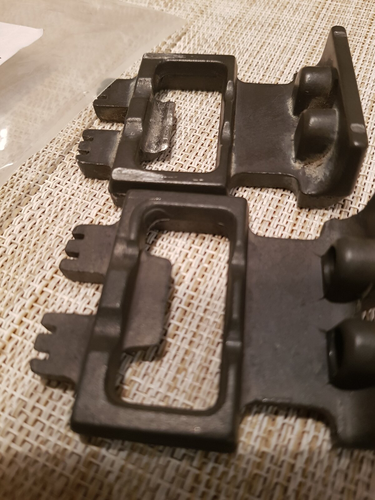

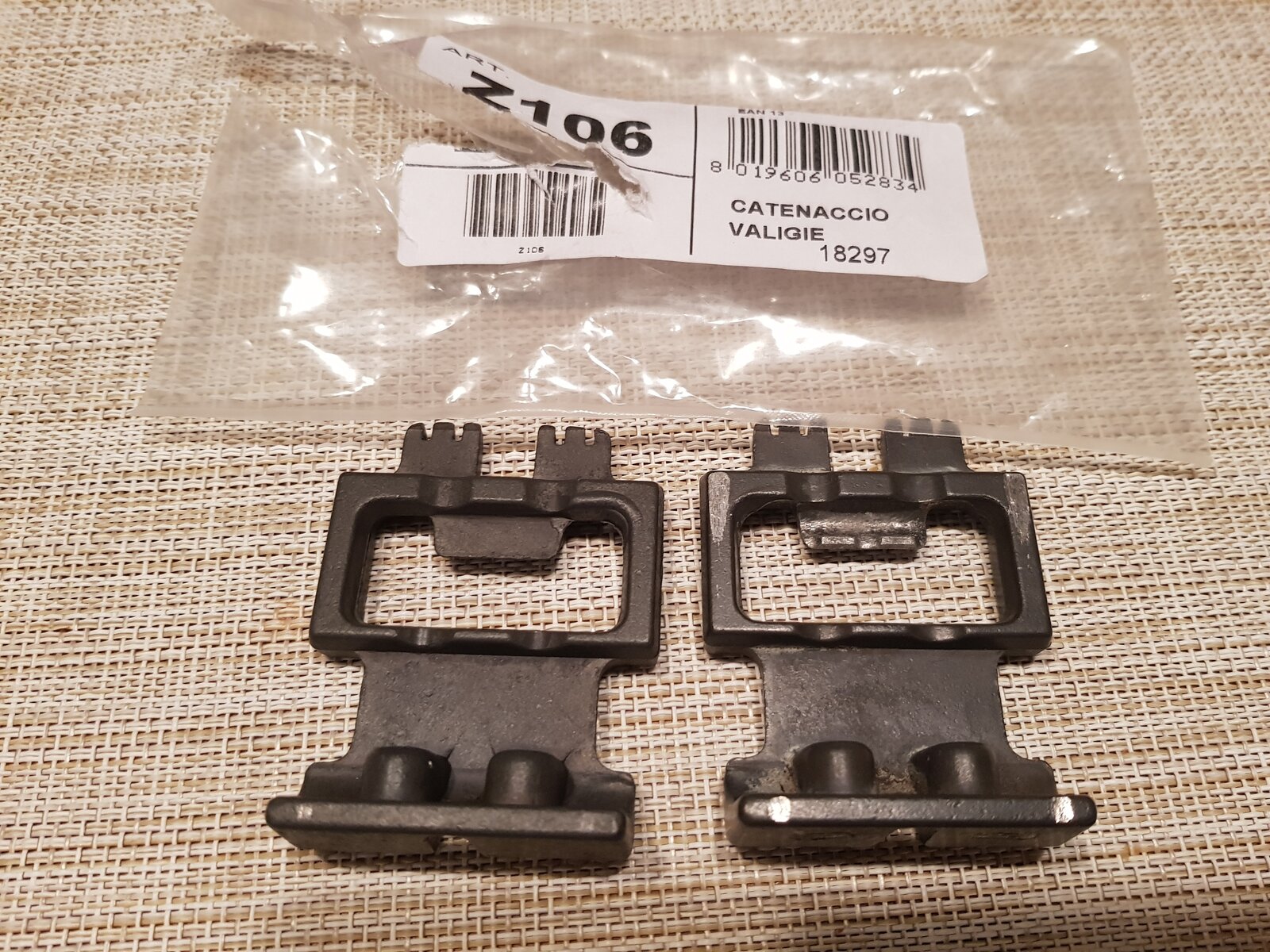

    The metal latch looked fine, but showed a little wear (or so I thought).
    Ducati don't offer any spare parts for these, so I went on a trawl of the givi parts diagrams. It turns out pretty much all the parts are standard givi parts from other boxes.
    The metal latch looked the same as givi part Z106, so I bought one, and am pleased to say it is the right part and an easy swap.
    Pictures below of old and new. Note the wear to the top side of the latch.
    Hopefully this info will help someone with a similar rattly topbox :)

  2. I take it the one on the left is the original but if it is wear on the Right hand one, I am surprised it worked in the first place, they look completely different
  3. yes agree they look totally different, why have you left your top box on for so long? That is the question?:p
  4. Yes, its wear on the right hand one.
    Basically the base plate is made of nylon, and the upstand where the latch goes into is hollow, not solid. Therefore the edge of the plastic upstand wears the face of the latch tongue. Hope that makes sense ?
    That consequently means there is a bit of play between the edge of the plastic upstand and the now worn down latch.
    I do agree they look slightly different, in that the latch ramp on the left one comes to a point, and its squared off on the older one. It fits in the box though and works ok.

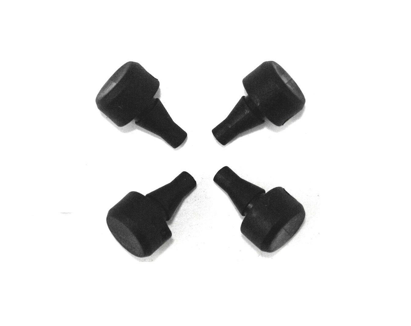

    I did replaced the 4 rubber grommets in the top case rack (Givi part number Z126) as I thought the case was rocking too much and it helped resolve this problem. I paid the princely sum of £2.99 (with free delivery) back in March but they seem to to be a bit more expensive now (e.g. £4.45 on Amazon, from one supplier).
