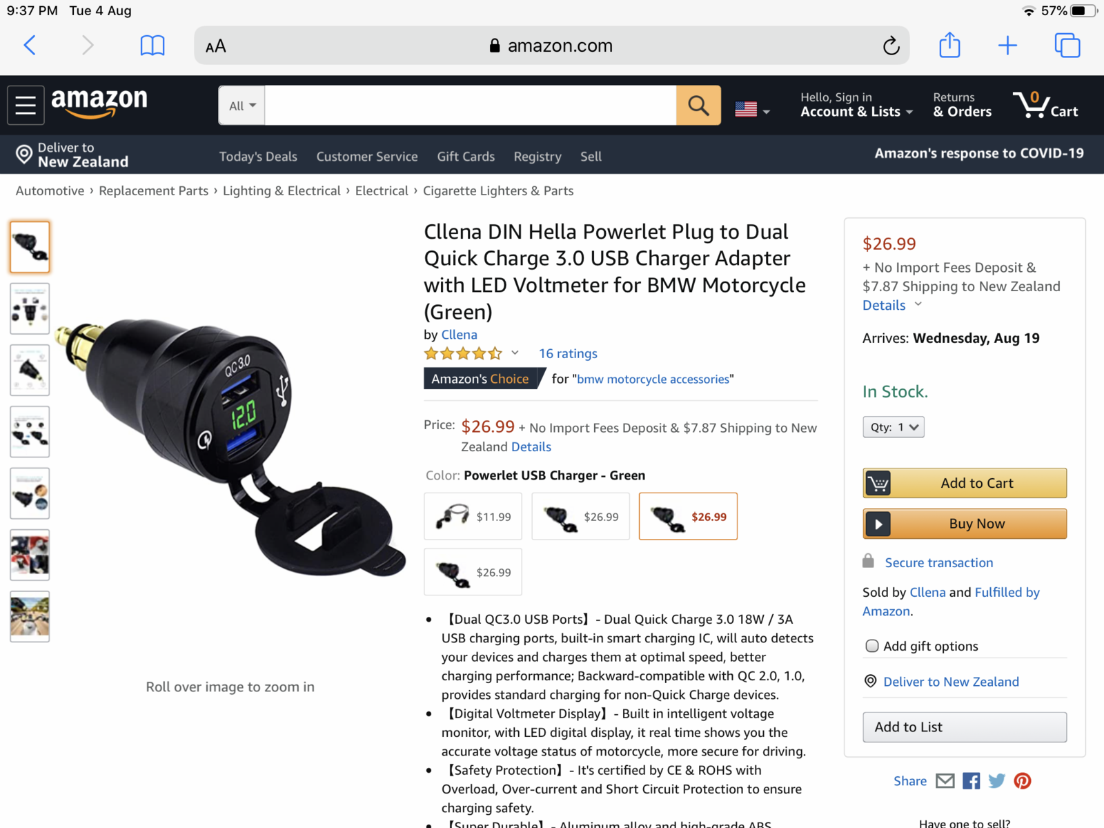

  1. As above, my search yielded nothing, is the power outlet plug a european only thing? Does it have a type, as in a name for the fitting. Thanks in advance...Al:upyeah::)
  2. Standard din one, like bmw
  3. Cool! Thanks guys!
  4. 4D194417-C4D7-40BC-B683-D982462367CF.png Yep, I saw that but you can buy the same thing that also just plugs into the din socket as well. It sticks out a bit but meh and you just remove it at night so it doesn't continually draw down on power. My mates XR1000 seems to be powered up all the time but I haven't checked my multi yet...
