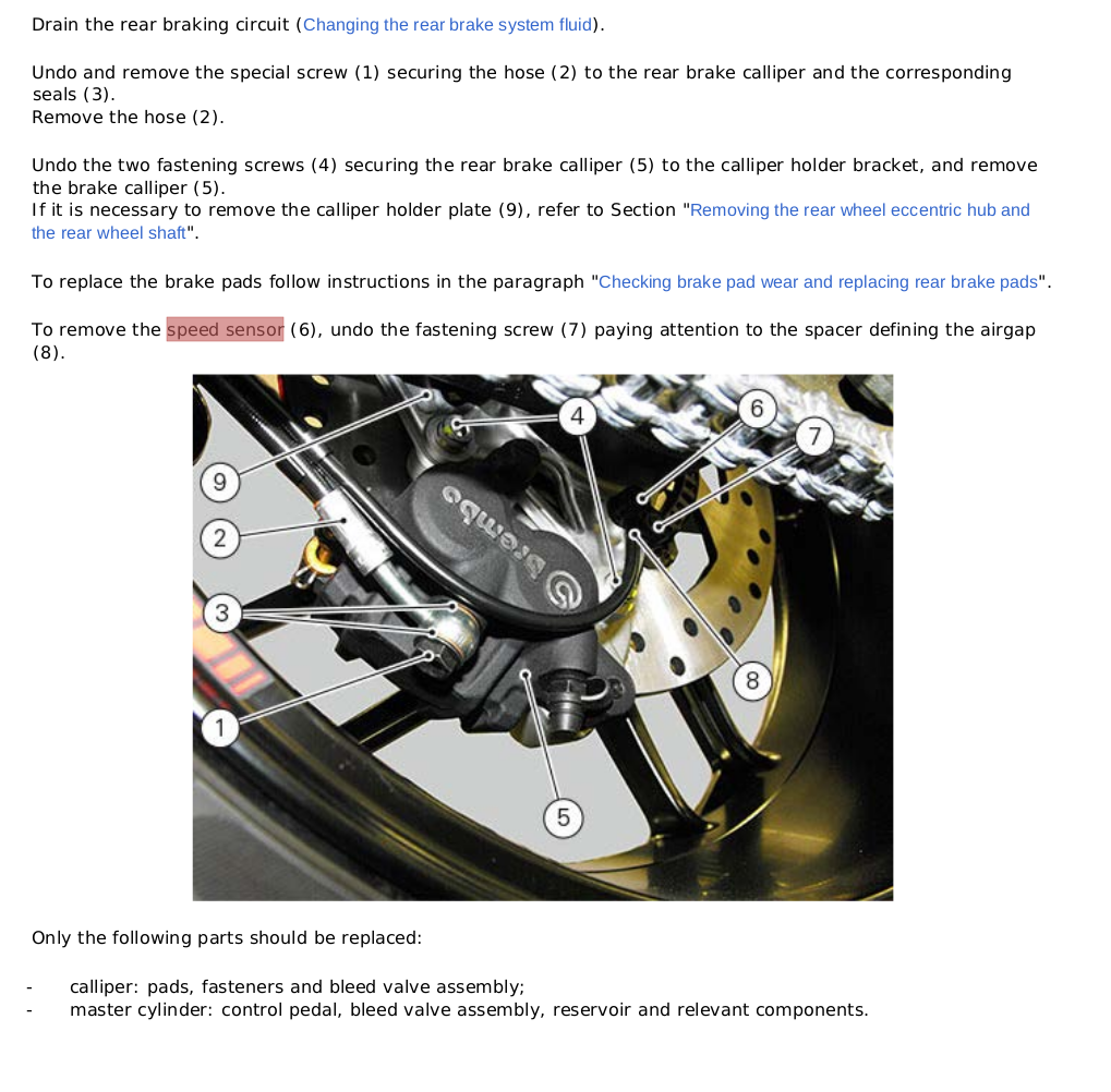

  11. Speed sensor is read from the rear wheel as show on page 544 of the service manual. Screenshot attached.

  13. That's for the ABS, doesn't mean it feeds the speedometer ... though it might I suppose.

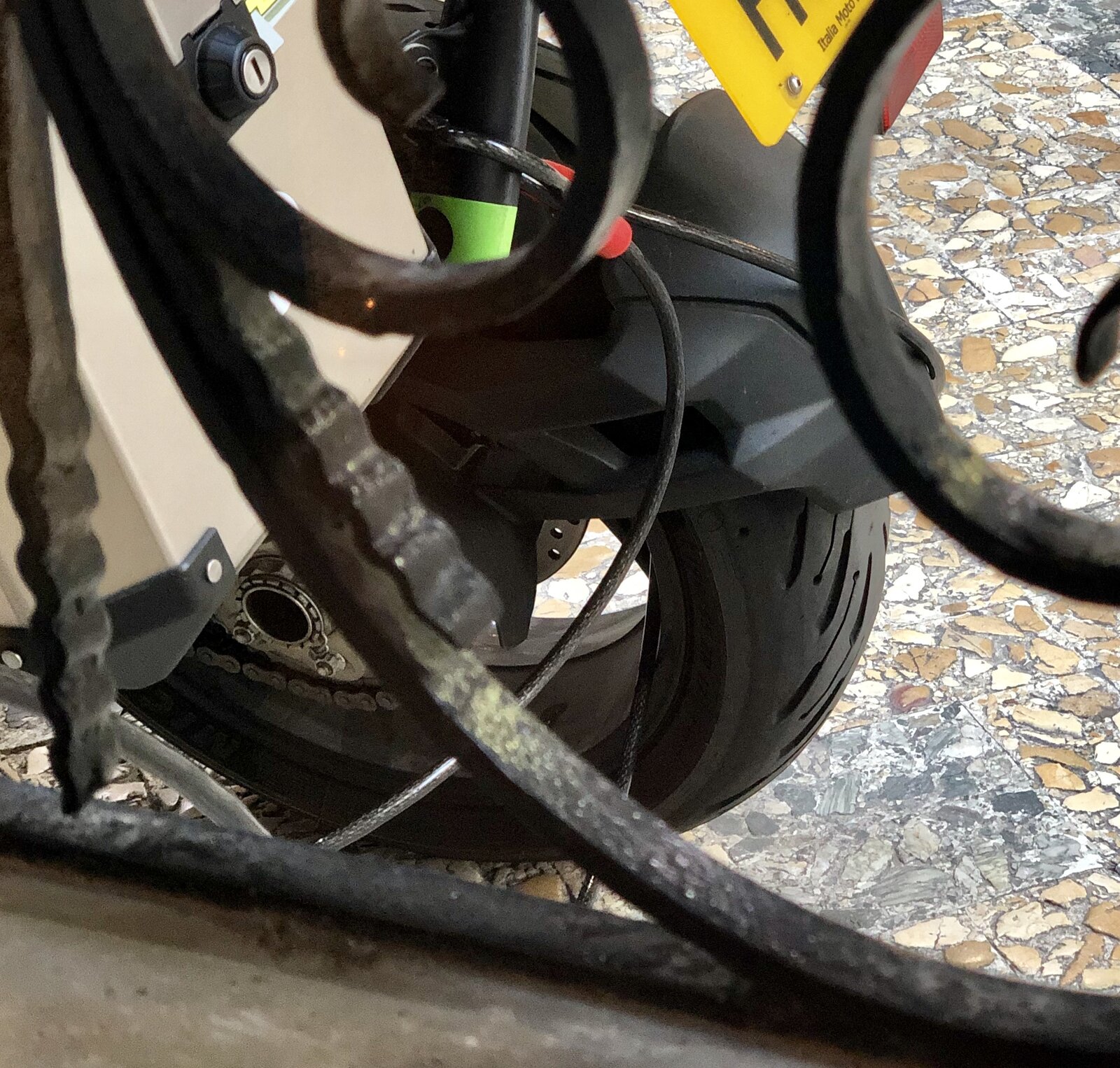

  14. My mate is running PR5's on his 1260 and the chain hits the edge of the tyre
  15. My 1260 does that to my Road 5s too. Right on the very edge.
  16. Any photos?
  17. No but out on the bike tomorrow so will try to remember to oblige.

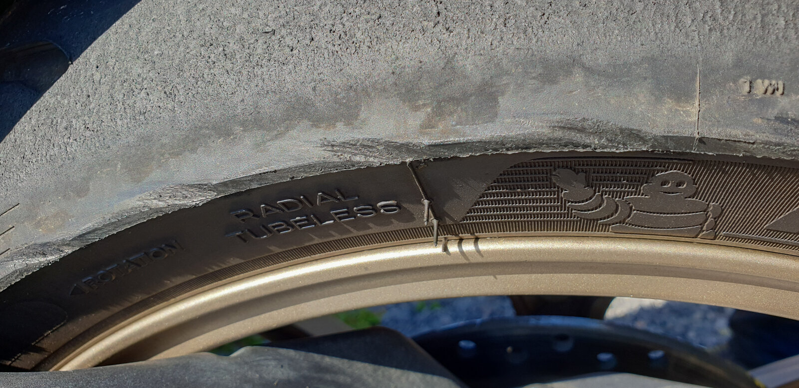

  18. About 3,000 miles into my Road 5’s.
    I like them. Have built up decent trust in them and they seem to wear OK. Good in all conditions so far; hot, cold, wet and dry.
  19. You can see the regular saw-tooth type cuts in the widest part of the tyre.
  20. Hellfire. That’s not right at all is it.
