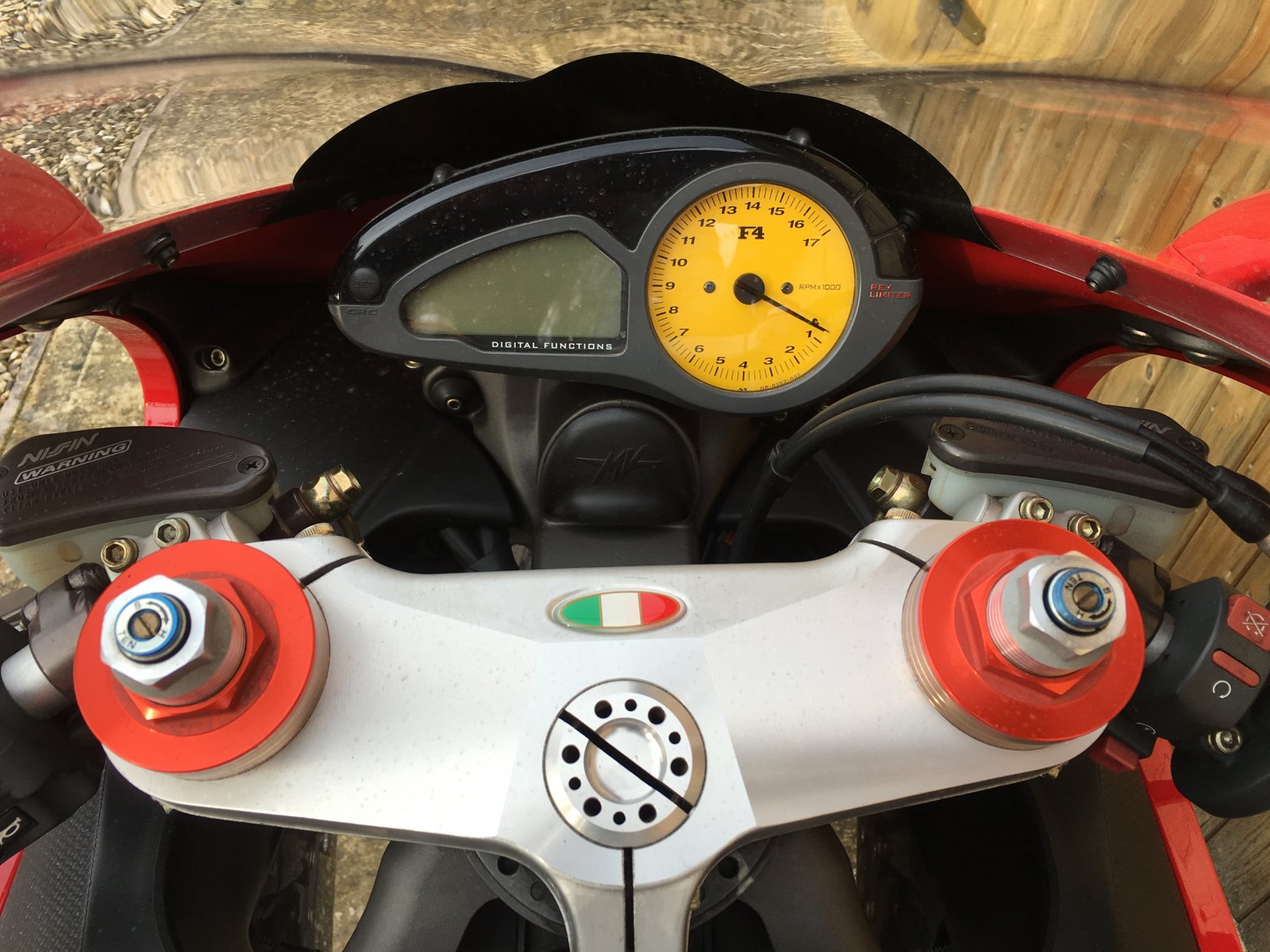

    Comfort wise I have a set of bars that are adjustable the clamp on the fork leg is like rose joint so can be minutely adjusted.

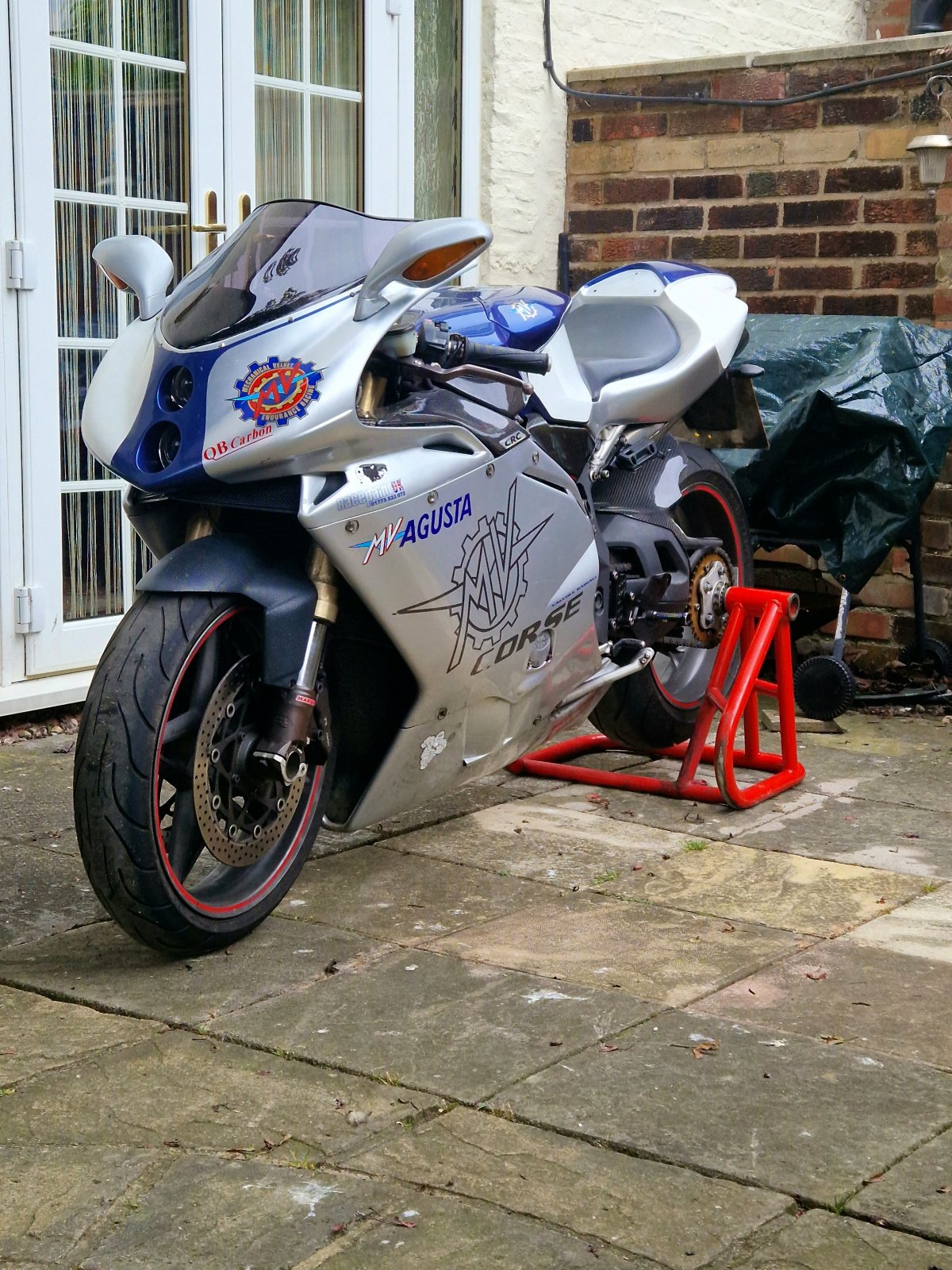

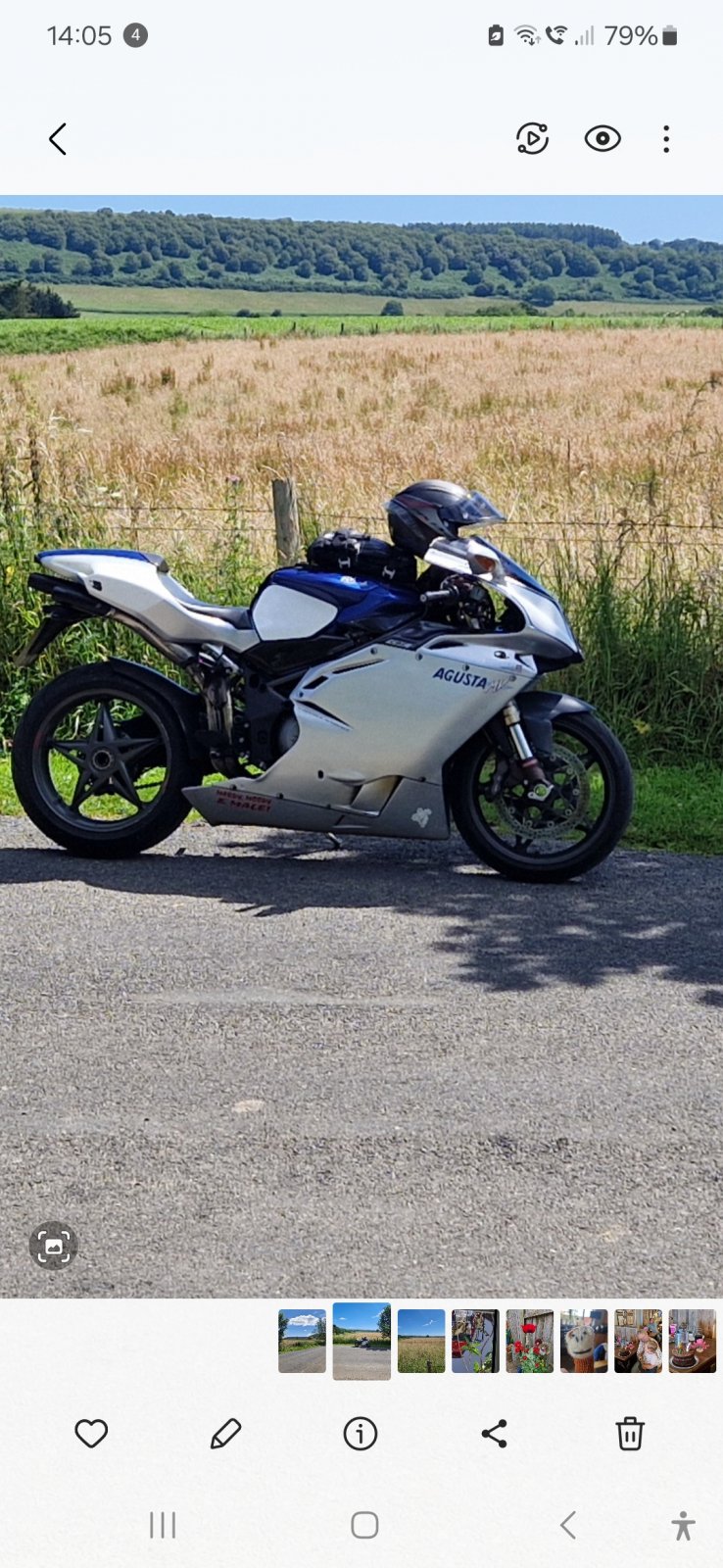

  5. Mine is Evo2, 2002 model year
    They switched to the 1000 in 2005
    The first ones had a single radiator and suffered from overheating evo 2&3 have 2 radiators still get hot though
    I bought an SPR engine a few years ago and fitted that more power close ratio gearbox
