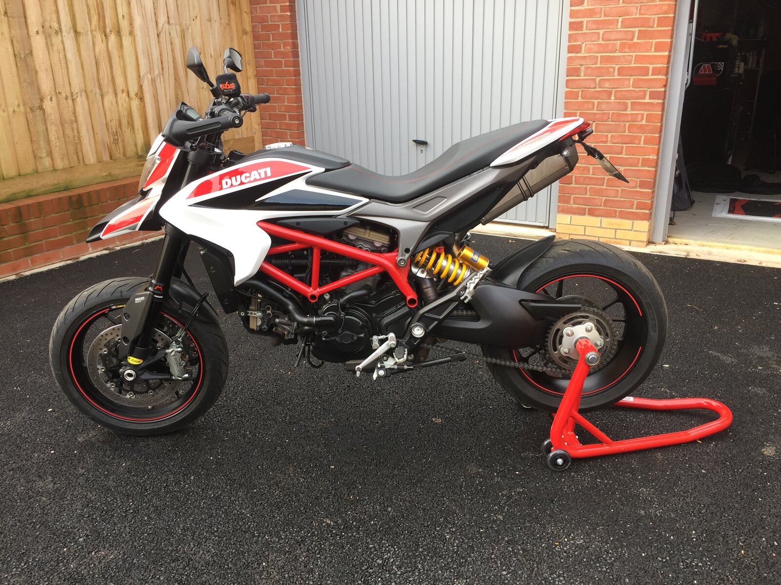

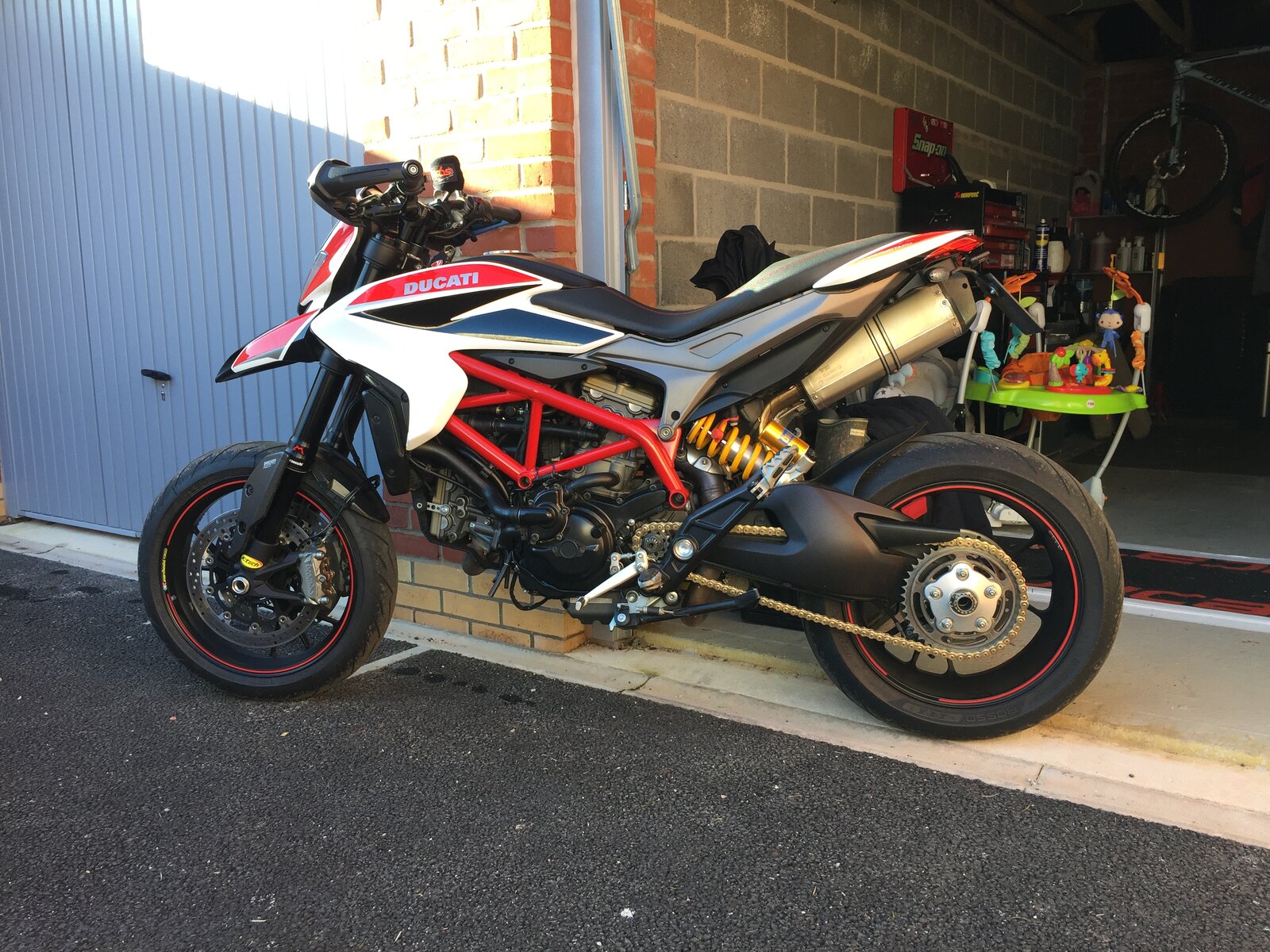

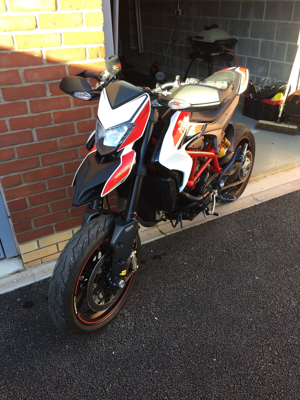

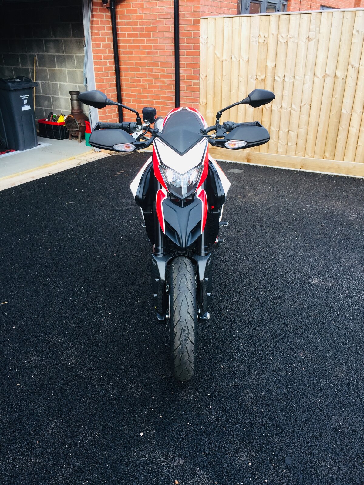

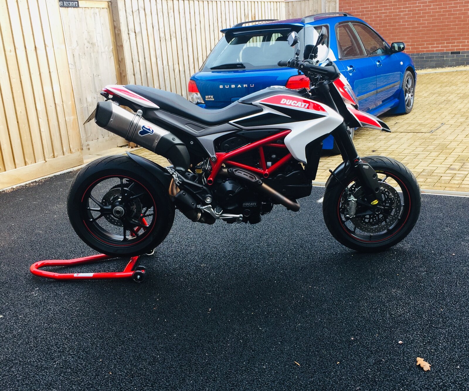

  1. Bought from Moto Rapido a couple months ago now. Managed to get out on it once and covered 34 miles before I decided I wasn't enjoying it.. the clutch is awful (not slipping), just absolute guff! Reading into it this is a common issue and the 939 clutch upgrade will be going on this winter.
    The gearing feels a bit wimpy, anyone toyed with the gearing? I thought this was meant to be a hooligan bike. Can't see much on here about people trying out different setups.. also no one does a 520 setup??
    Hopefully when the two tweaks sorted, I'll be a happy camper :cool:
    Looks decent though :upyeah:

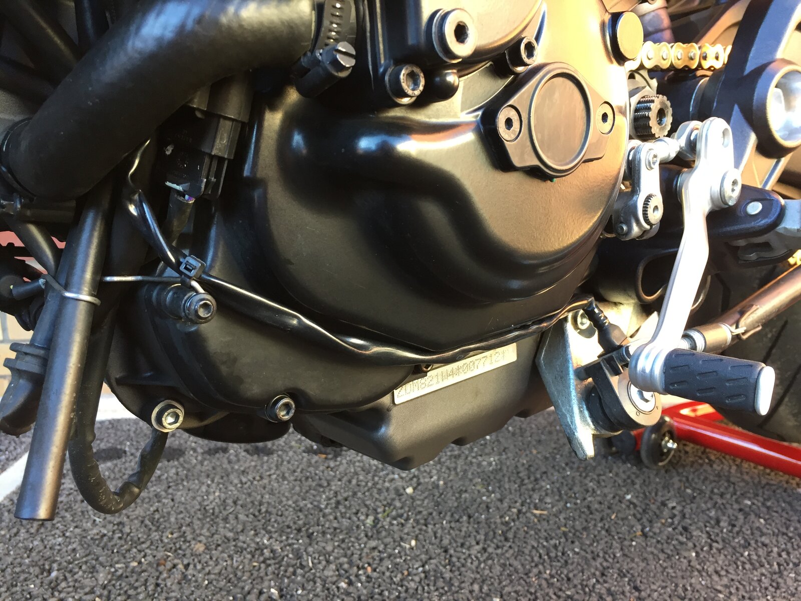

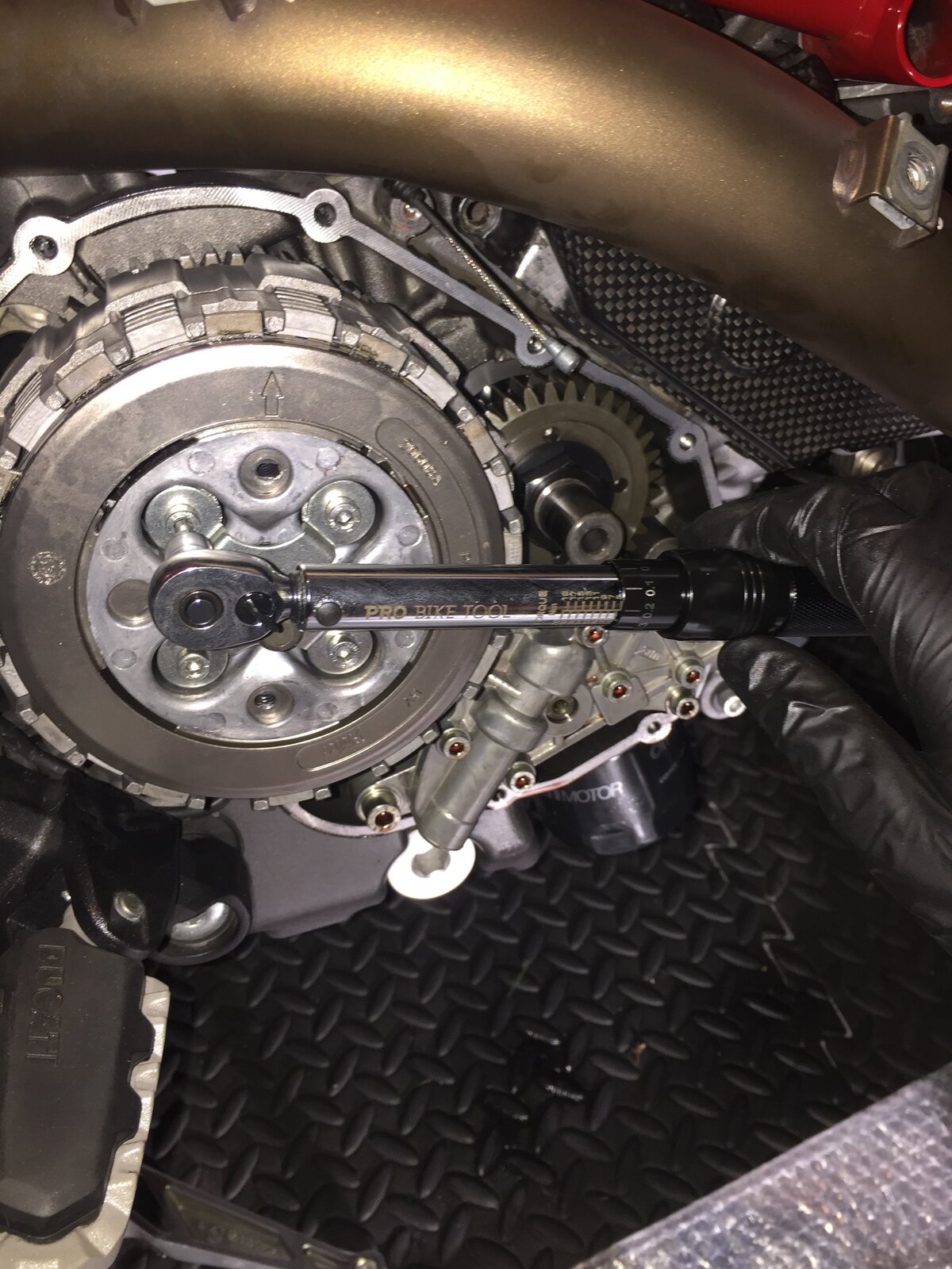

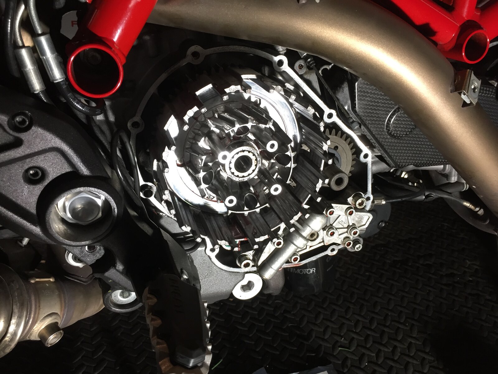

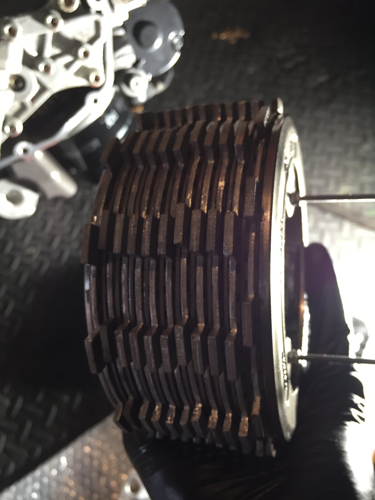

  11. So, as per the 821 clutch mod thread, I fitted a whole new genuine kit with new washers; IMG_4293.JPG
    Clutch pack assembled ready to fit into basket;
    Fitting and torquing up;

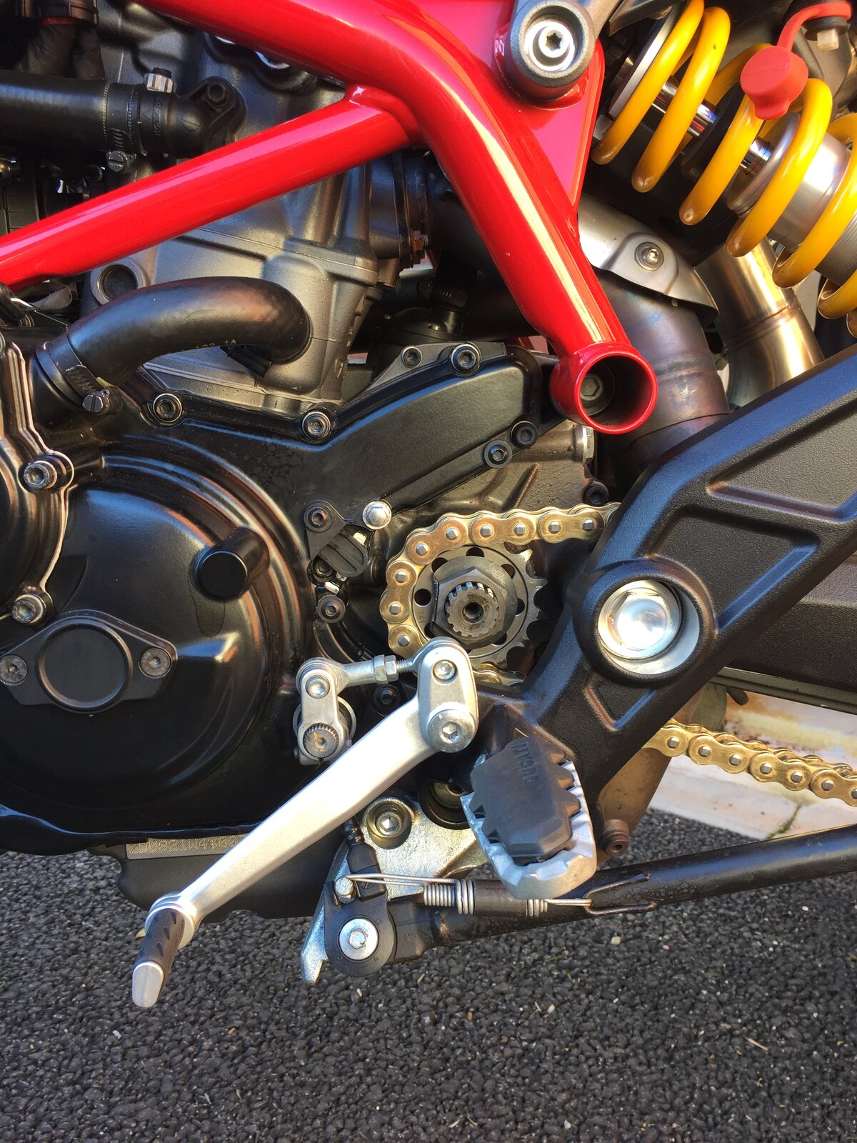

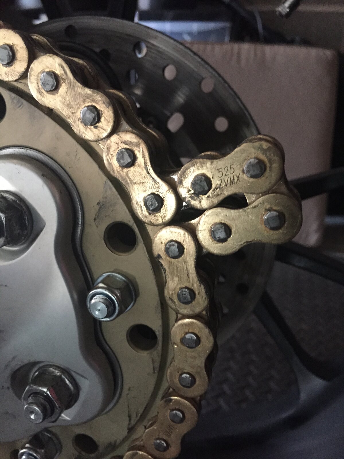

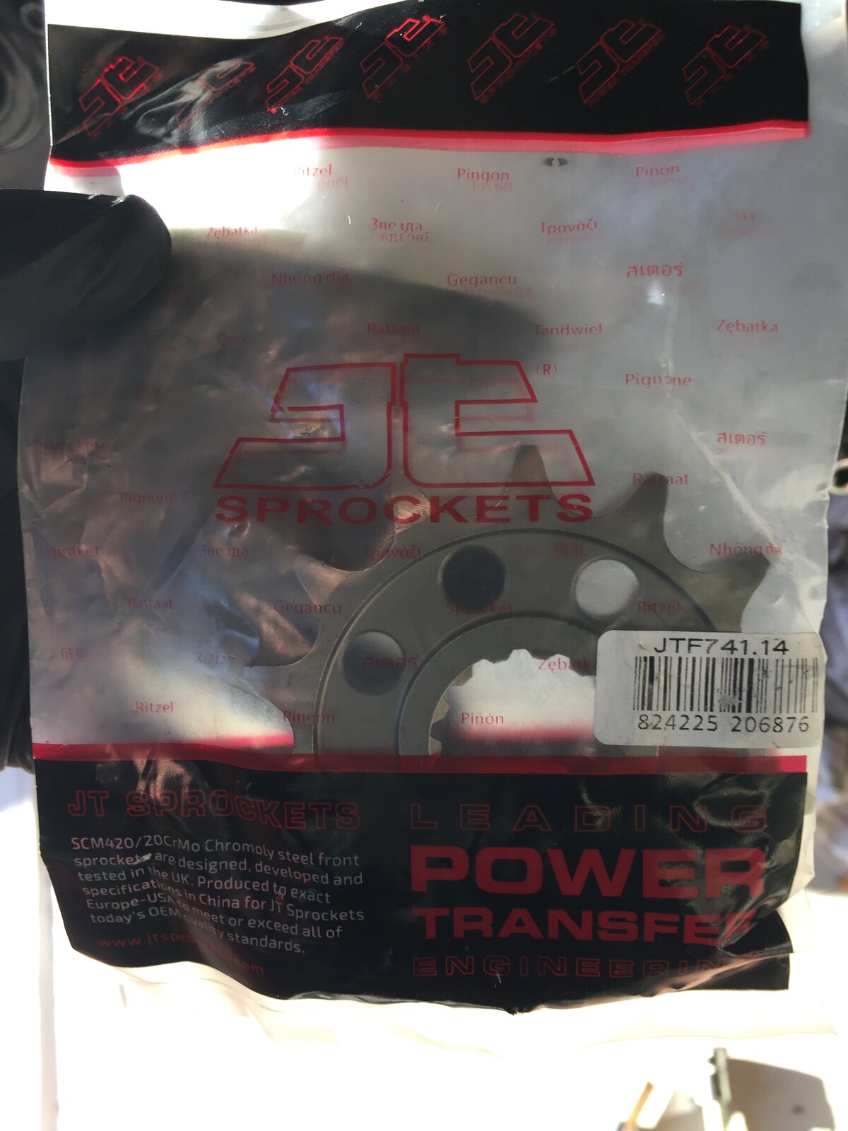

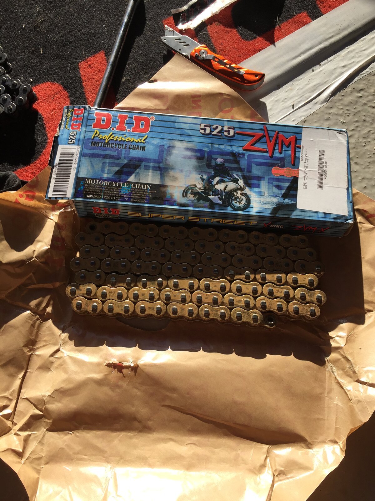

    Today I've fitted these - Gold DID chain and JT 14T front sprocket. For the record, 108 links;

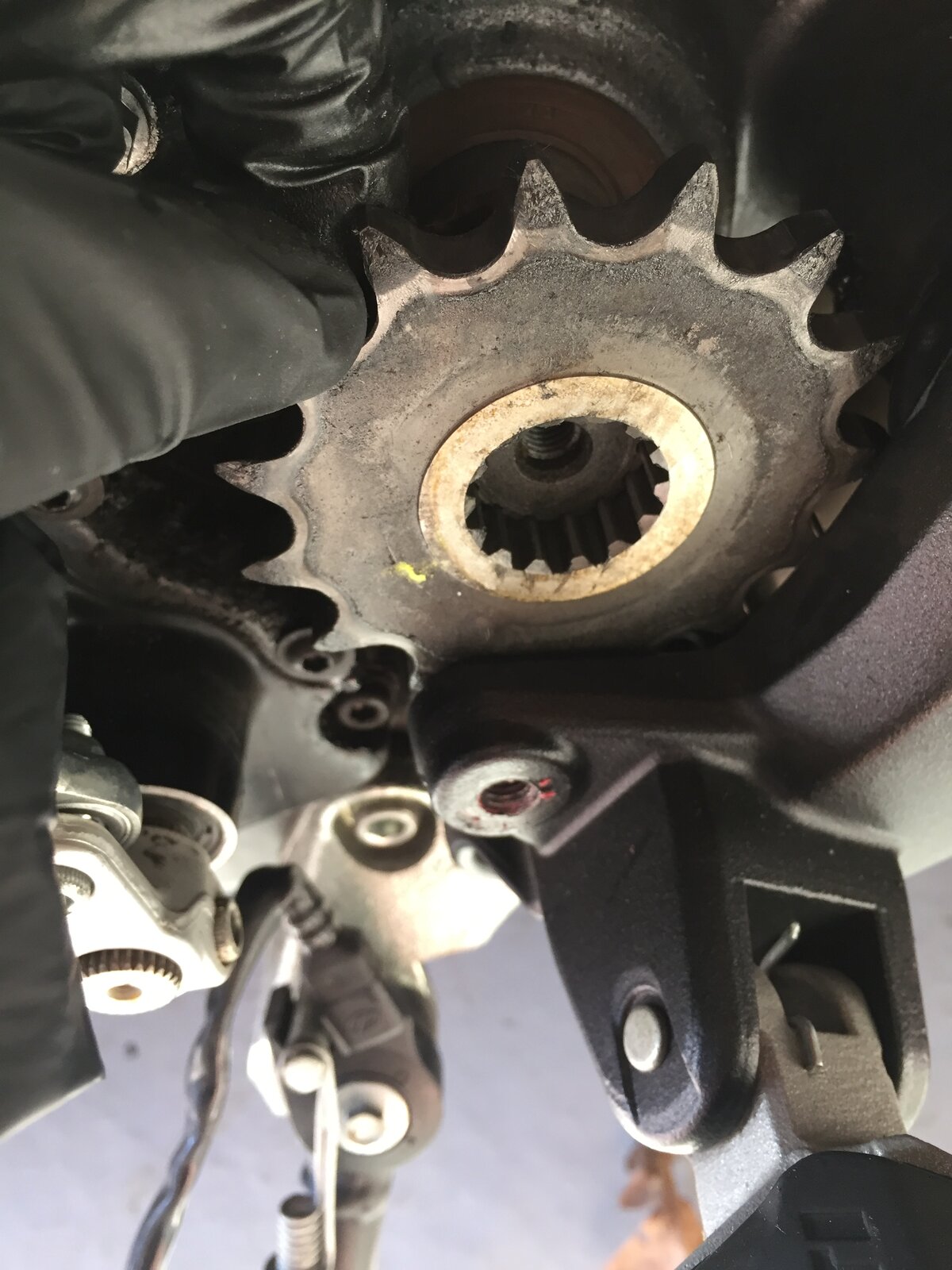

    If you need the JT part number, I've taken a picture here;

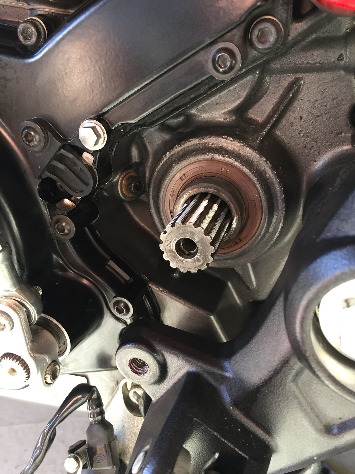

    What a stupid idea Ducati - the foot peg bracket gets in the way of removing the sprocket so you need to loosen (no need to remove totally) the three bolts holding it in place allowing you to move it out the way enough to remove/refit sprocket;
    Cleaned up all the mank around the sprocket area;

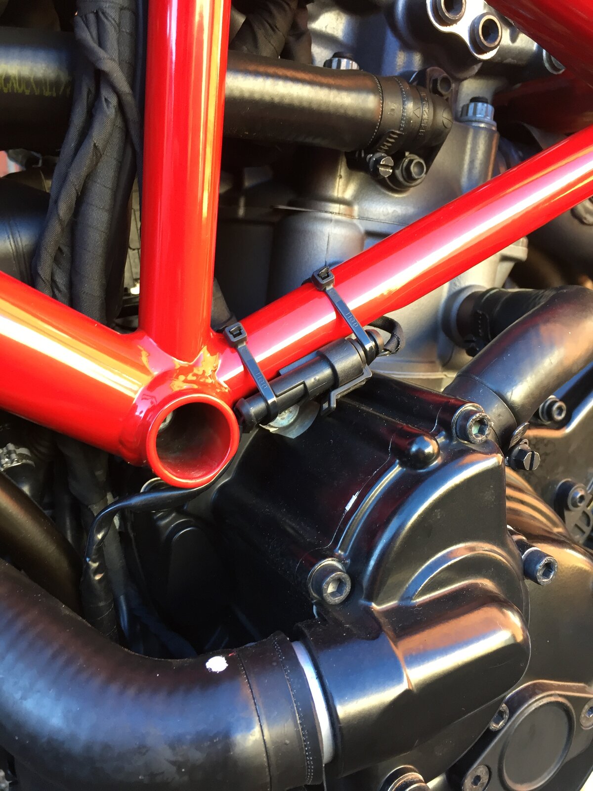

    I also decided to go track look and keep the chain cover off, the only drag to this is you need to re-locate the wiring for the side stand kill switch. It's not perfect but works :)
    All fitted up and chain on and tensioned up. Happy with the results;

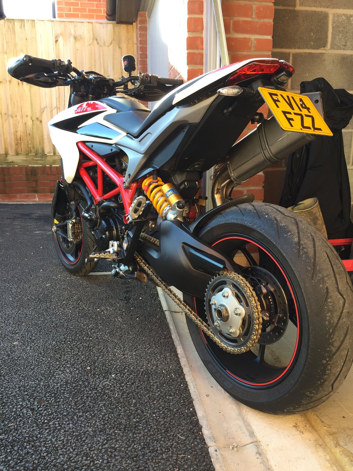

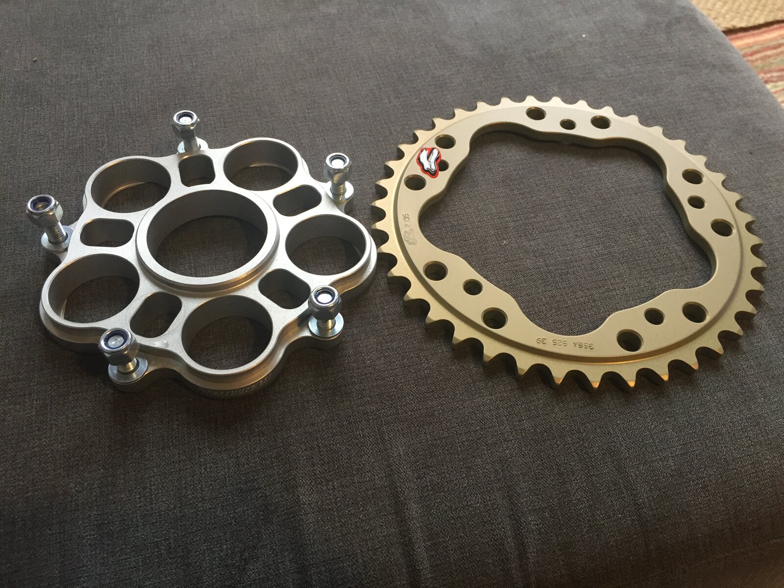

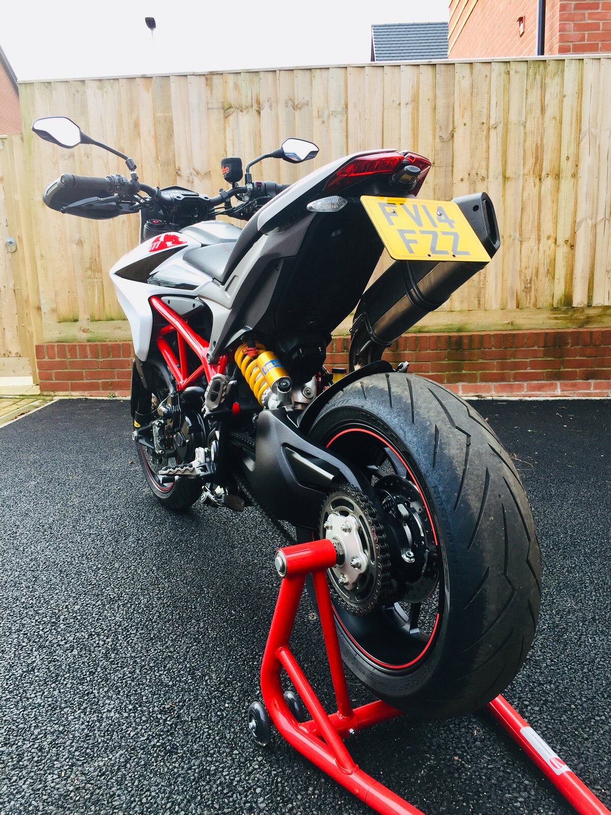

  12. Playing around with the gearing some more, ended up ordering a Renthal quick change carrier, 39T and 42T rear sprocket.
    Tried the 39T but it's a little too long, fitted the 42T and bang on for me, so final set up is 14T front and 42T rear.
    The carrier is brilliant, easy peasy to swap the sprockets over without removing the whole carrier unit.
    Only drag was had to remove 2x links from the chain as the sprockets are that much smaller than stock. Easy enough to resolve mind
    Happy camper :)

  13. Nice.
    Where did you get the sprocket and carrier from
    Want to do the same to my 939
    Cheers
    Andy
  14. AR Racing, part number is D181
