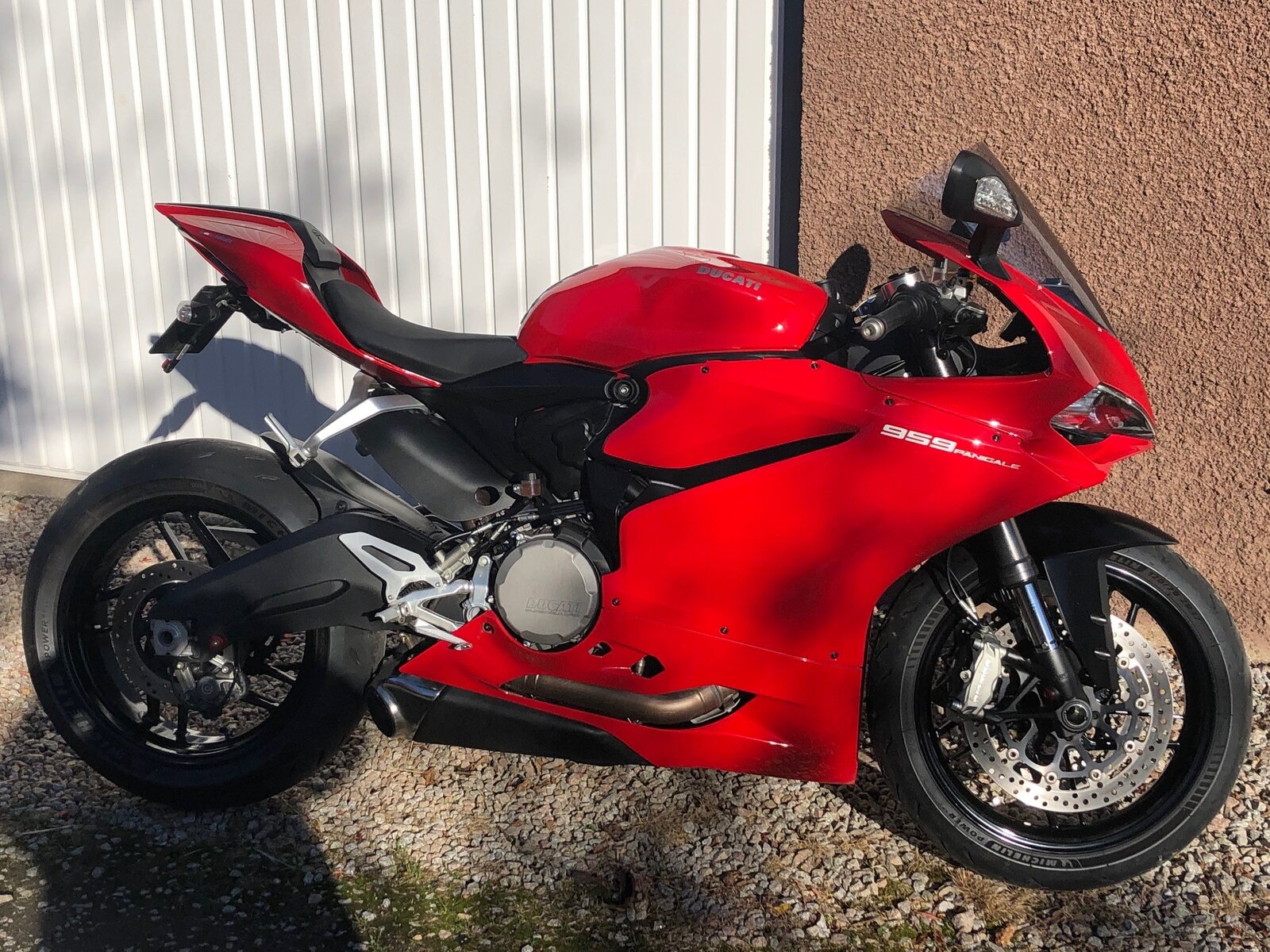

  1. These are the first pictures of my 2016 959 Panigale now fitted with a 1299 under slung exhaust. Foe me, it looks and sound so much better. I have also removed the exhaust valve servo.. Anyone looking for an Akrapovic shotgun for a 959, please get in contact with me. I have one in near new condition.

  5. Hi I’ve currently got a 959 with a full Akra system but want to do some trackdays next year. Did you fit a full 1299 system or just the cans and y piece also what’s the score with the exhaust valve. Ideally would keep the under belly but if I have to I’ll put the standard exhaust back with a different end can, noise permitting.
  6. I just fitted the Y piece and the 1299 cans, the rest of it is the same anyway.. I have the rest of the 1299 system in a box as well as the original 959 cat with servo valve and Akrapovic shotgun silencer and std Ducati silencer as well. Removed servo and fitted ESE de-cat black magic box to turn off engine light. The 1299 silencer has the flapper valve, I left the shaft and removed the disc or valve itself.
  7. Thanks it was a good couple of hours work on a rainy day, so time well spent..

  9. The valve is wide open all the time as I have removed the Servo Motor and cables, etc..

  14. She is sweeeeeeet :)

    Can be possible for you to put the list of stuff you need to make this change, as detailed as possible.
    I have Ducati Panigale 959 with standard exhaust system ( shotgun) and just purchased the ducati Panigale 1299 standard exhaust system, lower fairings for 1299 and exhaust valve servo mould Eliminator. Just wondering, am I missing anything else before starting actual work ?
  16. The original poster hasn’t been on this forum for well over a year so you might not get a reply. Andy
  17. No, that’s just about it. As long as you have the 1299 Y adaptor then you shouldn’t need anything else.
  18. Thanks for reply.
    Now I need to wait for parts to arrived and start working.
