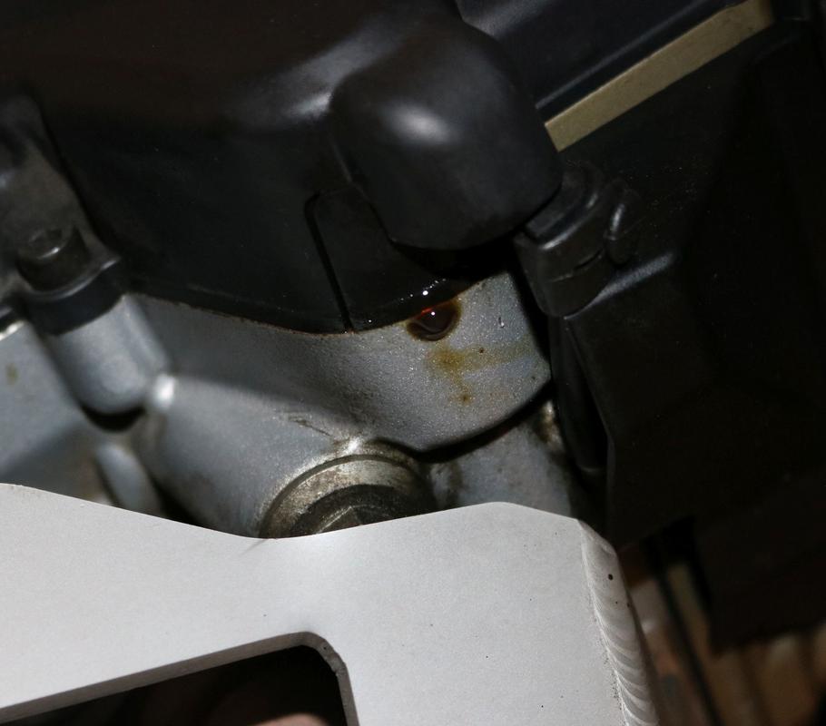

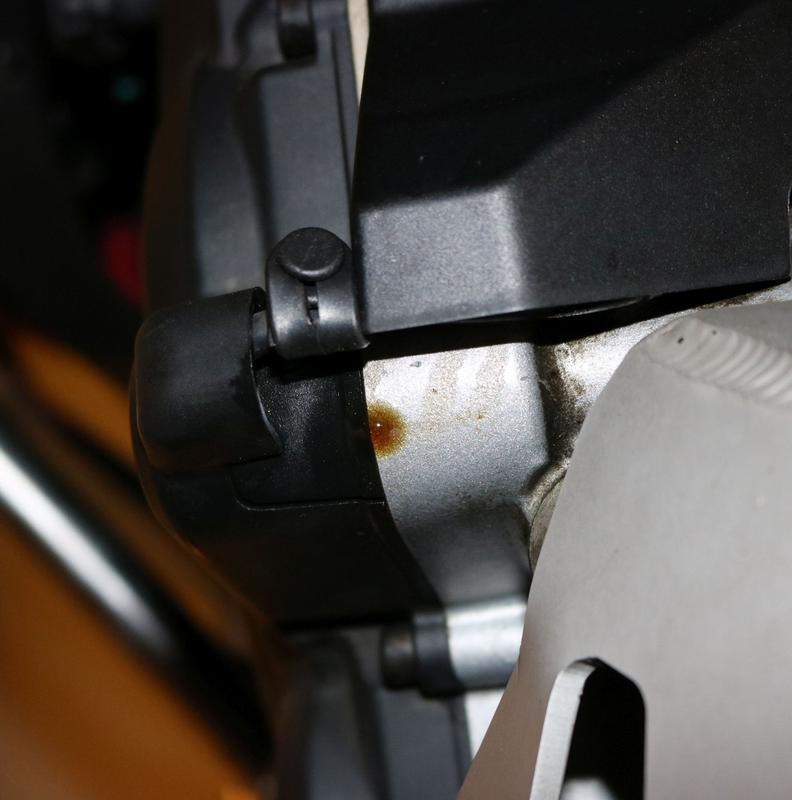

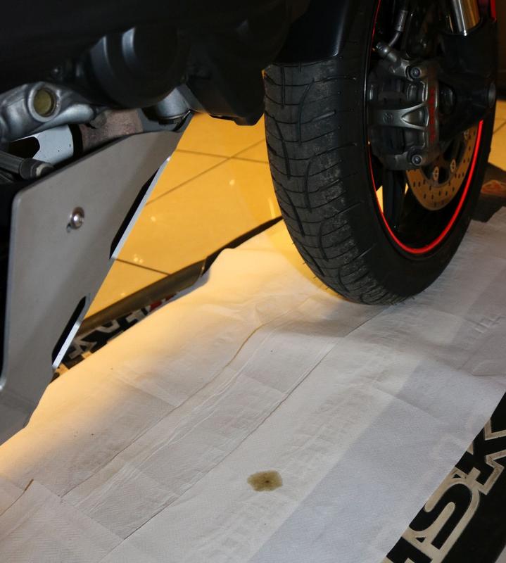

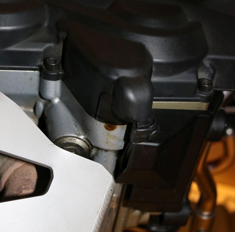

    I've got an oil leak!:mad:
    2034 euro and this is what I get, fuck that!
    Pictures will follow, I'm just waiting for the drop to reach the paper towel. :D
    Saw a drop this afternoon and a shiny rubber floor mat....wich made meconclude I'm fucked!
    So I cleaned up the engine, made high res pictures, rode it for about half an hour and waited for verification, and indeed, oil began to form, luckely at only one spot as far as I can see.
    Its at the tip of the right plastic cover in front of the engine, the horizontal cilinder....pictures will follow.
    As soon as I got that second picture, I'll send them over at the dealers, I wonder what he has to say,
    Also I actually asked him to fill up my coolant because it was at minimum, level, so when I saw nothing of this in the invoice I asked if they renewed or fulled up my coolant, the guy at the shop said: fill up.
    But when looking with a flashlight, I saw the level was same as before, low :rolleyes:
    After the issues i had from the start (remember my topics of wrong gps wiring and brake pads that were bad) I've just had it with these guys. :mad:
    To be continued
