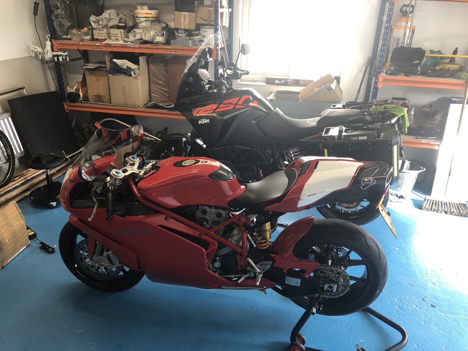

  1. Well, not exactly the first, I took it around the block before buying it.

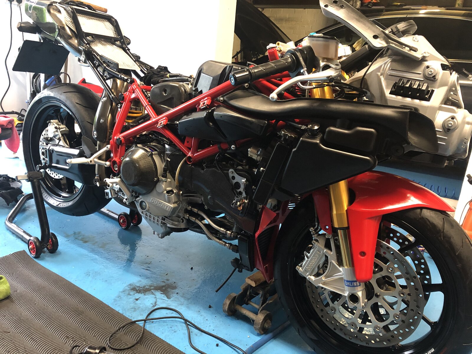

    Since getting it back home, i'd taken the fairings, wheels, tank, and timing covers off for a check before taking the bike out for a shakedown ride. The brake and clutch fluid looked old so replaced it and bled the brakes and clutch. I bought some Iridium spark plugs but didn't install them until I'd been on the bike. Oil looke fresh and sufficient, brake pads looked ok as did the timing belts - service records said that they were changed in November '19 but..... you know ....

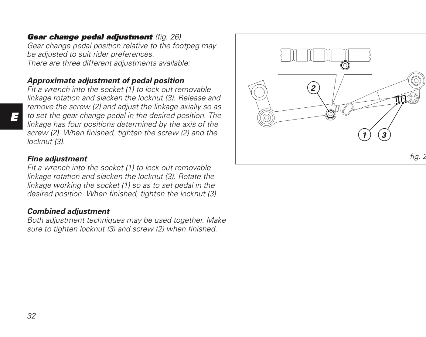

  3. Try adjusting the gear lever downward using the adjusting bar. Should make the change more positive.

  18. All in the handbook. Adjusting will allow gear lever to be repositioned up or down. You should find moving it down slightly gives a more positive change.
