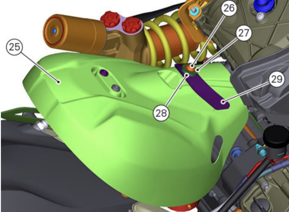

    Those two grey bits on the green heat shield are metal spacers that the bolts go through into the subframe. The pegs actually fit in the space of the spacers, the the bolts (and shield) just bolt up the same after the pegs are out.

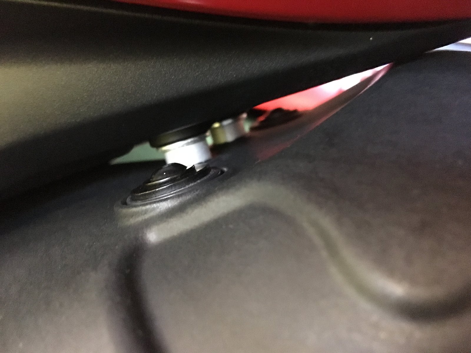

  17. No they do tighten the foot peg bracket.
    The bolts go through the spacers which sit inside the bracket.
    The peg bracket is a few mm thick and this needs compensating for otherwise the shield hits the undertray slightly.
    If you remove the pegs the heat shield is raised up a few mm

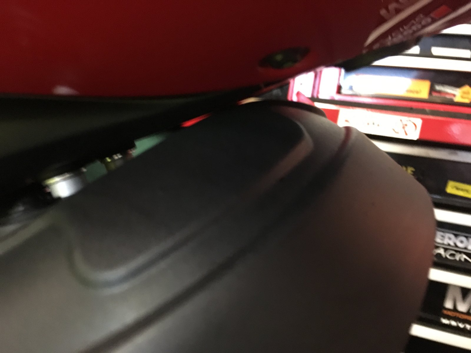

    You need to put a washer in otherwise the bolt shoulder is slightly too long and the plastic heat shield hits the underside of the tail unit
    A 1mm washer keeps the heat shield from touching/rubbing
    Daylight - without a washer it hits the tail unit.
