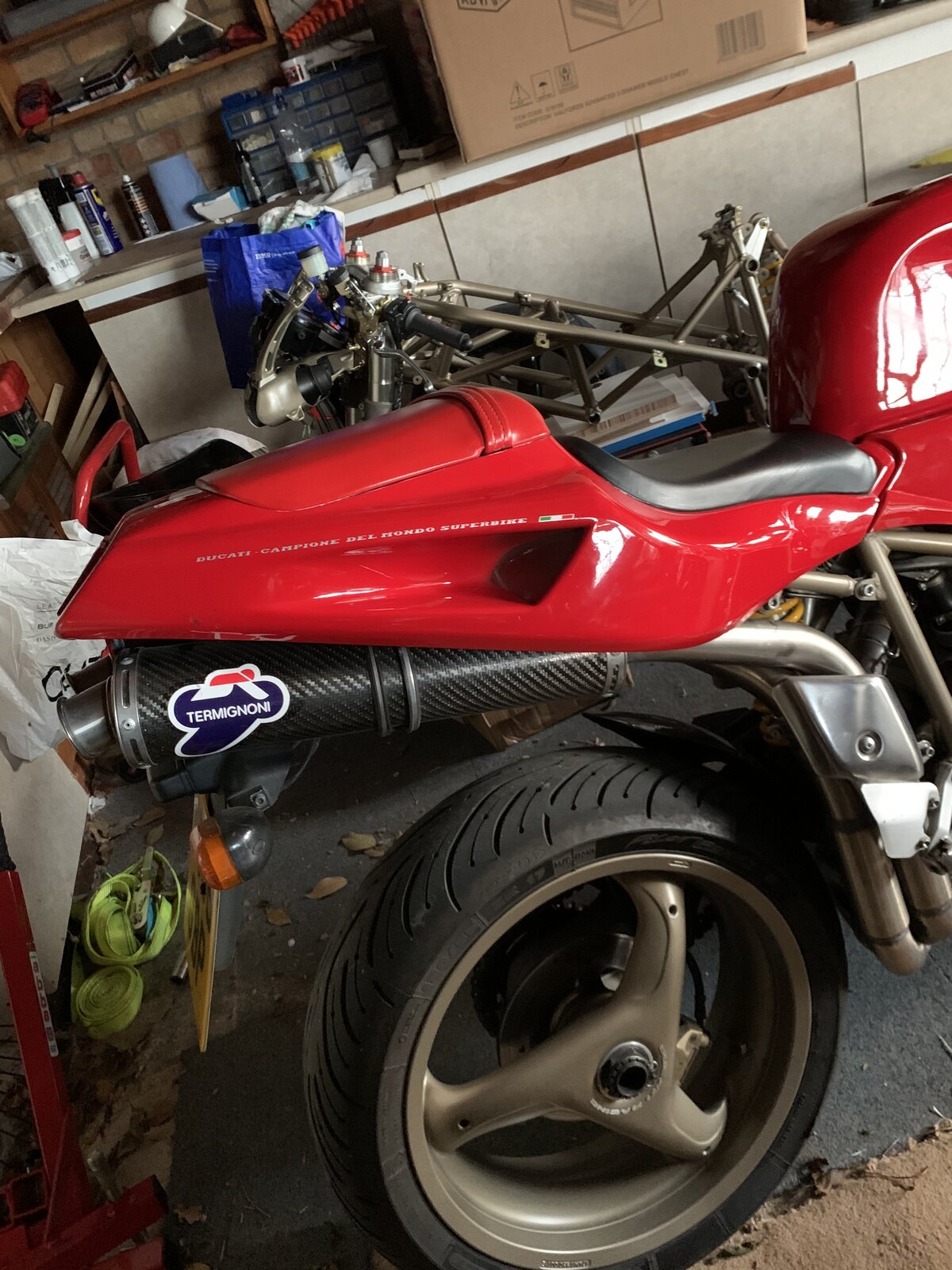

  6. I would have agreed with you about the height and the gap but then I looked at a picture of mine and it looks quite similar.

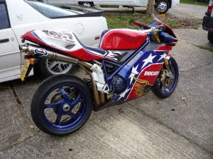

  7. This is my 916 but it’s a biposto, must just be the shape of the mono. You’ve a Lovely bike btw

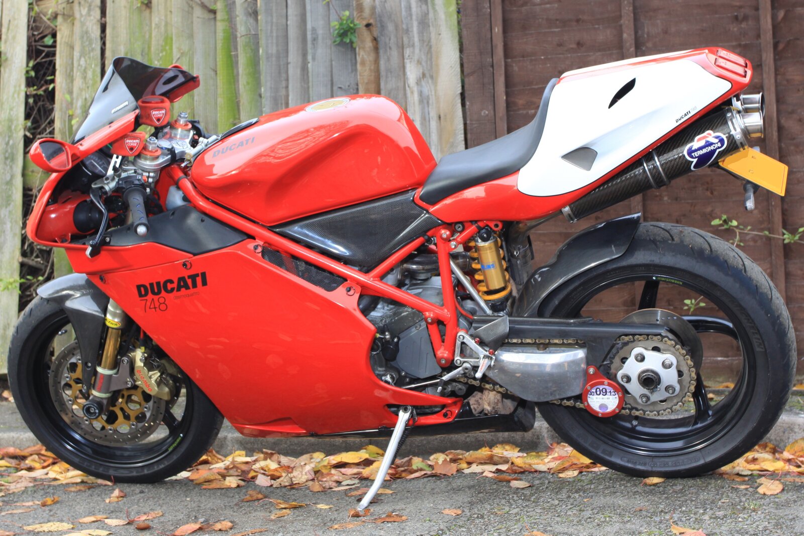

    the subframe looks dodgy
    heres mine albeit late 748r and the cans are quite tight to underside

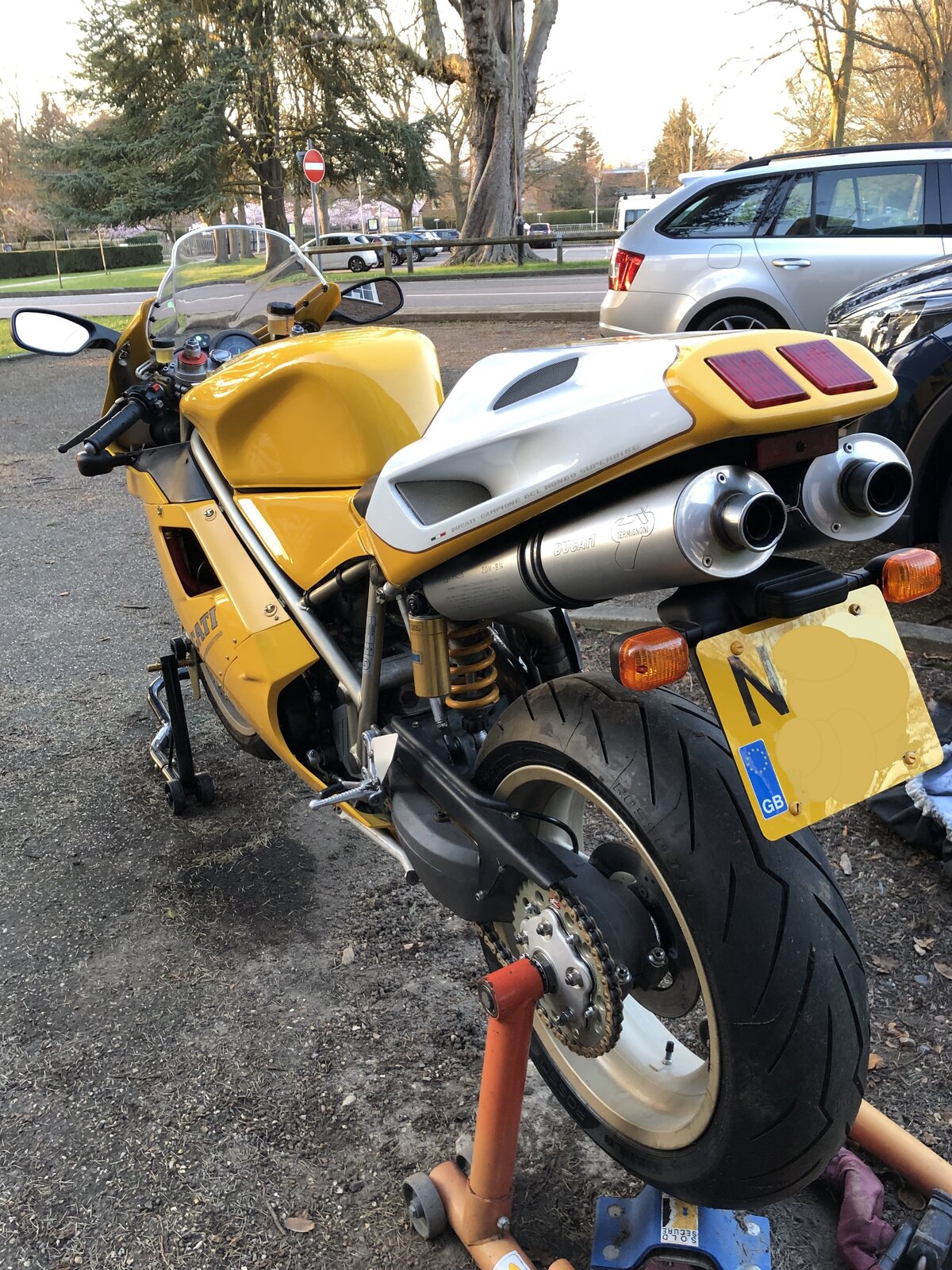

    Couple of pics to help with the rear. both of those have a proper ducati monoposto seat. the red was my old bike and the yellow my current bike:
    This had a biposto subframe.
    This has a monoposto subframe.

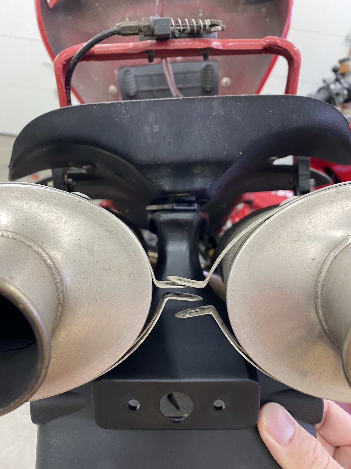

    The last issue is hard to see in this picture, but my new OEM license plate holder doesn't fit:
    The top of the bracket is hitting the bottom of the Termis, and as you can see it's too far away to be able to screw into the bottom of the undertray. It's off by at least half an inch. But why? Is the exhaust too low, is the subframe wrong, is the undertray wrong, or is there some other issue entirely?

  14. Looking back at the pictures in the first post and those above I think the problem lies in the subframe itself. Where is from? It doesn’t look genuine or even a copy of the OEM one. It looks like the exhausts can’t mount correctly which is what’s giving the big gap between exhausts & seat unit commented on after the OP and what’s causing the inability to mount the licence plate holder. You may have to shorten the brackets that suspend the exhausts thus pulling them up into the seat unit and giving the room you need for the licence holder.

    There is a difference between mono and biposto undertrays, a quick eBay search will probably throw up some images of each for you to compare. The use of the wrong undertray may be a contributing factor but then my 998 has a BiP subframe, with BiP undertray and a mono seat and all is good.
