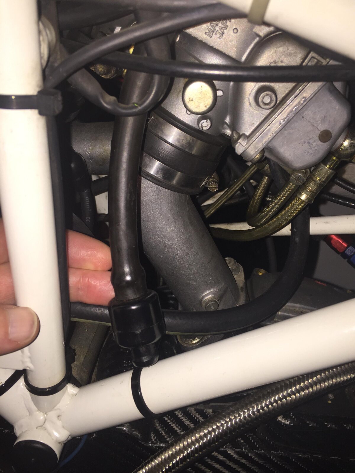

  1. I decided to do a bit of cleaning, so whipped the fairing off only to find a mystery pipe with a large connector on the end, just hanging about, looking like it should be connected to something (hopefully I've attached a pic of it to this thread!). It looks to be coming from the top of the carbs area. Anybody know what this is and where it should go? Thanks :) 900-SS-Mystery-pipe-01.jpg

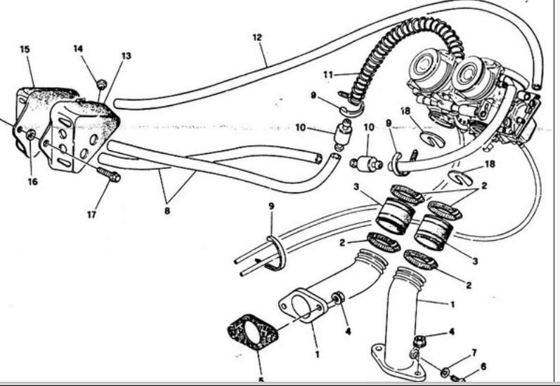

  2. You'll have 2 of them, one for each Carb - breathers.
    Nasher.
  3. But they should be routed back to the breather box.
  4. Thanks Nasher...so, judging from that diagram, I'm missing a length of tubing that should attach to the end of my mystery pipe, which should in turn go into the little triangular box on the other side of the frame? The bike is up on stands, against the wall, so I can't easily get to the other side of the bike...but I can see that there are no pipes plugged into the triangular breather box at all...as I can see the two holes where they should sit.
    I presume it's not a problem that there are no pipes going into this breather box? As I've been running the bike like this for the 3 years I have owned it!

  8. Apparently......according to Ducati Italy when I asked them about the triangular box, it isn't actually a breather box, but a flame trap.
  9. Arquebus/Nasher...Thanks for the info...my bike seems to run very nicely at higher speeds, no problems at all. I will have a poke around on the other side of the bike when I move it away from the wall come Spring time and see what I can find in regard to the second pipe.

  11. Initially I did think that, due to the fact that the previous owner of my bike spent a fair bit of time getting it fettled at Baines Racing...but no....I found the other bit of pipe sticking out of the triangular breather box, the end had just split and detached itself from the coupling.
