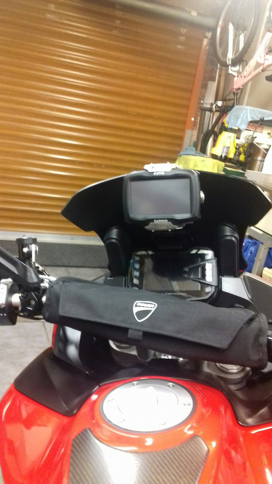

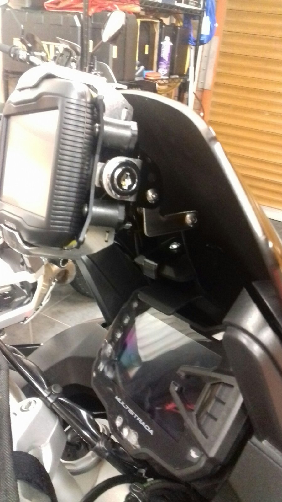

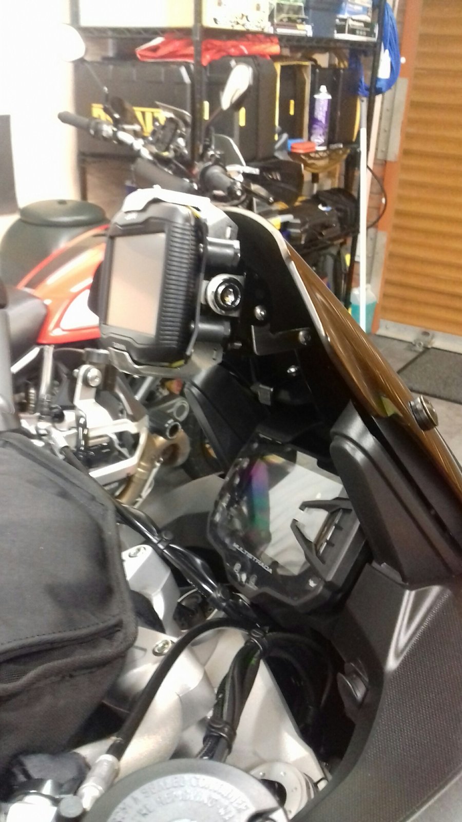

  2. Hi i have the Navihalter, touratech mount and same Garmin
    I had to fit spacer bars between the Navihalter main part and the Navihalter Garmin Mount plate to move out the mount from the screen and up further so the dash was still fully visible.
    The touratech mount looks ok from rider position
    But the whole assy is a bit naff when looking from front of bike
    The extra weight also causes more vibration on unit

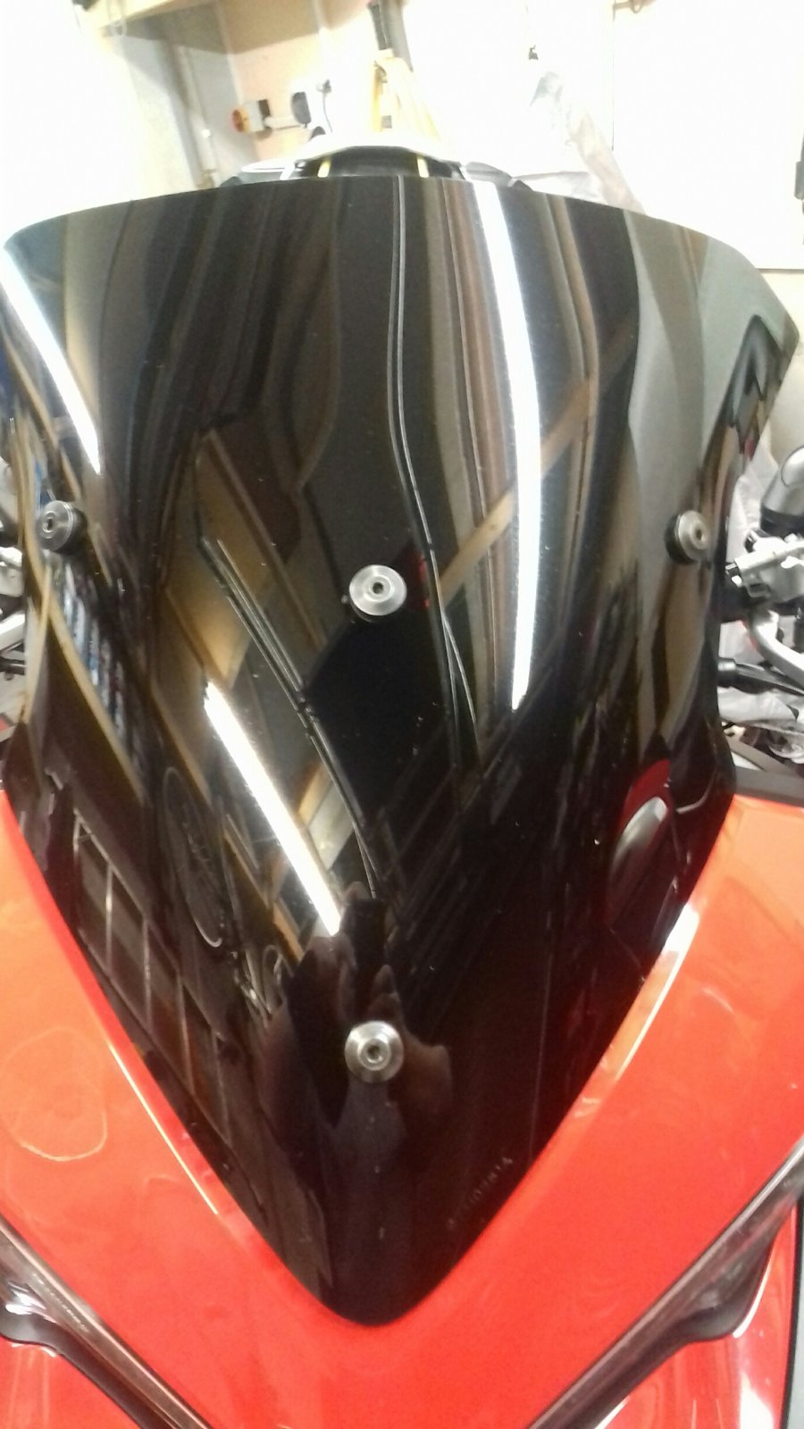

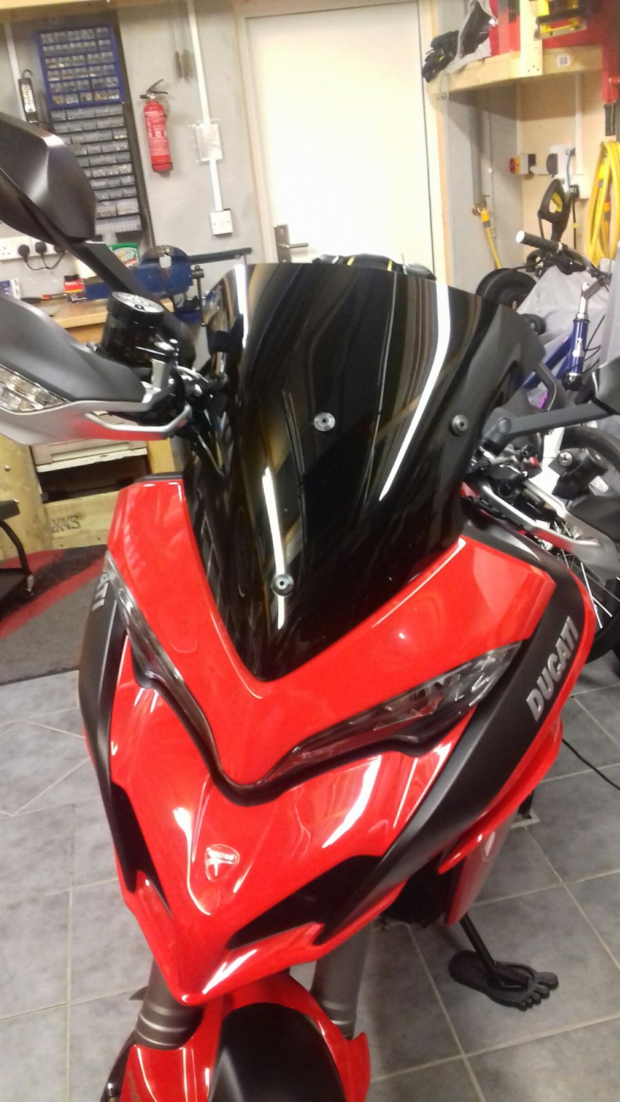

    So i fixed that by connecting the navihslter bracket to the screen for extra support
    I then used plastic matt black paint and painted out the inside of the screen so that from front you can not see navihalter
    Will post pics tonight when i get home
    I also run a cut down screen to reduce buffeting
    The overall solution is good but a bit of work and expense
    The touratech mount is lockable but 2 minutes with a screwdriver and you could still have nav away.
    But i have 2 one on scrambler too
    So i thought it was secure enough
  3. H
    Hi as promised some photos
    Hope it helps
