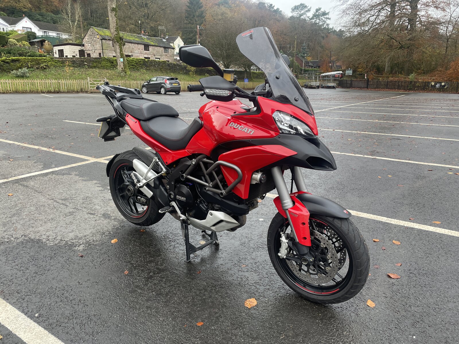

  1. Yesterday was a new bike day for me, a 2014 1200S Gran Turismo.
    I'd been thinking about second bike for a little while, and was in Ducati Stoke last week getting the throttle replaced on my M821 when I saw this. Perfect for some winter commuting I thought - I have to travel to various locations in the Midlands and Northwest for my job, and while I've done it a bit on the Monster during the summer for the nearer grounds I would prefer something with a bit more weather protection and more comfort and presence on the motorways.
    It is 1 owner, 10000 miles and I couldn't see a mark on it at all. Picked it up yesterday and took it for a quick blast in the Peak District around Leek, and then again to an night ride to a friends - I'm VERY impressed with the lights and the LED spots were a selling point for me and definitely worthwhile. And as always, great service from Simon and Paul at Ducati Stoke.

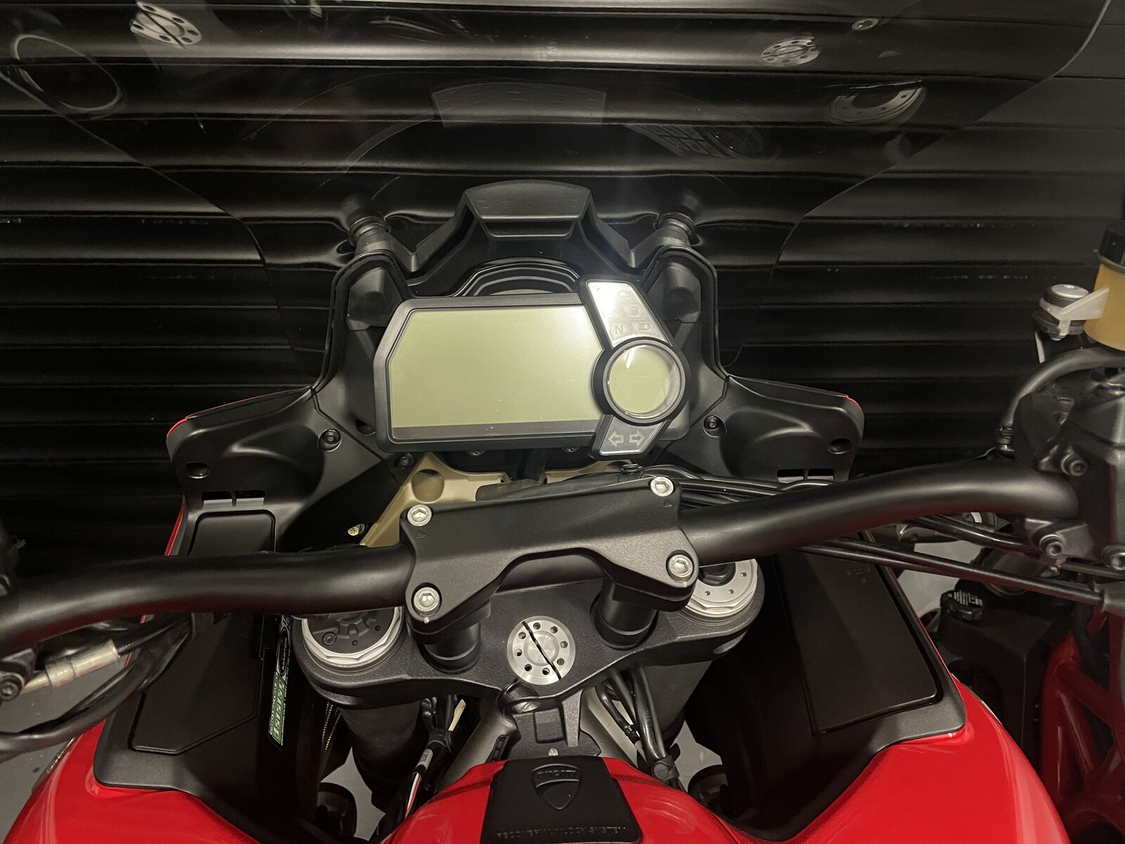

    A question for you MTS1200 Owners: I use a Garmin Zumo XT with my M821 and got a very nice mount from Evotech that fits in the handlebar bracket. But they don't do one for the 2014 1200S (it's an older bike now I understand). I'm just wondering if anyone can recommend another way of fixing it on aside from the clamp and knuckle arrangement supplied with the XT?

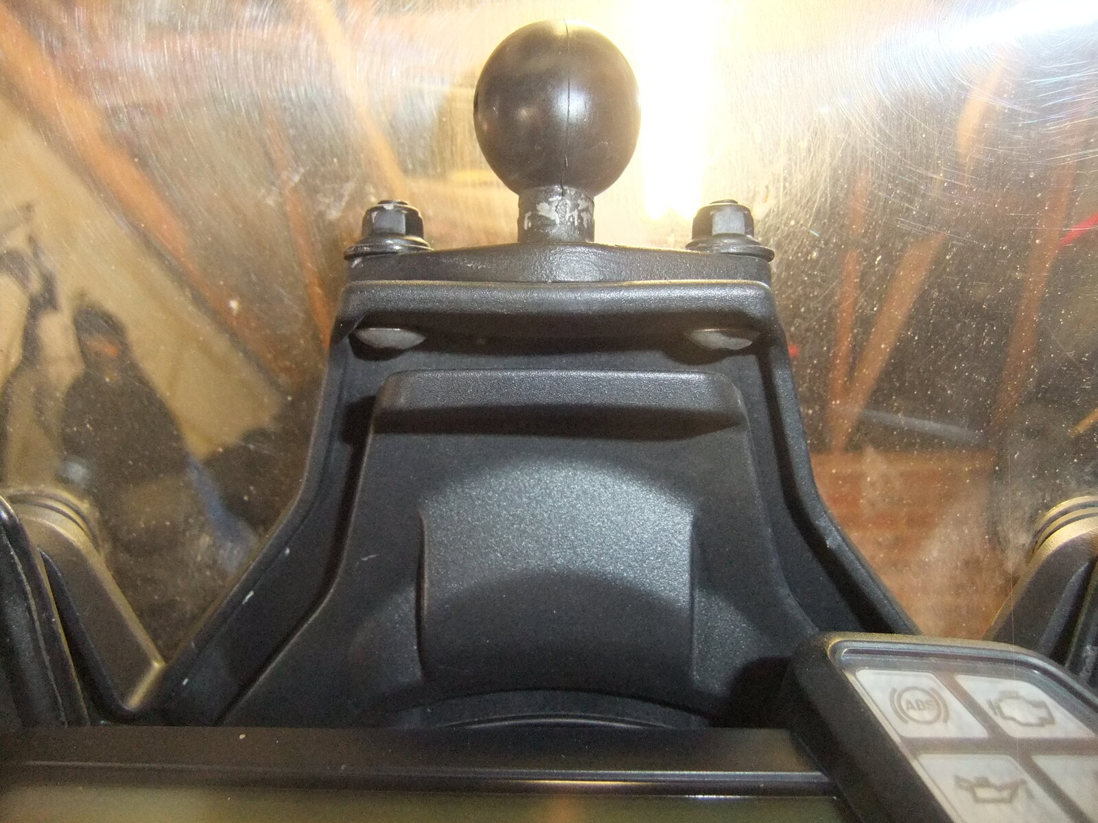

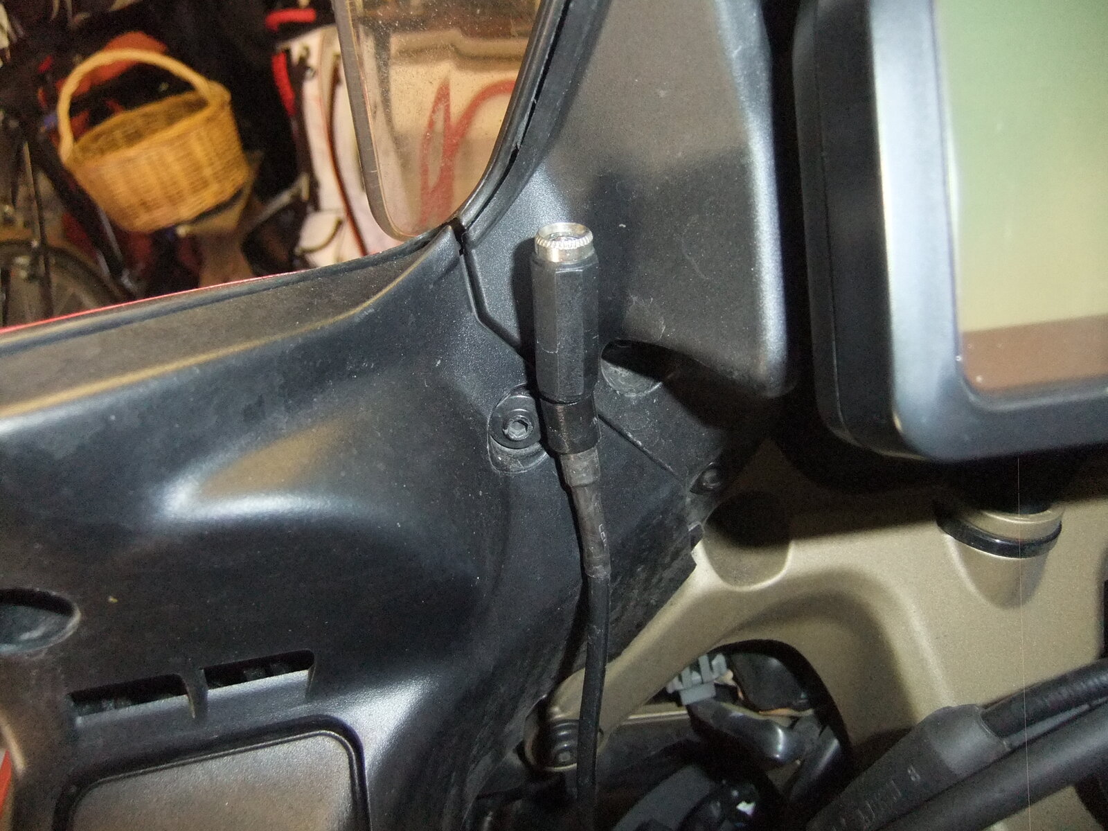

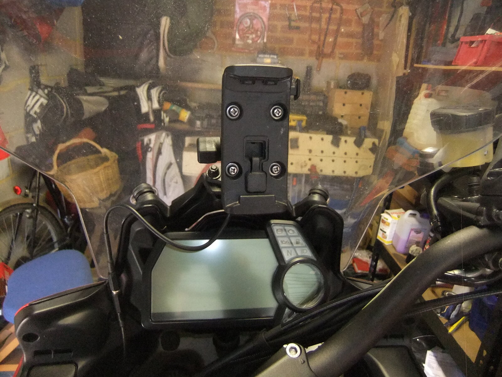

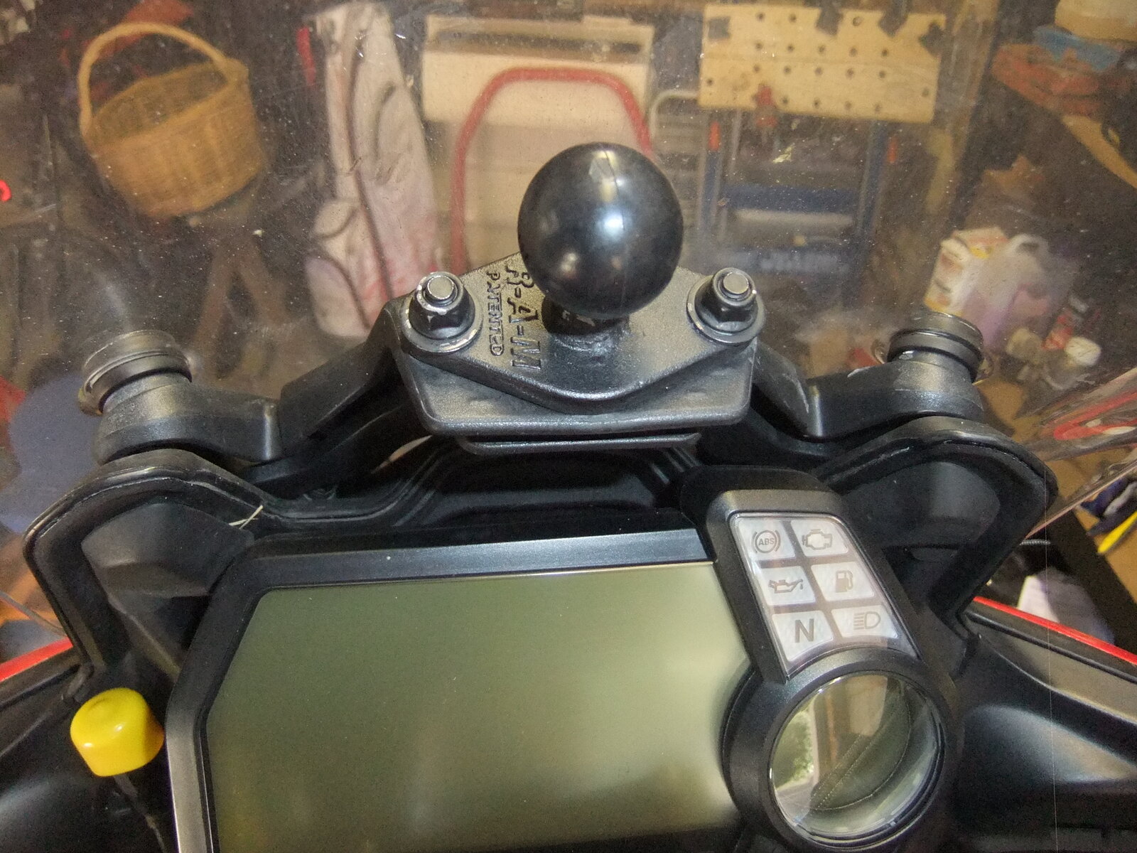

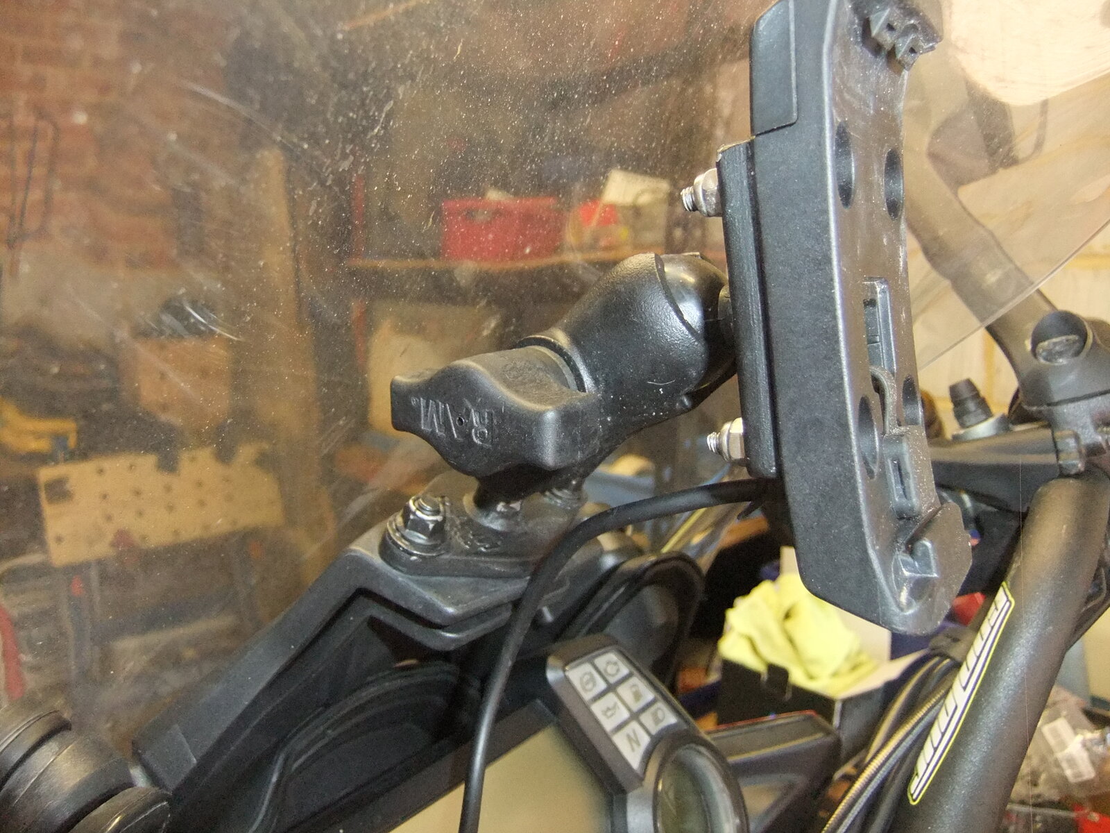

  2. I use a very simple alternative to mount my sat nav. These are pictures of the Zumo mount on my old 2013 Twin Spark 1200, and I still use the same mount on my 1260 DVT and it works just as well.
    I just use a Ram ball screwed to the top of the screen adjuster. Using low profile button head screws will allow the adjuster to work as normal. Connect to the Zumo backplate with a double female Ram extension. It's cheap, easy to install, and versatile, as you can mount a phone on there too. I also cut the power cable so that I could remove the Zumo mount if I wasn't planning to use it, but it can be left in place.

  3. Thankyou @doctor feelgood for the offer, but I've done a bit of checking and it appears that the mount is different between the 10-13 and 13-14 models. I has a look at your picture and couldn't see how it could fit my model but I've found an alternative and if I get hold of it I'll report back here with how it works.

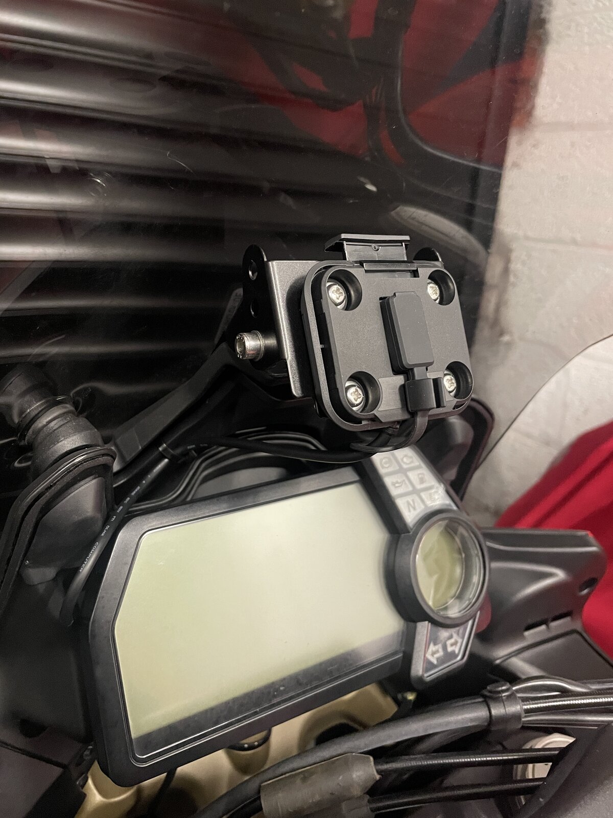

  8. Thanks @Handtoeknee but I’ve got it sorted now - my Navihalter arrived and I’ve now got it all wired in and working perfectly although yet to get out and road test it yet due to the rubbish weather.
    I found the Nav cable beneath the fairing together with the pigtailed connector - after checking with a multimeter I soldered on the Zumo connector and that was pretty much it.
