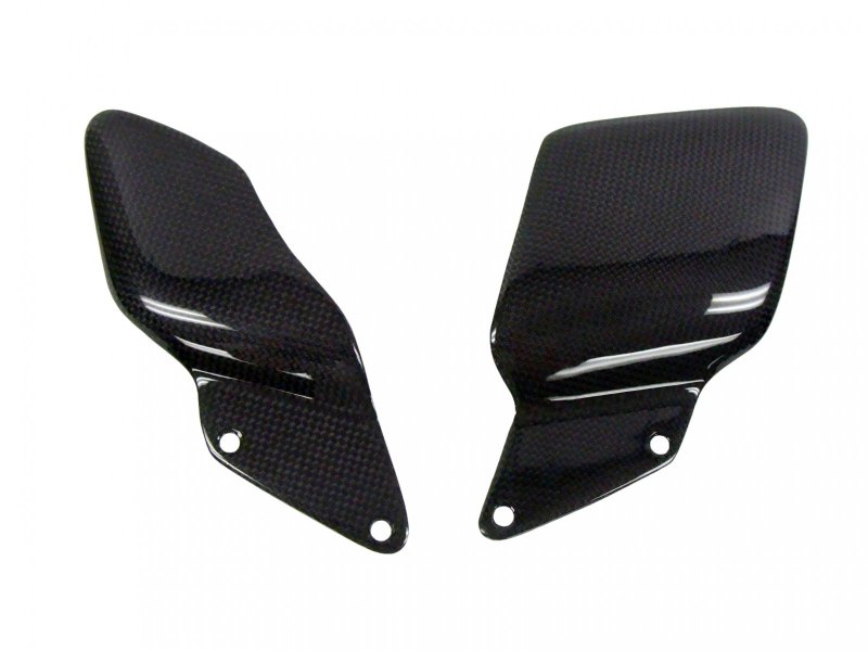

  1. This is a long shot but it would save me a lot of trouble. Does anyone have a 748/9** Lefthand (nearside) Corse style heelguard that they can let me have or sell for a decent price. I have the righthand one and I want to mould up a few sets and try and reproduce them in Carbonfibre.
    I already have the mould for the right one and I am testing out over the weekend to see how it comes out. If they come out decently enough then I am happy to produce a few sets for forum members for less than anyone else could\would charge commercially at the moment.
    An option would be if someone could lend me one but there is a danger that the moulding materials used would affect the surface finish so I don't really want to go down that route. If anyone can help I would be grateful.
    Here's a photo of a set and it's the smaller one of the two that I need. If you have anything to offer please PM me.
