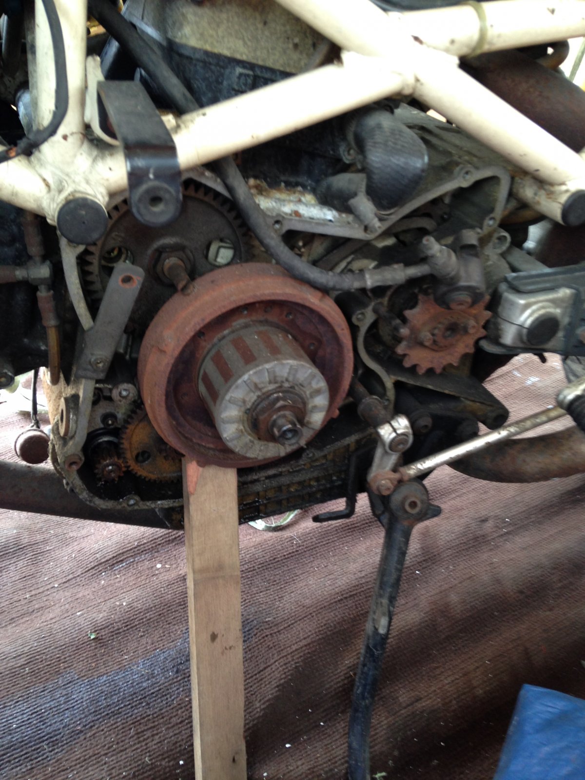

  5. this is the current condition of the engine! cant find any parts of for it. ducati club in here wont help me out :/
  6. ^ I guess Typhoon Koppu last year didn't help.
  7. So you will need to strip the motor by the looks of it. Unless you have skills and a workshop its really a job for a specialist and will be expensive. You need an alternator cover, other models will fit, watercooled with same size alternator which I think is 350W.
    What do you know about the bike? Why is the cover missing, did it go wrong and previous owner start looking. One problem early ducs have is the alternator rotor nut works loose.
    Also have a look at the case around the front sprocket for damage, it might've thrown a chain.
  8. That's the thing, mechanic told me i'm missing a stator cord and the alternator cover. and i tried looking around but no one sells any here in the Philippines. tried looking on e-bay tho but to no avail. hope someone here has and can ship xD.
