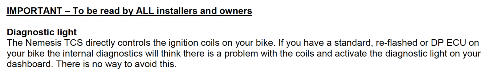

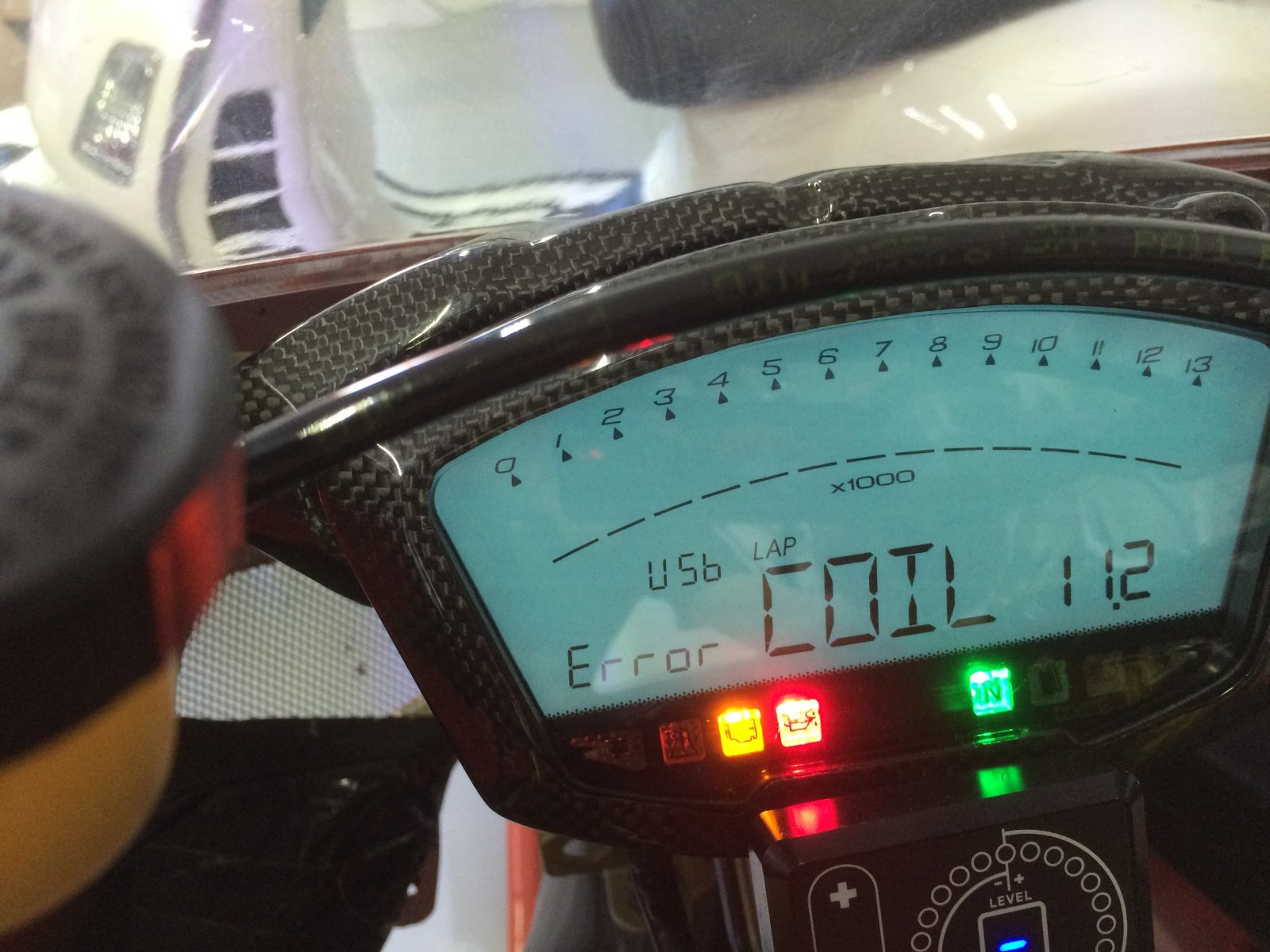

  2. Yes, it's normal and is on the 1st page of your instruction manual.
    You can get rid of it by installing a Nemesis ECU, but will have to live with it with the standard ECU. You'll also have a COIL 11.2 error for the vertical cylinder(s). My 1098R has the same errors and is nothing to worry about. The engine diagnostic light also stays illuminated (orange light)
