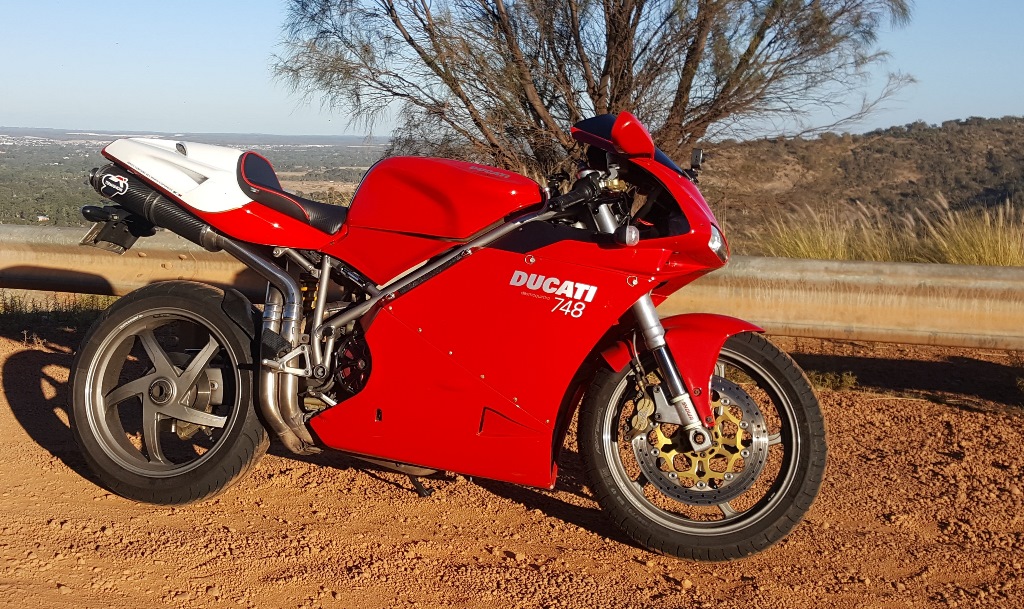

  1. Hi all.
    I've had my 2002 748 for about 18 months and have put 10,000 km on it. It's the best bike I've ever owned but down on grunt compared to my "old" 999.
    So I've decided, after much research to go the 748 route rather than a 916 conversion as, at this stage I don't want to split the motor to replace the crank.
    It ha a 50mm half termi system already with the corresponding EPROM chip in the ECU.
    Does anyone have experience or knowledge as to if any changes need to be made in this area or will the extra 105cc engine run just fine with this setup?
