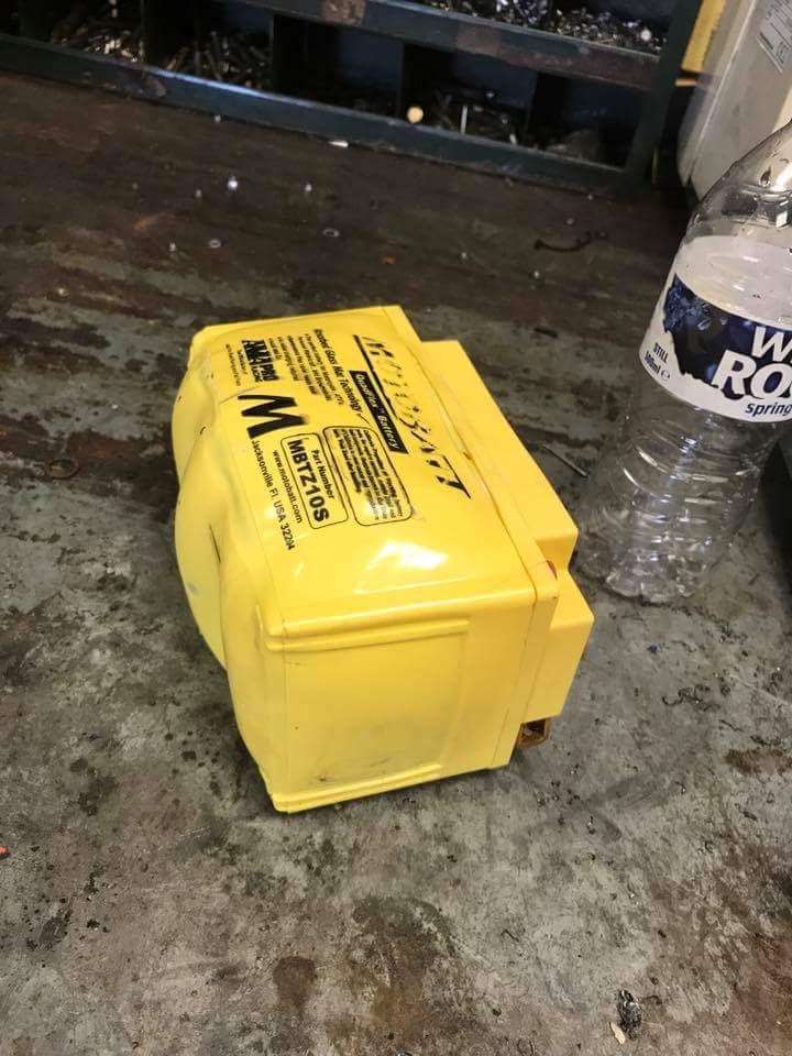

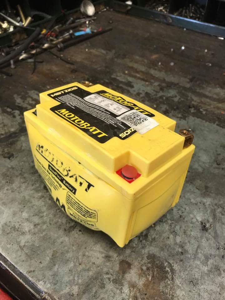

  5. FB_IMG_1495898690822.jpg FB_IMG_1495898690822.jpg FB_IMG_1495898681398.jpg
  6. I've got a MotoBatt on mine !! What happened ?
  7. Not 100%, was on a FB post, think it was a failing reg/rec that caused it. Not saying a Yussa would have faired better. Just been waiting for a battery thread for a few days now so I had a chance to use it :)

    Love that picture of the Motobatt, that is one battery out of thousands sold and was probably not the battery's fault, but now the picture is on the web no one will buy that brand again!
