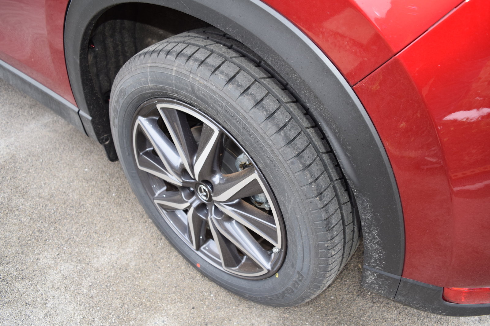

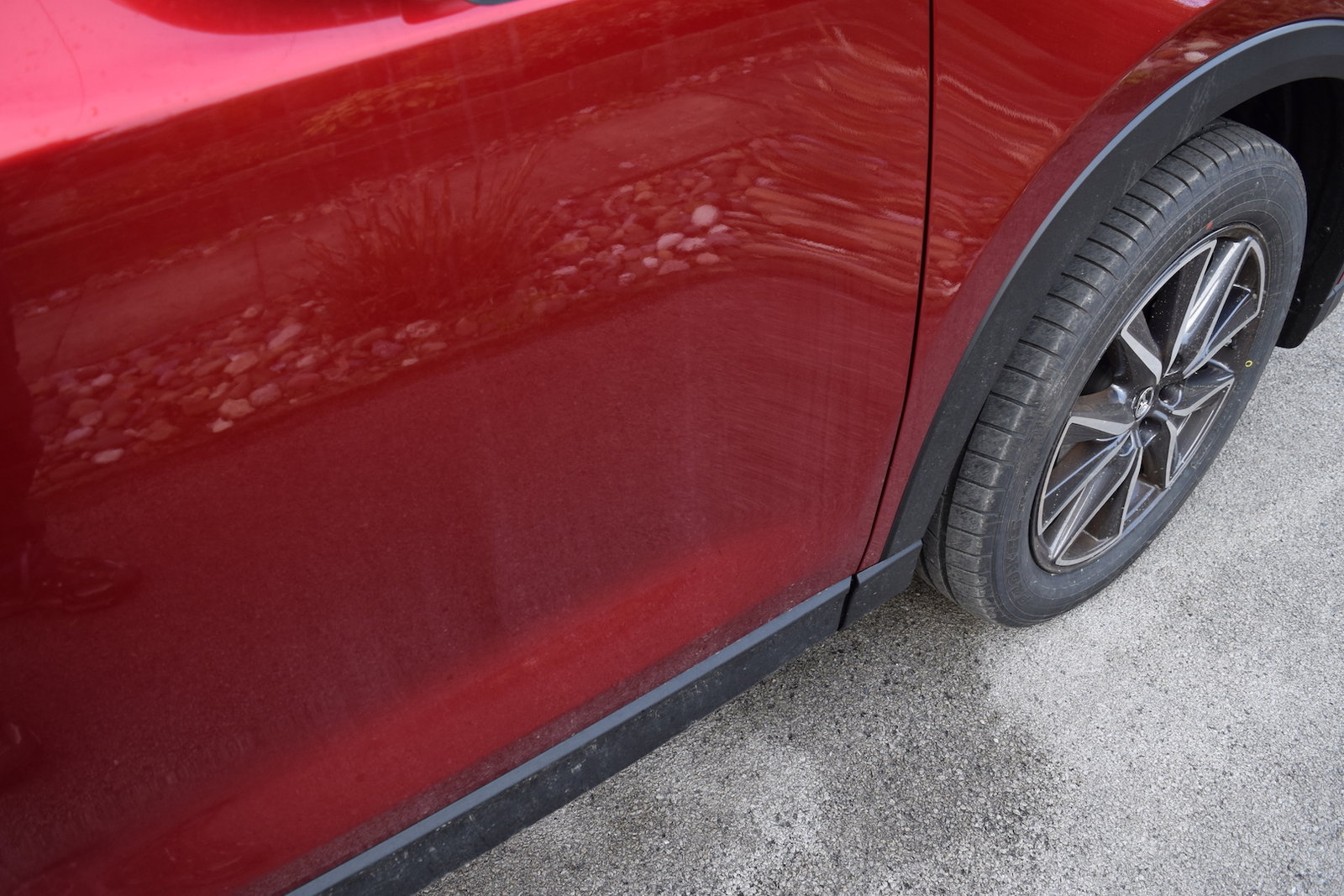

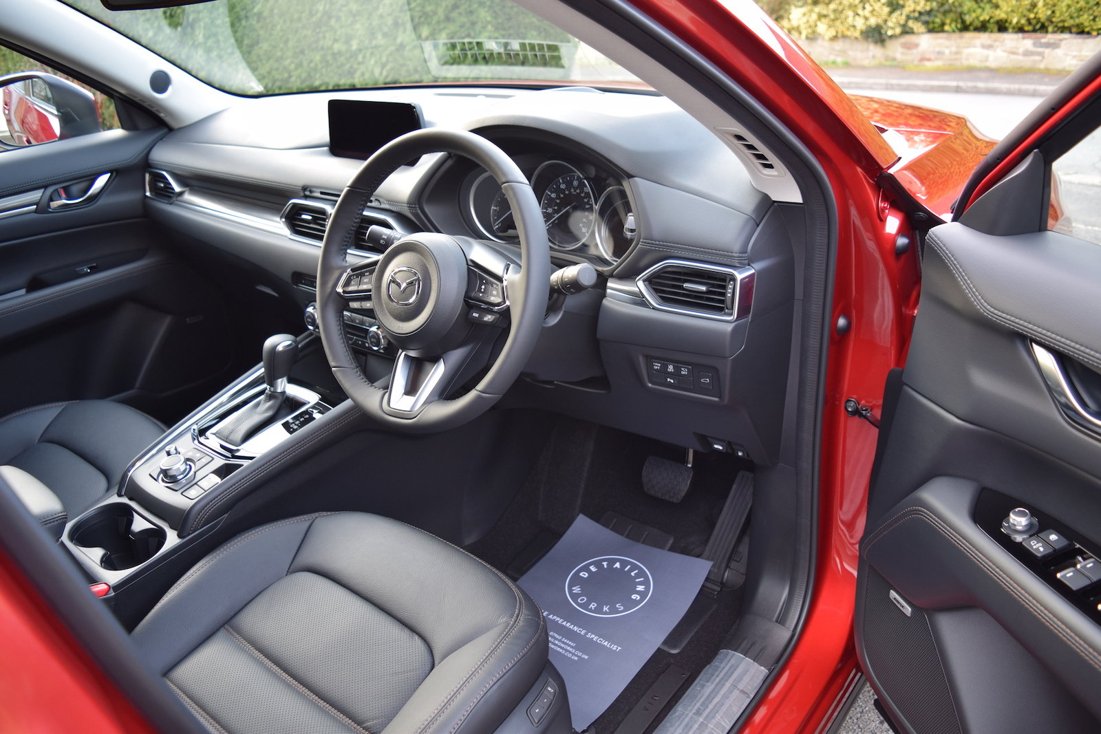

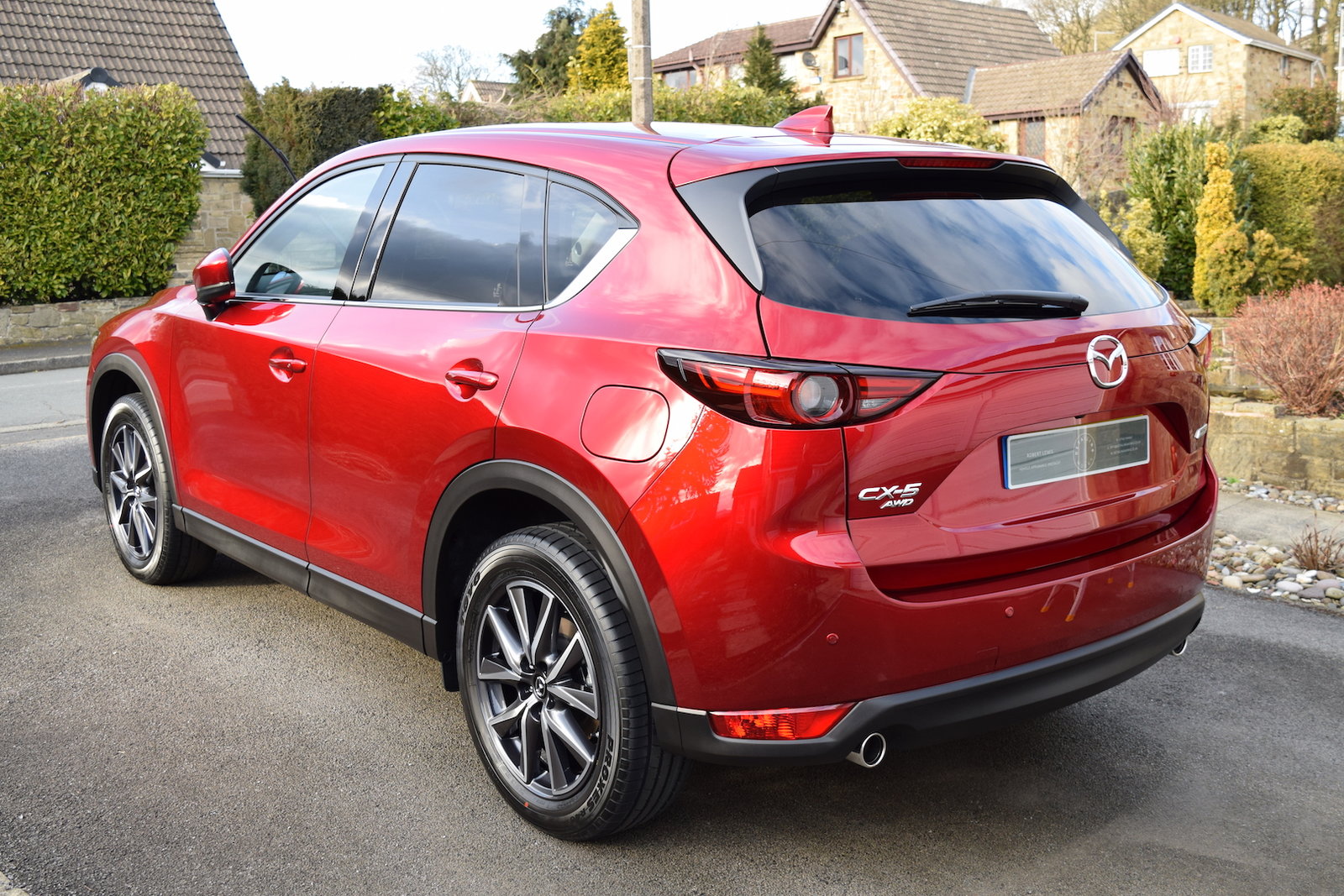

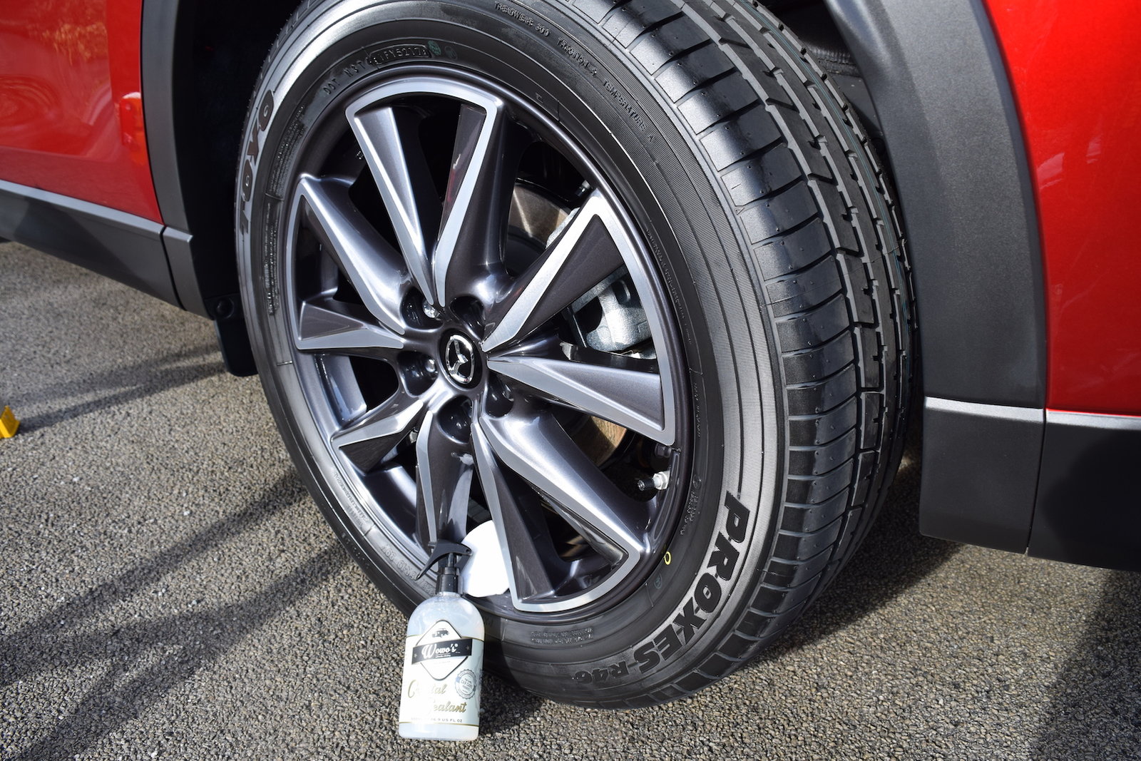

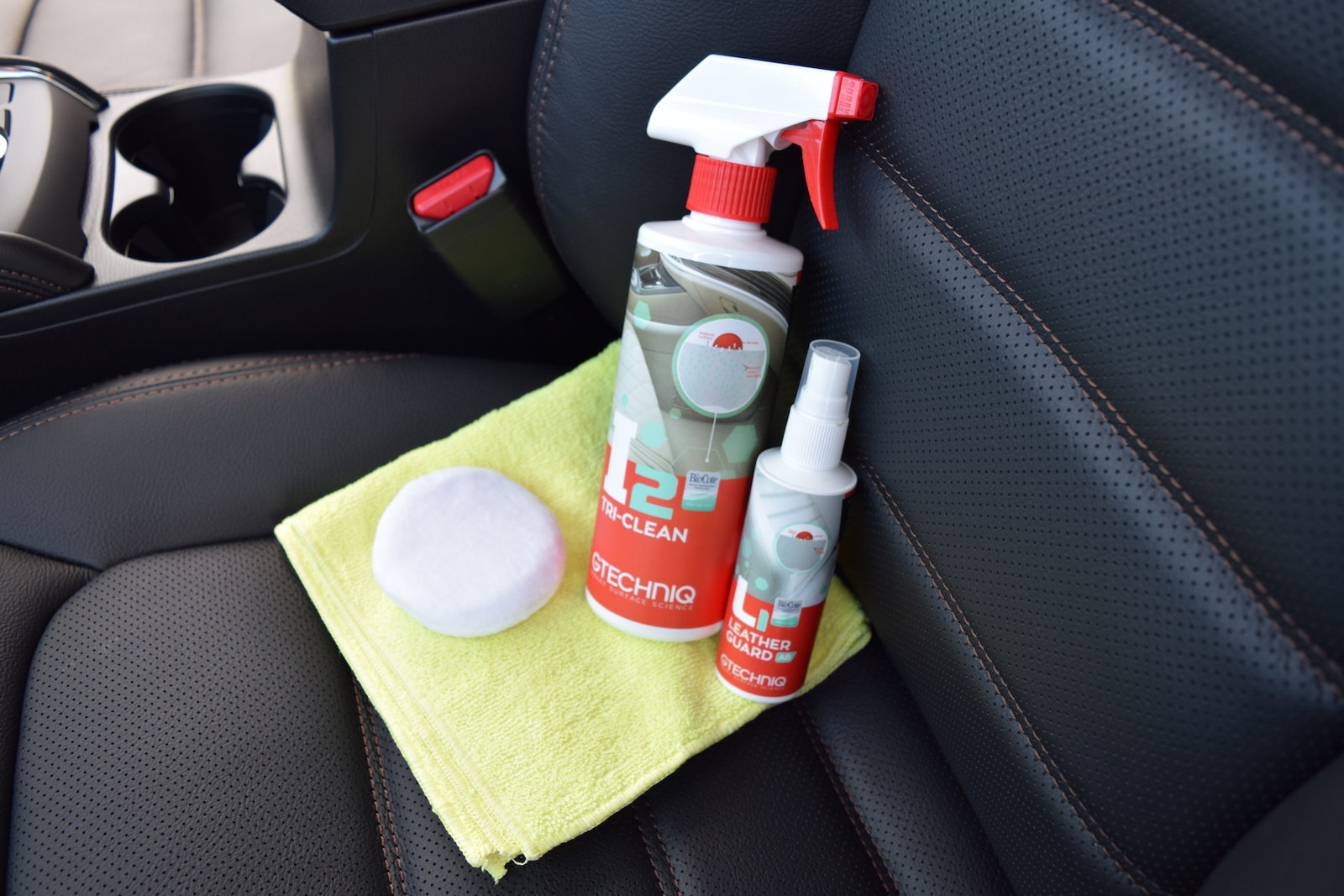

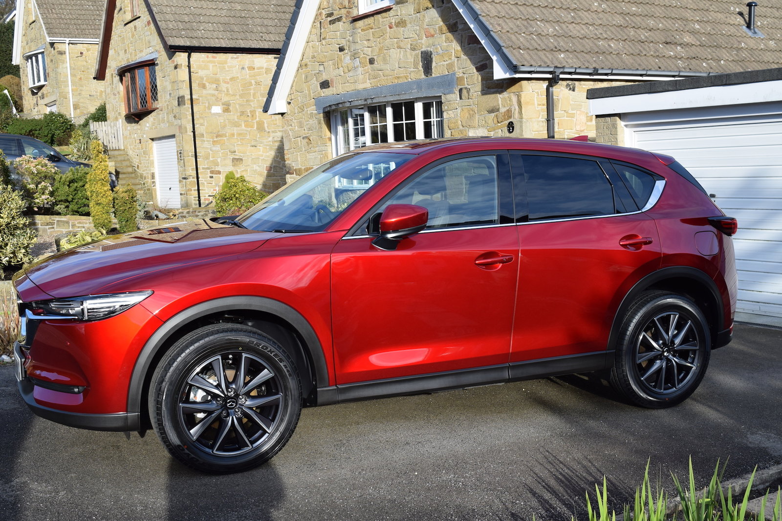

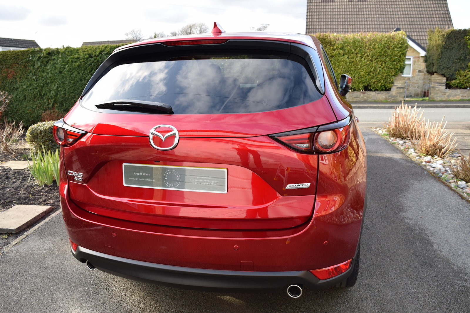

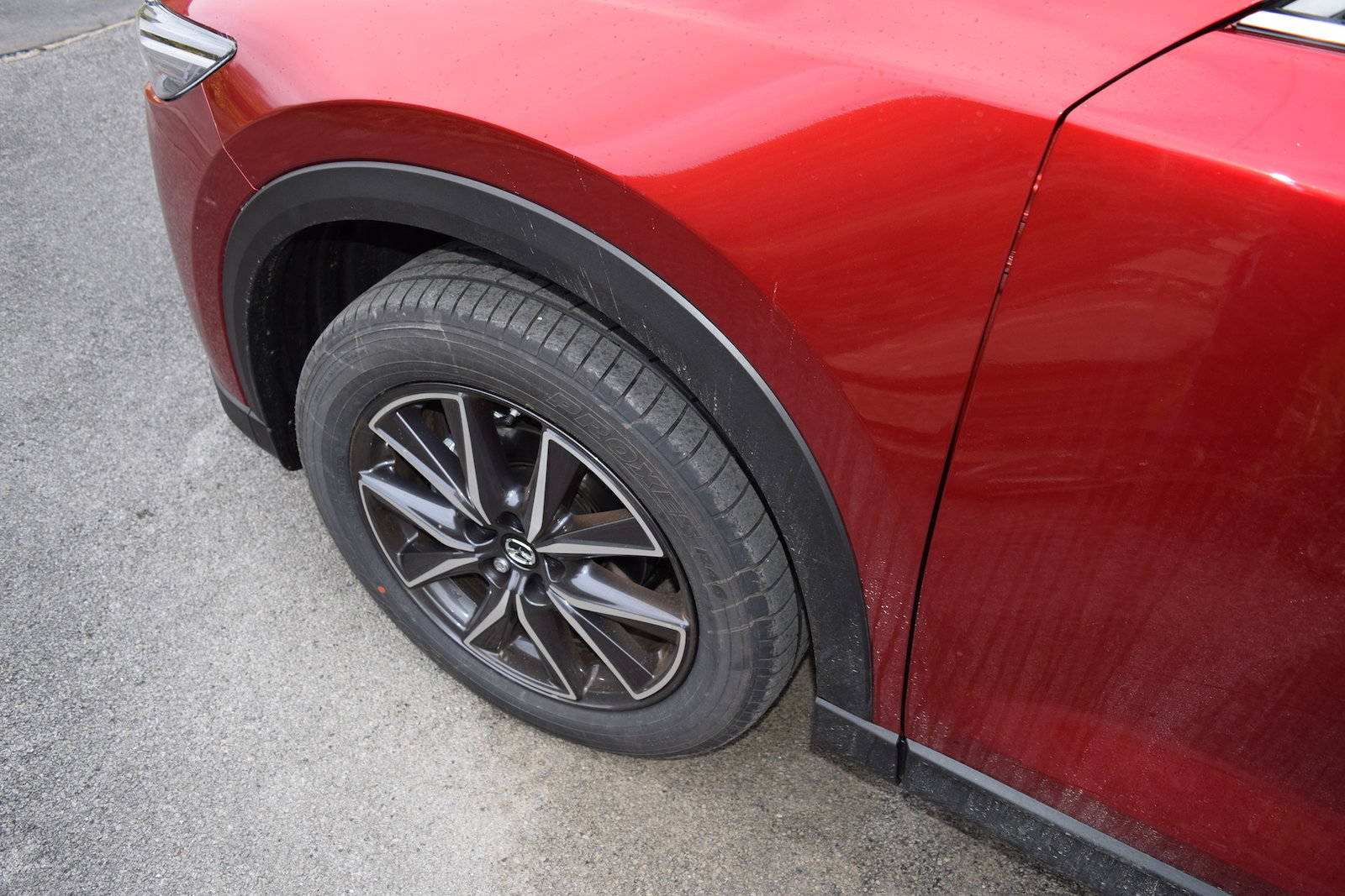

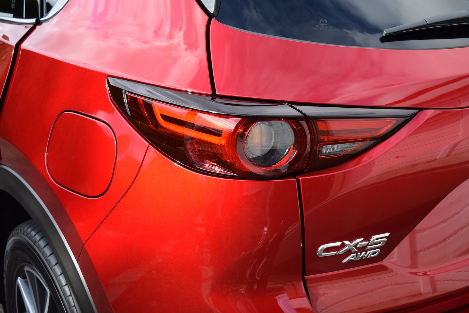

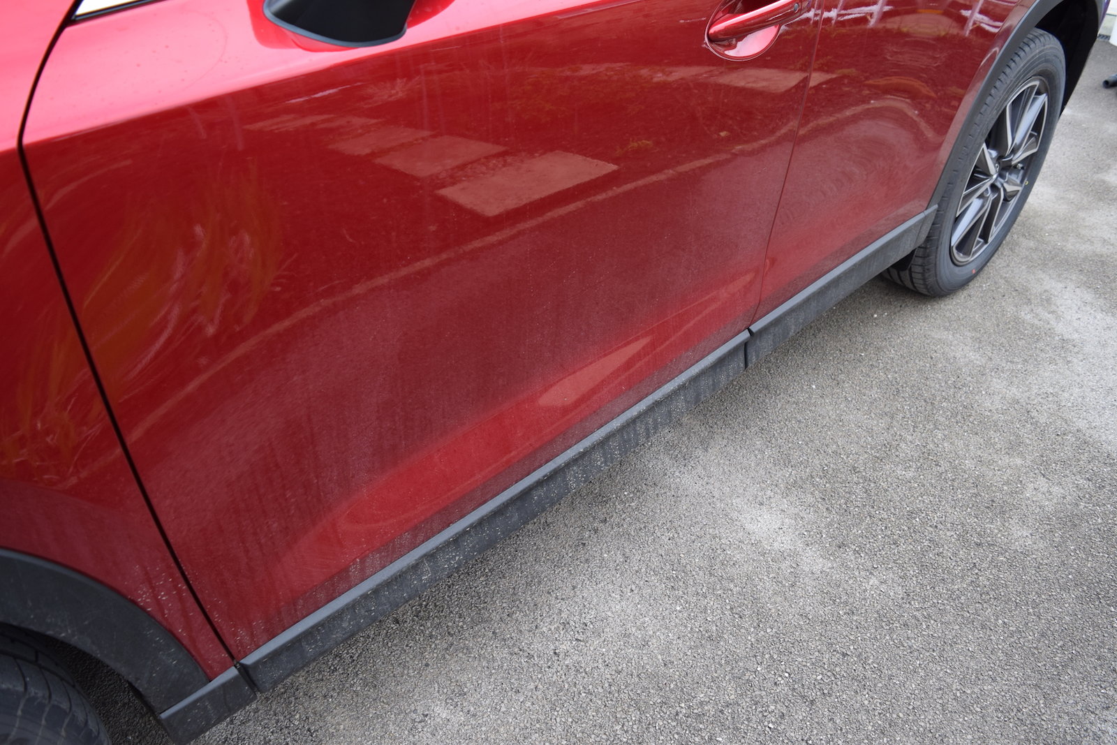

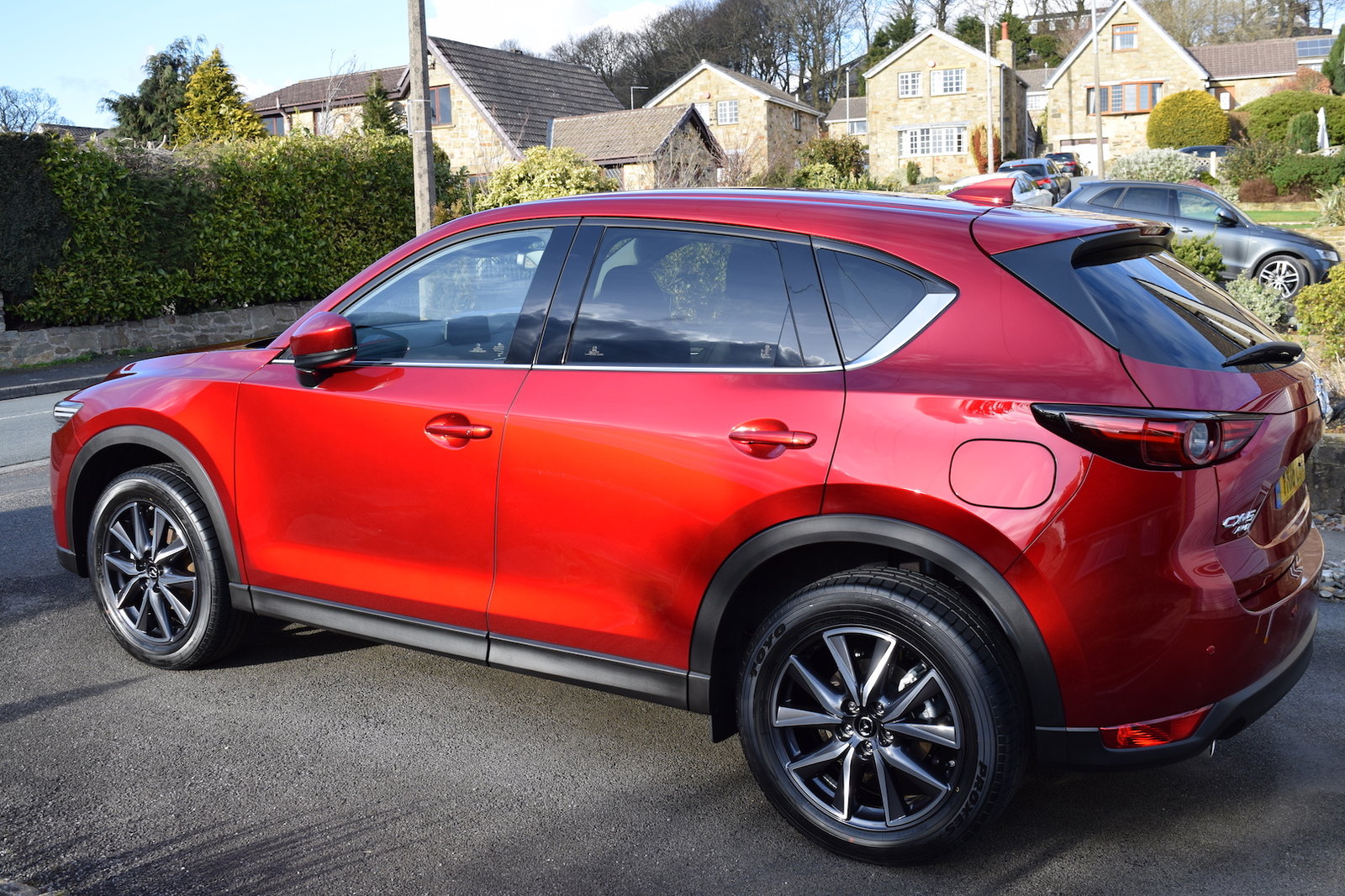

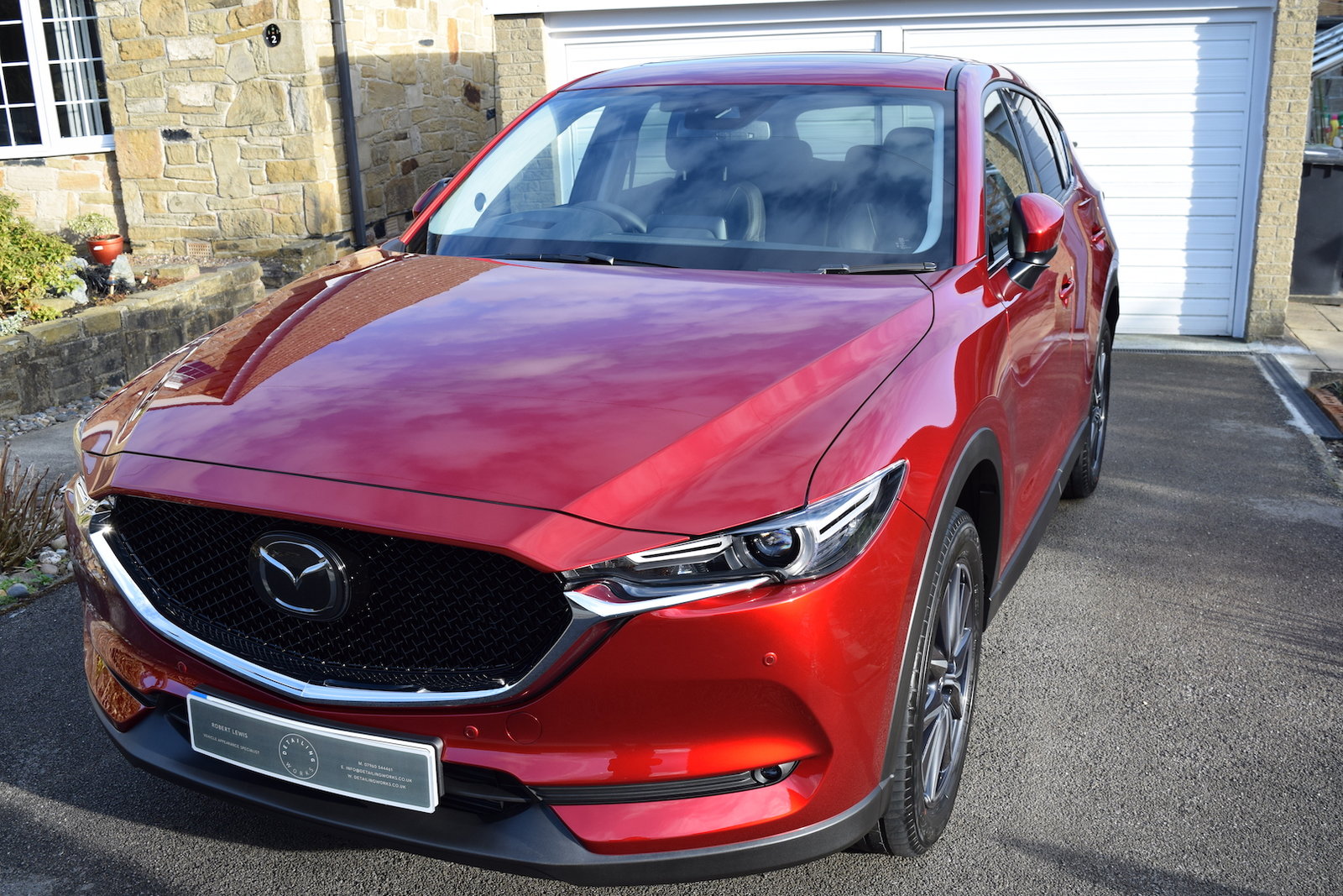

    New Car Detail - Mazda CX-5 AWD....Beautiful vehicle first one I have worked upon and I must say I was very impressed. Customer picked up vehicle yesterday ( was offered their coating at £400 and refused as per my instruction ), and booked in with me for my ' Endurance ' full new car preparation treatment. Vehicle was FULL of dealer induced paintwork defects upon inspection ....AGAIN!....and apparently not washed as instructed...BAH!!!.... Beautiful colour to work on. Pre-washed with Bilt Hamber Auto Foam prior to contact wash. Full Clinical wash ( 3 buckets dual grit guards ) Dooka wash pads and Carpro Reset Shampoo. Arches degreased and tyres with Bilt Hamber Surfex HD...full chemical decontamination ( Gtechniq W6 and Carpro Tar X ), to all paintwork including wheels. Air Dried with warm filtered air. Door Jams and all shuts cleaned from transport wax. All interior surfaces cleaned with Gtechniq TriClean ( anti-bacterial bio-cote ) and all leather treated to Gtechniq Leather Guard. Upon Measuring paint thickness....the average reading was 58-65 microns which is ridiculously thin so I was limited as to what I could achieve without compromising the clearcoat. Informed my customer whom instructed me to do the best I can with what I had. Then followed refining machine polish ( Rupes Bigfoot 15mk2 and Rupes Pads ), to reduce dealer inflicted marks as much as possible and to truly bring out the metallic flake in this colour. Machine polish was followed by 2 coats of amazing Wowo's Nanocoat ( 12 - 19 months durability ) Wheels treated to Wowo's Crystal Sealant and all glass treated to Gtechinq Liquid Crystal C2v3. All trim and tyres dressed to factory finish. End result was truly impressive leaving the paintwork like silk. Customer was very very happy indeed - and will be maintaining the vehicle himself with hints & tips on washing and products from myself.....nothing is too much trouble for a really grateful customer and a great guy to boot!...this is how your new car should look from the dealers!!!....utmost care taken as always and with industry leading products. Time required 9 hours non stop.
