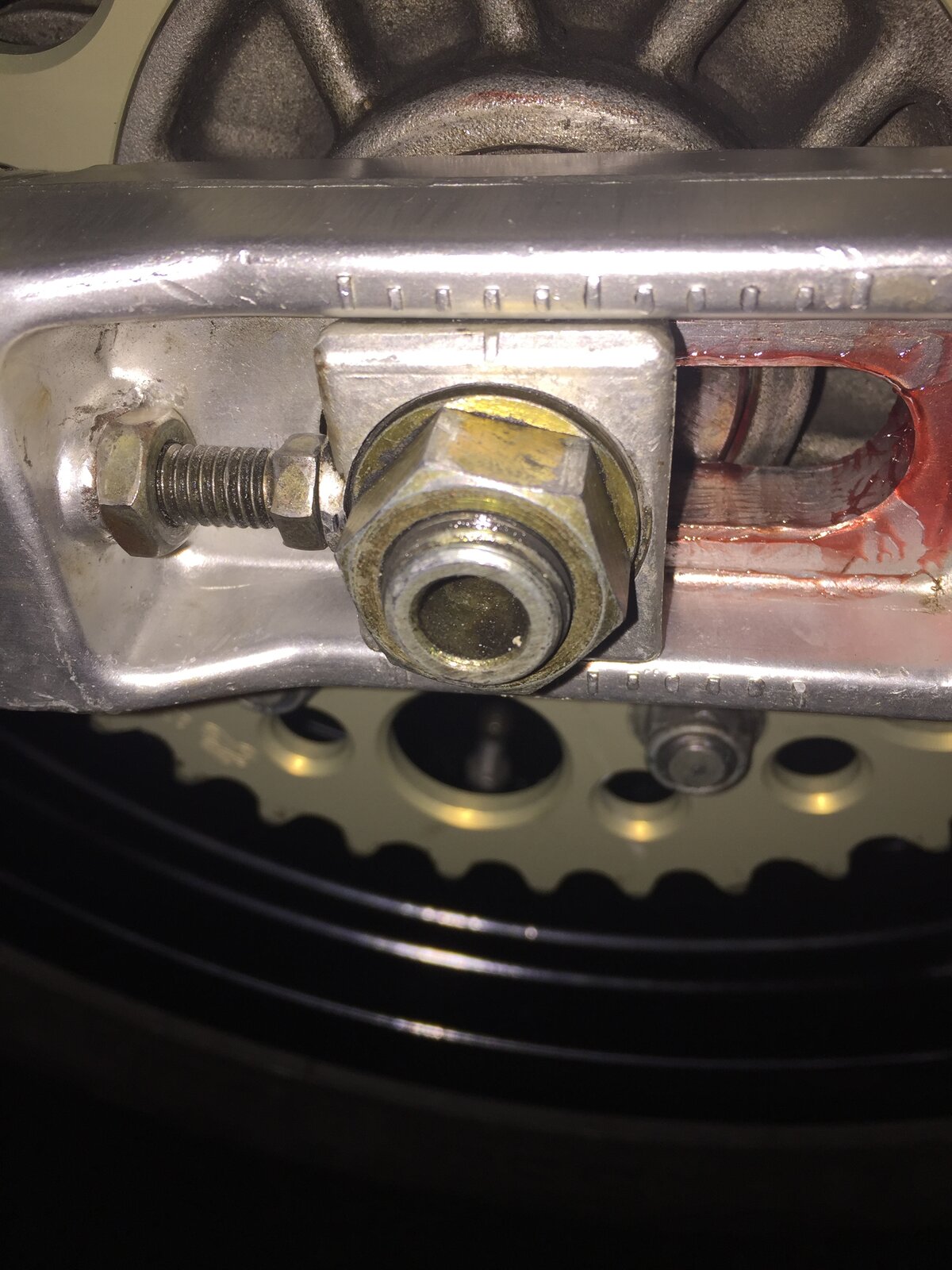

  16. I've finally got around to fitting the new sprockets. The old 96 link chain does fit with the new 15/39 sprockets, but I'm a bit worried that a new 96 link will be a fair bit 'tighter' than the old chain that's on at the moment. The old chain looks to be in OK nick, so hopefully it hasn't stretched too much.
    I adjusted the old chain roughly and took a shot of the position of the chain adjusters...'notch 4'.
    When it's got a brand new 96 link new chain fitted do you think it could be too near 'notch 1' for comfort?
    I presume having the rear wheel in this position doesn't make a great deal of difference to the handling...or is it better to have it set further back?
    What do you think...am I just better going for a longer chain?
    Thanks... :)
  17. Imo you are better having the chain nearer the front, as itll stretch so you will have max adjustment. Does a few mm make that much difference to handling?
  18. What is it they say. Short wheelbase tight turn in handling, twitchy bike. 3 links is a lot to ask from a standard chain length. Just saying.
  19. Looks perfect to me.....
