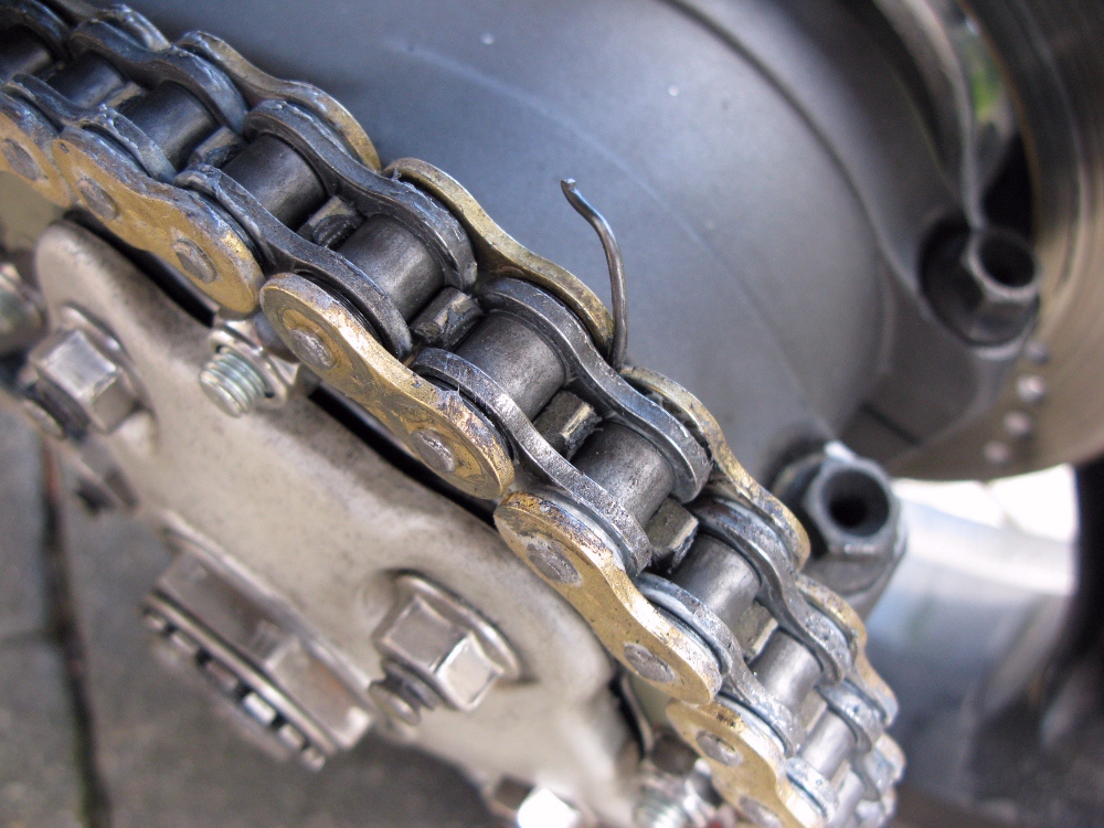

  1. Some advice please....had new chain and sprockets fitted to my bike last week, at a certain dealer. Afterwards I rode onwards to work and then home - a 30 mile round trip. I assumed the job had been done properly but I was just getting ready to go out again this afternoon and saw this:
    Half of the spring used to keep the plates spaced correctly during fitting is still on the chain, except it's sticking out. The O-ring on the adjacent link (not the joining link) is missing, likes it's been caught and flicked off by the wire. The wire has also scored the side of my alternator cover slightly, where it gets v.close to the front sprocket. Jesus, this is why I prefer to do my own servicing. Only this time I thought I'd leave it to the, er, experts.
    I don't want the chain left with a missing O-ring, and I don't want a second link fitted to get a new one on. Can I expect a new chain from the dealer?

  2. Take it back to the dealer with the picture. They'll have to put on a new chain if any of the links are damaged other than the rivet link.
    To me that bit of wire isn't from the chain, strange.

    Jamie, the wire is half of one of the 'w' springs that comes with a new chain. Stops the plates being squeezed together too tightly. They should be pulled off after rivetting.

  7. I wouldn't be riding it with that sticking out, it's going to catch on something which won't end well...
  8. Has the mechanic used the wire to hold the links togehter whilst the chain has been pulled through?

  9. Very strange - looking at the photo, none of those links looks like a join, although I'm used to DID ones where the join is obvious (and no w-shaped pieces of wire involved if you use the right tool).
    It's critical to get this checked because very bad things can happen if a link should break.

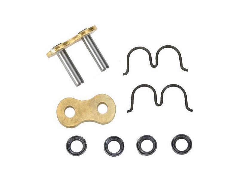

  10. The link is the one near the centre of the photo. It's not obvious as it's a Renthal solid pin, so it's been staked like the rest. The wire is half of one of the w things in this pic: image.jpg

  14. Hi, thanks for the pic, fitted so many chains over the years but never seen the 'w' you mentioned. different, but I can see the logic for easy fitting without over clamping.
