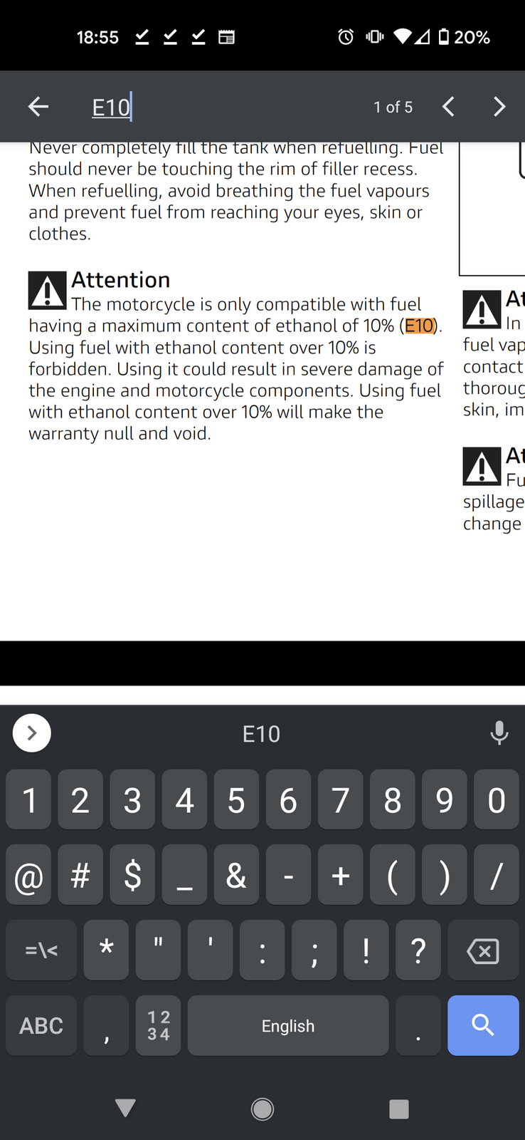

  1. Hi,
    Do all recent Ducatis run on this?
    I'm stuck abroad just now and don't know if my 2019 Supersport will run on it as the Gov Website doesn't list it. . .
    All help appreciated!
  2. So I realised on my V2 I had a sticker on the tank saying what fuel it was compatible with. Pretty sure E10 was listed. Shame I don't have a pic to hand.
  4. It’s compatible. Don’t worry!
  5. Thanks!!!
  6. It will be fine. The Supersport has a sticker on the tank next to the filler cap that says "E0 E5 E10"
