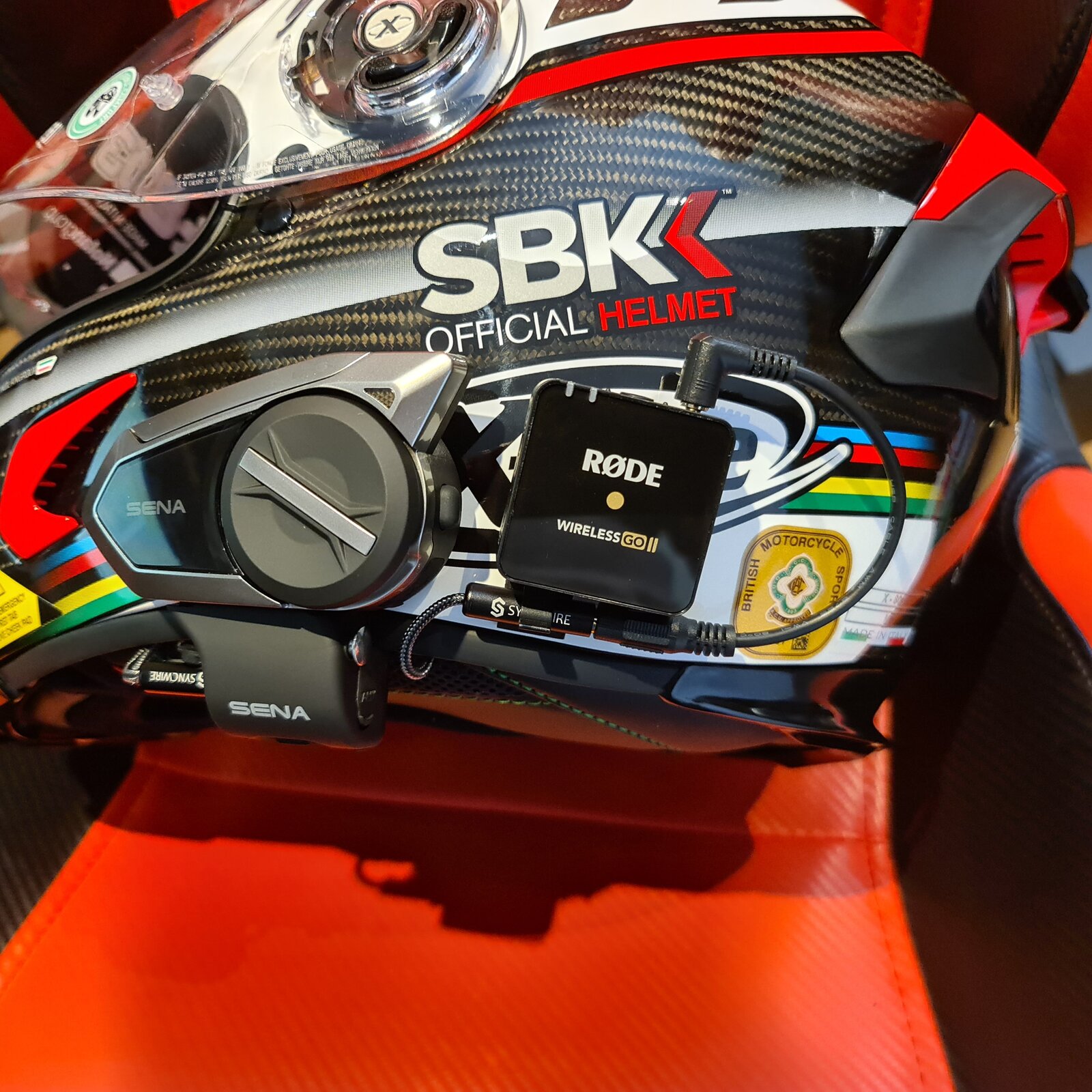

  1. Been trying out some different configurations for my new helmet. Namely audio-out capture from my Sena 50S using a radio mic and a second separate radio mic to handle speech when the Sena mic is cold (no live intercom). The radio mics have onboard audio recording as a back up, in case you lose connectivity to the wireless receiver which has an audio out feed directly into an action camera, be that helmet or bike mounted, so there are no awkward wires between TX and Rx units. Currently getting to grips with my Insta360 and my two GoPro's, so hopefully will get some good footage once the warmer weather arrives next year. Having an audio feed directly into the camera, means there are no issues syncing sound with video footage and you can control each of the two mic tracks independently, if needed, in post.

  4. Let me see if I understand this correctly. You’ve the Sena and it’s mic and it’s headphones, you’ve then attached the Rode to your helmet with a separate wireless mic. The output from the Rode wireless unit is then fed to your GoPro in order the audio captured on the GoPro is your commentary and not the road/engine noise (although a little of that will be picked up by the mic in the helmet as well but at least most if not all wind noise will be taken out of the sound), if so, what are the two Syncwires?
    On a related subject does the Inst360 record sound a well s as audio or just audio? I’m interested in one of those.
    Presently I have 2 mics in my helmet, the Cardo comms one and a small Rode lavallière mic that’s wired into my chin mounted GoPro. I’m always interested on others video/audio recording setups.
  5. The two sync wires you see are either end of a splitter cable that goes into the audio out from the Sena. Since plugging a cable into this port disables the internal speakers, I have another set of internal speakers that plug into one end of the Y splitter. The other side of the splitter goes to the wireless mic. That feeds the receiver on the go pro or my insta360. Because the mic from the Sena is only active when you are having an intercom conversation, I use the second wirelss Tx, inside the helmet to pick up my voice if I'm riding on my own or not in an intercom conversation. Obviously the first wireless mic pics up audio from any other rider in the intercom group, be that Bluetooth or mesh. If I'm not using the Sena I just use the one internal wireless mic to transmit to the receiver on whichever camera I want and the second mounted on the bike to pick up engine noise, ambient sounds etc. As for the Insta360, it does record audio but you are better off using their mic adaptor and the Rode receiver. You will also need the special Ulanzi bracket to hide the receiver within the stitch line of the two lenses so it doesn't show up in post. Hope this helps.

    Never been a fan of Helmet clutter, especially on a sports bikeo_O
